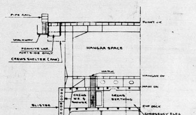

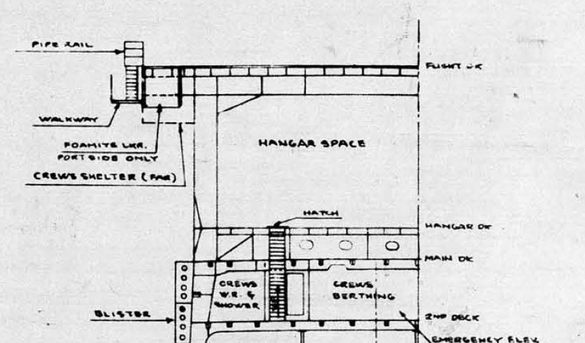

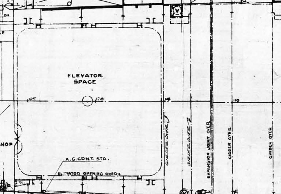

For what it's worth, the Navy called these "transverse girders" and they were the top of a structure built to support the flight deck and sides of the hangar. You can see them on the Booklet of General Plans, both as the "girder over" on the Gallery Deck level sheet:
But also as the dashed lines on the flight deck sheet
These vertical and horizontal girders protruded into the hangar space and the areas in between were often filled with storage or equipment such as fueling stations, foamite (fire fighting) stations, etc.
Just information for those interested in super-detailing a space few will see!

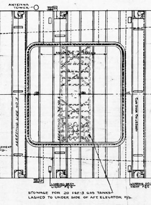

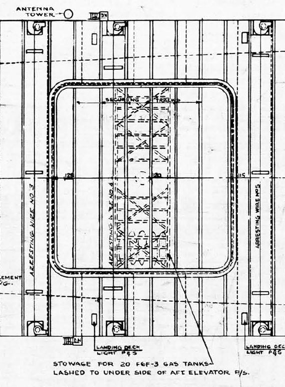

Thanks for the info, Tracy! I see now that the elevators are charged with drop tanks on the underside. Is that only the case in the aft elevator? The underside of the front one will show, but for the moment it's flat. This should be hollow, but if it holds these drop tanks, that would be hidden for a bit.

Drop tank storage evolved over time and the set I posted those snips from (available here about a third to hald the way down) is from 1950 and I'm not sure how applicable it would be to 1944. The hangar bays of US carriers evolved as much as the outside did, but there are far fewer photos and I have almost nothing on the CVLs, not for lack of trying.StevenVD wrote:Thanks for the info, Tracy! I see now that the elevators are charged with drop tanks on the underside. Is that only the case in the aft elevator?
Despite his obvious bias against US carriers, I agree that it's a good site.StevenVD wrote:http://www.armouredcarriers.com/. This is a fantastic site for any carrier enthusiast, combining well written action reports with analysis of the armour used and a lot of pictures in a bloggy style.

Notice at the extreme right a ventilation grate being covered partly by a walkway, this may be a tiny design error in the walkway layout.

You can install the hoist mechanism of one elevator with the WEM photo-etch.
