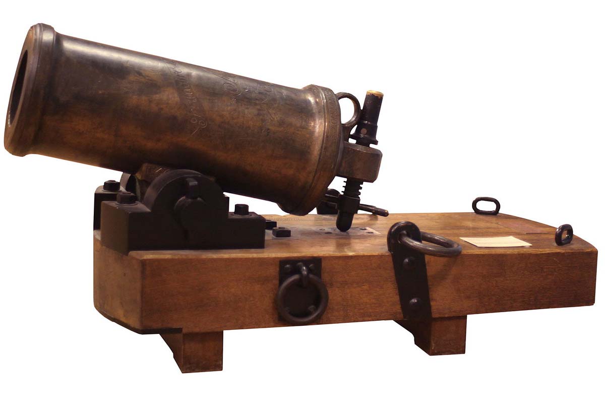

Imho this is a english model. The french obusier as far as I remember look much more like this
https://en.wikipedia.org/wiki/Obusier_de_vaisseau
"Obusier de vaisseau
Obusier de 36, mod�le 1787, found on the wreck of the Golymin. On display at the Mus�e national de la Marine
In service 1787�1805
Used by France
Production history
Produced 1787
Specifications
Barrel length 85 cm
Crew 5
Calibre 36-pounder
The Obusier de vaisseau was a large calibre but light piece of naval artillery mounted on French warships of the Age of Sail. Designed to fire explosive shells at a low velocity, they were an answer to the carronade in the close combat and anti-personnel role. However, their intended ammunition proved too dangerous for the crew, and the French navy phased them out at the beginning of the Empire in favour of the carronade.
Accounts by British warships of the armament of captured French ships tend to describe them as carronades. However, when the description includes the remark that the weapon was brass, this suggests that it was an obusier.
Several of the guns were recovered from the wreck of the Golymin in the road of Brest, and are now on display at the Mus�e national de la Marine in Paris and in Brest.[1]"
Also the obusiers found at Aboukir after the explosion of the L�Ocean look like this.
http://www.franckgoddio.org/projects/ot ... fleet.html (picture 2)
Perhaps to ask Gerard Delacroix of the french Arsenal forum.

But the forum-post I found that drawing on states this:
A little more detail, in case one finds Mr. Brechtel's response above too summary.
In 1786, the French Navy adopted the "obusier de vaisseau". Based on the Gribeauval 6-inch land howitzer (169 mm calibre), and intended to be made in various sizes, actually only 36-pounders were made. These were in bronze, and intended to fire cannister and shell, just like the land pieces. The 36-pounder barrel was 84.3 cm long and weighed 350 kg.
The French found the shell rounds difficult and dangerous to use at sea, and began to load the pieces with plain ball rounds instead, leading to the use of the term "caronade obusier". Ill-suited to firing the ball round, the pieces were replaced from 1804 by true caronades.
These French caronades of the An XIII were cast in iron, first 36 pounders and then later (1810) also 24-pounders. The 36-pounders were still 169 mm caibre, but longer (182.1 cm) and much heavier (1223 kg). They were essentailly copies of British designs.
So it seems they used real carronades, after 1804, and that drawing is supposed to be the French 36pdr.
The breech seems to be much rounder in appearance than the british design. Like this:
Also, Lucas french language report uses the word 'caronade' and not obusier.
But I think the same confusion between obusiers and carronades might make the wiki statements on Redoutables' armament unreliable... :smallsmile:

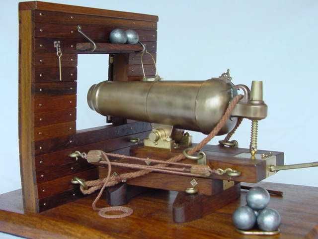

"Obusier" means "howitzer", it was a French/Spanish weapon of around the same size as the carronade and filling much the same niche as a light-gun replacement on the large warshps. It was a thin-walled, short, almost cylindrical weapon originally designed for firing explosive shells. It has roots back in the very beginning of the 18th Century, at least. Basically the French/Spanish met the carronade in battle, were much impressed, and found something roughly similar that they already had in production and tried that. It turned out the be far less effective than the carronade proper and was gradually replaced by them.
As for where a carronade or a howitzer would be mounted, well, here it gets a bit complicated. Let us start with the term "74-gun ship". Until the American Revolution, it meant just what it said on the box, a ship with 74 guns, full stop. By the time of Trafalgar, it rather meant a ship of the basic type that was once meant for 74 guns but which might carry anything from about 74ish to eightysomething guns, some of which would be carronades. Or howitzers.
Basically, the carronade replaced the not very powerful light guns, the six- or eight-pounders on the weather decks. It weighed about the same but threw a much larger ball using a smaller crew. It was also much shorter. This turned out to be a critical point. In way of the shrouds this was a Bad Thing, the muzzle flame from the carronade could set fire to the ship's own rigging. The solution was to keep the long guns in those positions, and only replace them in positions free of the shrouds. Depending on the exact layout of the gunports this mean that in actual fact about half the light long guns were kept, the rest being replaced on a one-for-one basis with carronades.
Because of the limited weight and compact size of the carronade it turned out to be possible to stuff a few of them on to the ship in positions that did not carry long guns, such as a pair or two on top of the poop deck/dunette, or a pair just aft of the catheads as on the Victory. These were "surplus to rating" so to speak and could turn a 74-gun ship into an 80-gun ship without it really being counted. If and how these extra carronades were mounted was largely up to the whim of captain/dockyard, depending on what was available, how much stability the ship had, and how badly the firepower was felt to be needed. It was never really standardized.
