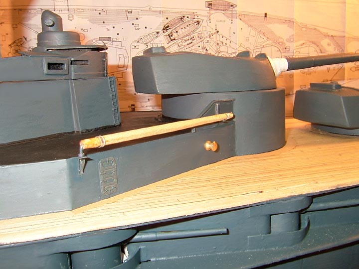

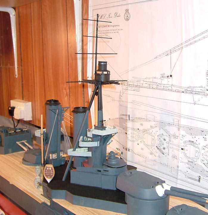

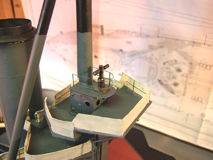

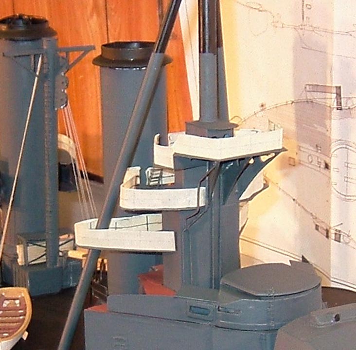

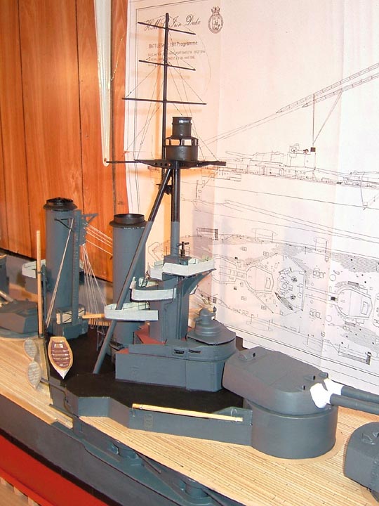

Posted: Tue Nov 15, 2005 5:47 pm
by ARH
Hi Guys, I am continuing with the handrails,
The handrails above the lookout post were fitted, these are to have canvas dodgers attached, on this level there are 2 double searchlights to be fitted.
The handrails on the second deck down on the fighting top were drilled and fitted.
Rear view.
I started putting in the pipe work on the main bridge, this is aluminium tube.
A close up with one extra pipe, this is copper tube smaller than the others.
enjoy, ARH :wave_1: :wave_1: :thumbs_up_1:

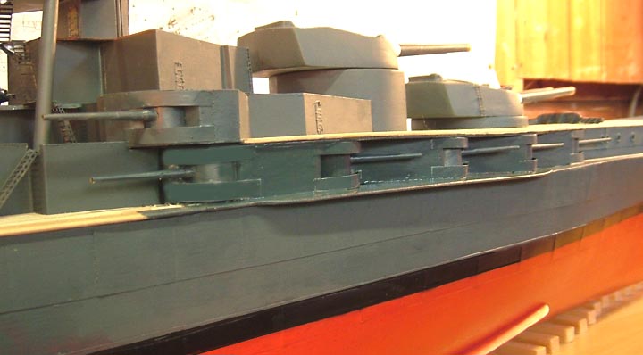

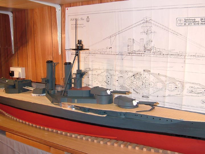

Hi Guys, I am going to show you how I fit my casement guns.
This is an overall shot of the ship, but you can see where the casement guns are to be fitted, 7 in all on this side, one at the stern, but that will be later.
The barrels were made by Steve Nuttal and are fitted in to some round plastic piping.
In the picture on the second gun, you can see a white piece of plastic, this is cut around the piping top and bottom, and glued in place, this allows the gun to move round and not be static.
The first gun casement has been fitted out, and covered in litho plate,
In this picture you can see the section between the guns, its a block of balsa wood shaped and glued in position.
Next it is covered with litho plate.
Plastic fitted for the next one, the first one has its first coat of paint.

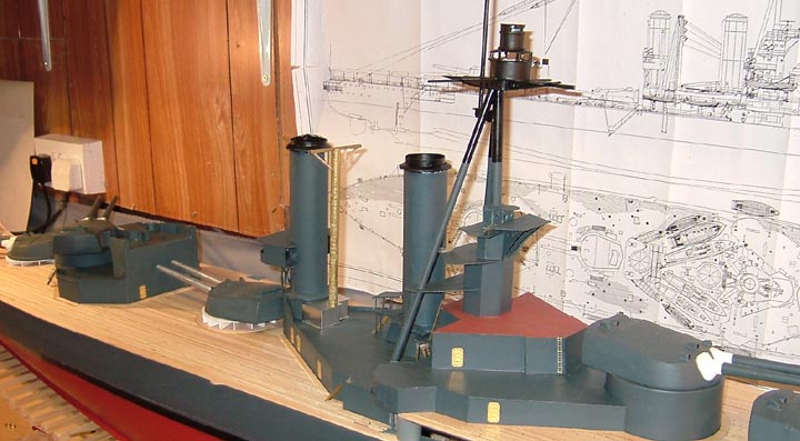

This is an overall shot of the work so far.
A bit of a close up looking from the stern, the 4th gun is fitted out with litho plate.
3 finished and painted,
Looking from the stern.
Posted: Fri Nov 18, 2005 5:14 pm
by ARH
Hi Guys, Just a few pictures of the finish of the casement guns.
All guns fitted, 5 below and 1 on the next deck, just the blast bags to fit and the curtains.
A close up of all the work, if you look at the very 1st picture on page 1, you can see what I mean by the curtains.
From the opposite angle, the reddish glow on the model is from my fire, its very cold here at the moment.

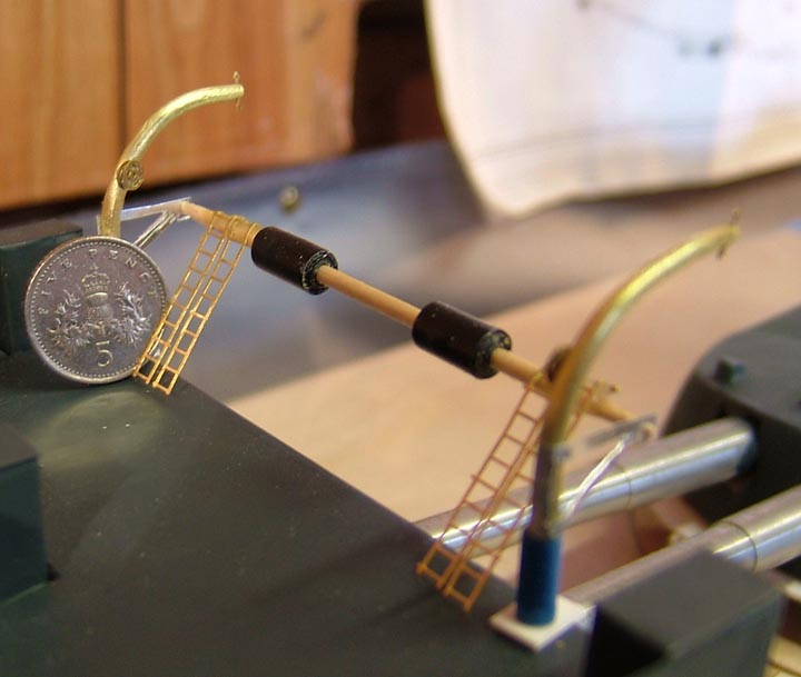

Hi Guys, its davits to night on the stern superstructure.
The davits are made out of solid brass rod, filled to shape and bent. At the top end a slot was cut and a double ended ring was glued in. At the bottom 2 pieces of plastic rod was fitted and a foot in plastic fitted to each one.
Drilled and placed in position.
Cleats were drilled and fit either side. Also the timber brace and black landing protection, the metal treads when painted should look like a rope ladder.
Just to give you some idea of the size, one of our 5 pence coins, something the size of your dimes, note the little wheels, we are getting small.
A ladder fitted to go to the next level.
Just to show what hangs there, I have borrowed a boat from another model, it's just a little large but serves the purpose. When rigged it will be higher.

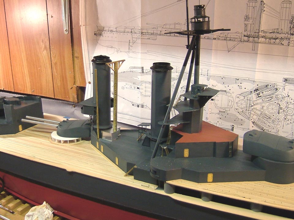

Just a few photo's tonight.

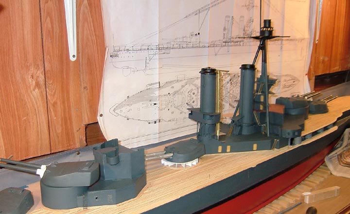

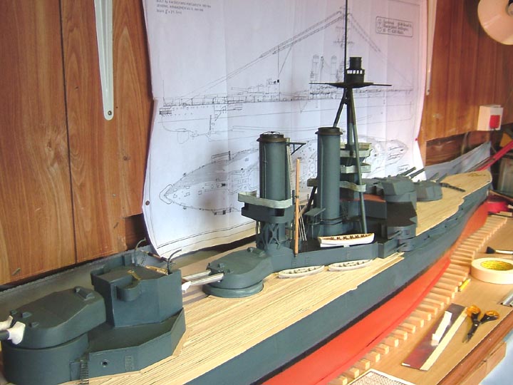

I have been looking at the decks, on some RN ships steel decks were scrubbed, polished and oiled, giving a black look, so 2 decks have had that treatment,
I think it gives a better look to the ship. In this picture the superstructure now stands out from the deck, instead of all looking the same.
I have just placed 3 ships boats in position, the lower 2 are whalers, the one on the main deck is only there to give you an idea of the size of the boat that will fit there, the Admirals Barge.
On the drawings at the back you can see the layout of all the ships boats, there's a lot of them. :lol_3: :thumbs_up_1:

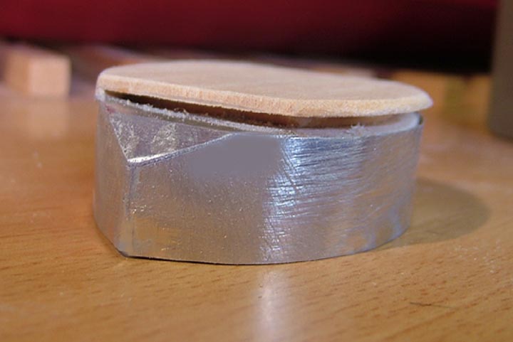

Posted: Mon Nov 28, 2005 6:03 pm
by ARH

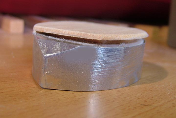

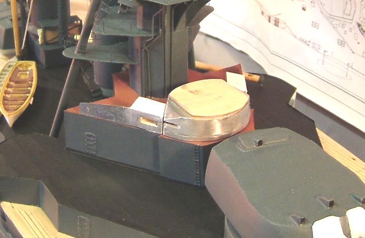

Hi Guys, After a long study of the drawings I've worked out how the battle bridge should look. :jump_1: :jump_1:
I cut the base, middle section and top out, the last two were made of Lime.
I glued all sections together.
The bottom section I've covered in litho plate.
Placed in position, also a low look out position was cut on both sides.

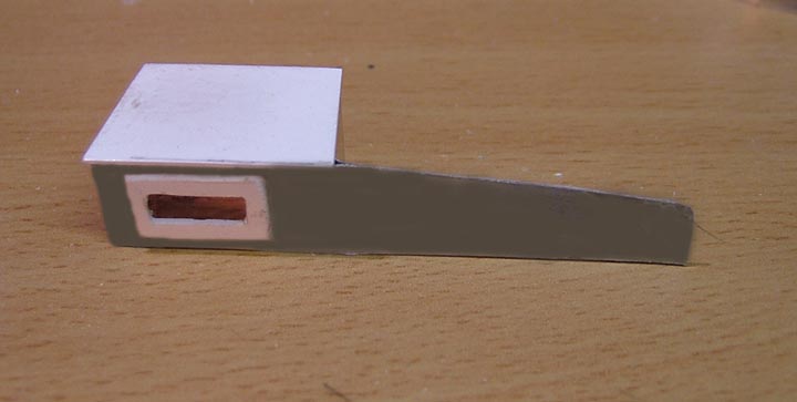

Next I made one of the wing sections, this included a small look out post.
Placed in position.
I then made the opposite side and placed in position, all the angles were different, one left one right.
Glued together and painted, also a small ladder fitted.
View from the rear.
An overall shot of the work, still only placed in position, still some pieces to add.

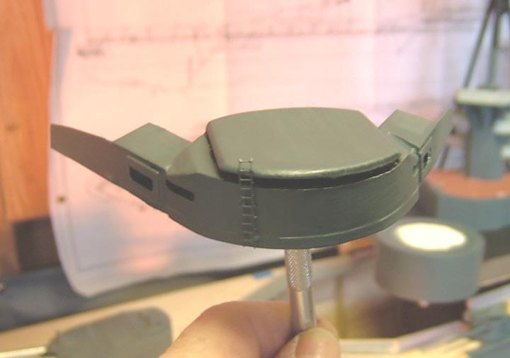

This is how I paint some of my fittings, this is the battle bridge on the end of my scalpel blade.

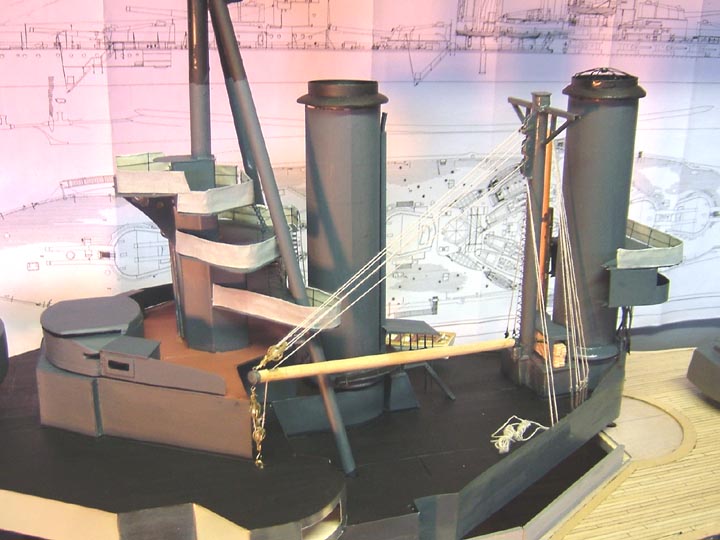

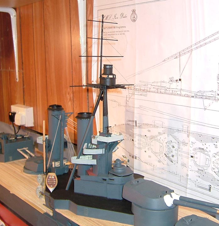

Hi Guys, I am rigging the large boat boom tonight.
First I had to make more pulleys, this time only single ones. The Samson post had to have a fitting made to fit around the top pulley, this is the starting point of the rig.
Seen from mid ships.
Viewed from bow section.
This gives a clearer view with the superstructure lifted off and turned around.
As you can see there are 2 separate lines, one controls the lifting of the boom, the other the lifting of the working end, the hook.
The ropes on the deck will be attached to pulleys and capstans later, when made.

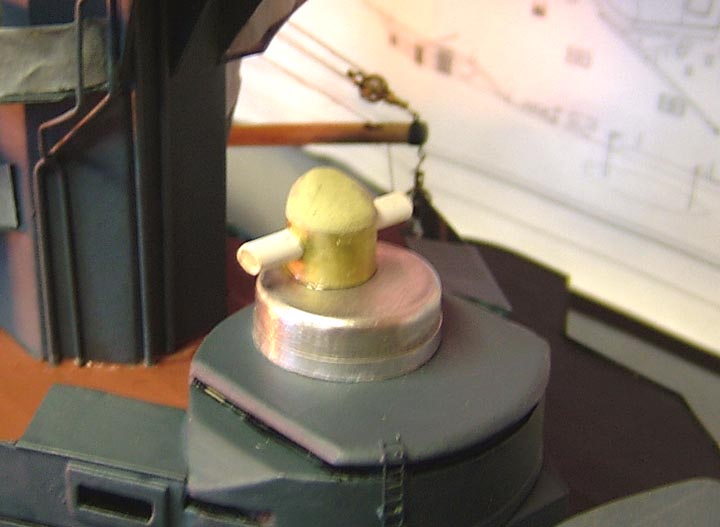

Hi Guys, I have been doing the sights on the battle bridge, handrails and range finders.
The very bottom part is the bottom cut from a WEM tin of paint, with a rim of litho plate super glued to it. On top a brass tube drilled though and a piece of round plastic flattened slightly and pushed through.
Next some Milliput mixed together and shaped into a dome, also the end of the sights filled in.
Painted and fit in place.

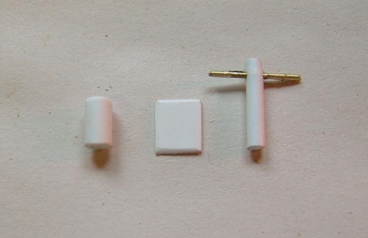

Three sections of plastic cut to shape and a piece of brass fitted though one section.

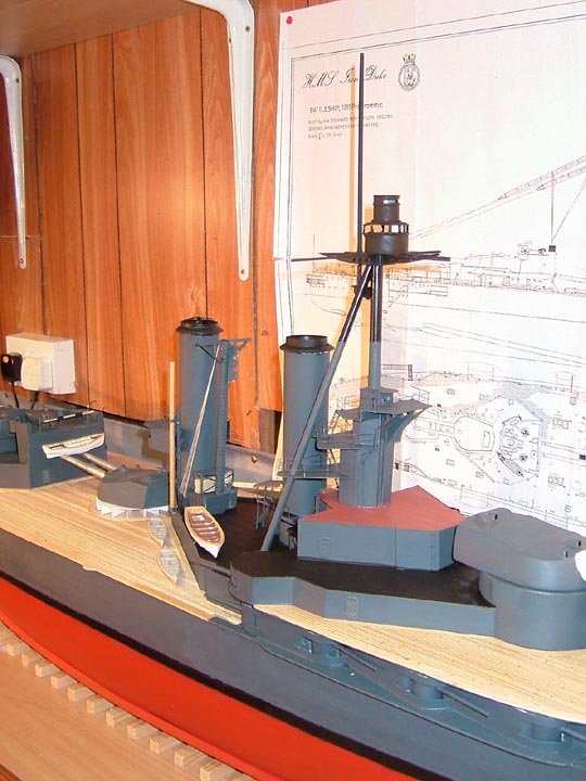

Two Overall shots of work completed.

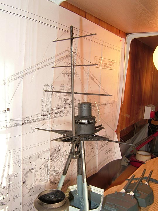

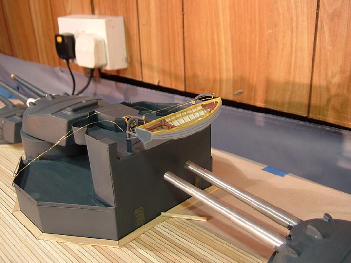

Hi Guys, A little rigging and boat slinging.
The cross trees are made from brass rod, filed to shape. The mast is brass rod and is drilled in three places.
My rigging is a thin braided cord slightly metallic in gold, painted matt black.
I have rigged the boat to the davits, you can see the cord better in this picture.
Everything tide down, the boat has only been coloured in on these photos, I painted them today. Blue outside, white and tan inside.
Bow shot.
Stern shot.
