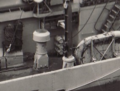

Great!!! Now for the water breaks. Who knows what these are?

I'm assuming that they are the 1-2 feet high bulkheads that help slant the water away from the center of the ship - you can see them (if I'm thinking of the right things) on battleships a lot, especially on the forward deck.

No, These definately aren't the same as the "breakwater," as located on the foredeck of the Iowa class battleships. The plans indicate several small cylindrical devices stowed against the superstructure on the main deck just aft of the break in the deck. I have not seen these referred to in other destroyers, i.e.Fletcher Plans Book.Thanks, Walt

Water Breakers, at least on Navy aircraft in the '70's and '80's, were basically any container storing quantities of drinking water. I don't know the exact size limitations, but they were usually not "single serving" containers. Perhaps that is what you are looking at here.

I don't know what they are, but are these the cylinder "things" referred to in the drawing? See attached image from a photo of Livermore (DD-429) ... the six(?) cylinders stacked three high on the bulkhead dead center of this image. When I first read your question, I thought that maybe they just put the note in the wrong location and were referring to the bulwark (I always thought was called a breakwater?) at the deck edge on the main deck to deflect water coming over the main deck. Then I read Dick's response and I'm not certain.

Rick, I think that is exactly what the plans are showing. Thanks so much for your help.

Just conjecture based upon 20 years of shipboard experience, but the object shown looks like retrofitted ventilation. The square base is the ducting, the cylinder the fan and motor and the square top the intake designed to prevent water from being sucked in during heavy seas. The term breakwater might refer to that mushroom cap. The housing sits above an propulsion space. I bet the designed ventilation was inadequate and this upgrade provided to help cool the space.

You could be right, but I'm not sure if this is the "original" style for this ventilator or one of several styles tried. It wouldn't be the first time different configurations are used on different ships.
I'm posting a couple of close-up images of the same area on a couple of Benson's images for 1) Meade (DD-602) on 7 September 1944 and 2) Caldwell (DD-605) on 3 march 1945. A different style of Mushroom ventilator is installed and a defector installed to protect it and I suspect crew members using the ladder in rough weather. :-} Deflectors of this general style were used on several Benson-Gleaves all along the superstructure on the main deck, most times with a roof over it.

Those deflectors were often used to protect the access hatches for the engineering spaces. That is why you don't usually see them on Sumners and Gearings - they had the engineering space access inside the superstructure.
