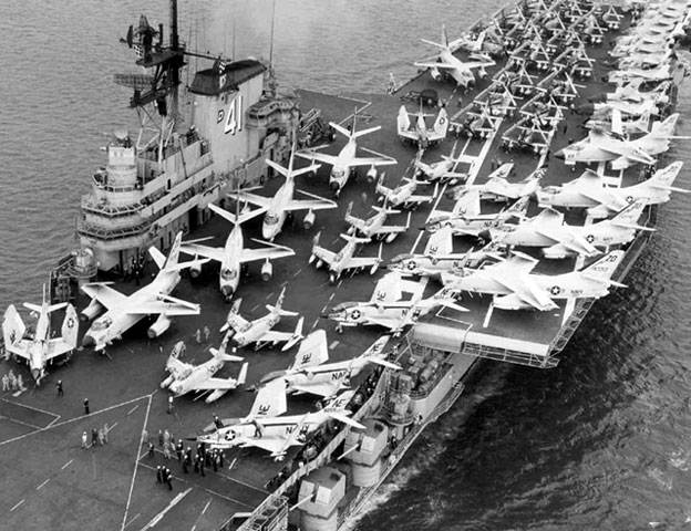

Russ2146 wrote:Like this??
That's one of those photos that looks like it's a graded scheme, but you actually can't tell anything in that regard because the hull rounds down right at the edge of the hangar deck and casts a shadow (unlike Essexes, where there is a decent expanse of vertical slab-sides all the way up to the flight deck). Note how the same dark tone goes all the way up the forecastle where the hull is continuous up past hangar level. On the photo I posted the link to, the demarcation between lower and upper hull color can be seen along the bow, where there is no deck edge, hull knuckle, or overhang of the correct contour to cause a line of such uniform height above the waterline.
As for Coral Sea in 1952, I don't think the USN was using any graded schemes that late; though as always, the right photo could prove this wrong. :)

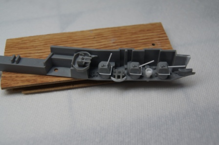

This may be ordering on insanity, but I've decided to build the old 1954 Revell offering for the 3rd time in my life. I did it once as a child in the 1960's, again in college in the 1970's, and now I'm finally doing a back dating of the kit to 1950 when my father was assigned to the MarDet during cruises in the Med.
Several reworks include:
Waterlined the kit - done
I reworked the 5" and replaced the 3"/50 with 40mm from the Missouri kit. Adding director tubs and Mk 51 directors to replace the "blobs".
It will receive extensive PE, rails and other.
It will have Bearcats! I have photos the were in dad's posession that show 2 squadrons of F8F-1B Bearcats on Midway. I can find no documentation in air wing assignments that 2 squadrons were ever assigned, but pictures aren't as subject to mistakes as text can be. Is anyone able to shed any light on this? Please speak up. I have 25 Bearcats cast and awaiting further refinement.
Question? Can anyone provide information or pictures of the "other" directors that appear on the port side at a higher level? There appear to be 3-4 to port and another to starboard just ahead of the island. Were they MK 56 by chance? Any help in this matter is greatly appreciated.
I will post more photos as the build progresses.
Dave

Revell 1/540 ..... Bordering on insanity.
Attaching the photo that was apparently too large.
Dave
Reworked 5" and replacement 40mm.  Added director tub.  Plastic rail remoced for PE.
