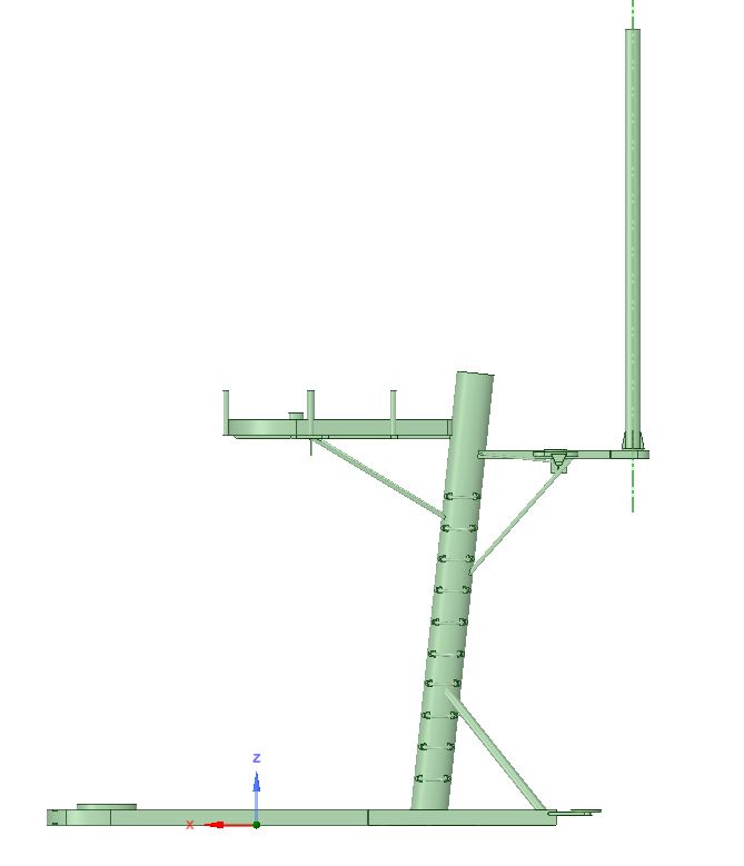

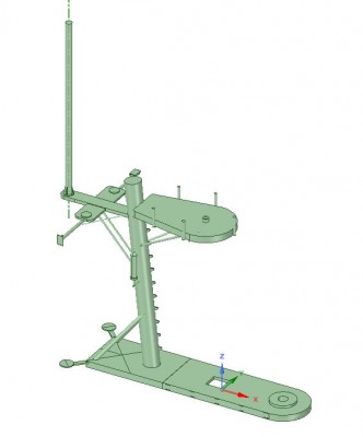

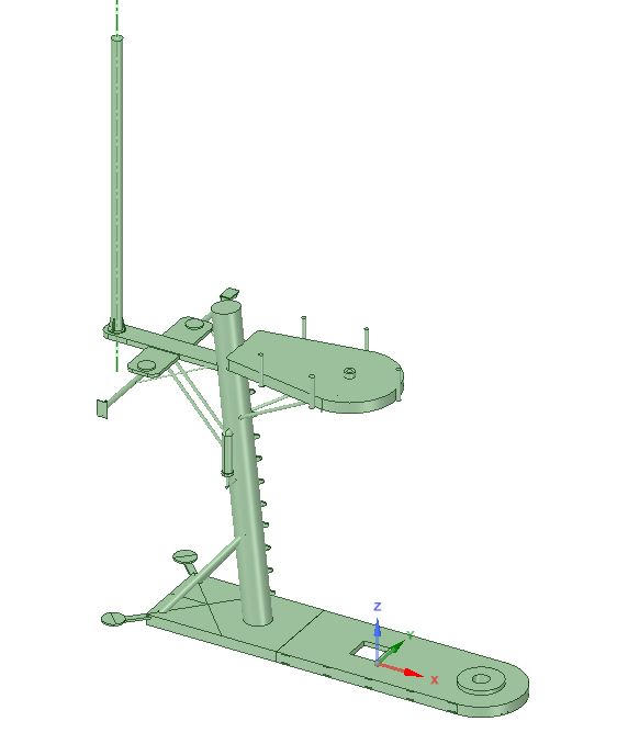

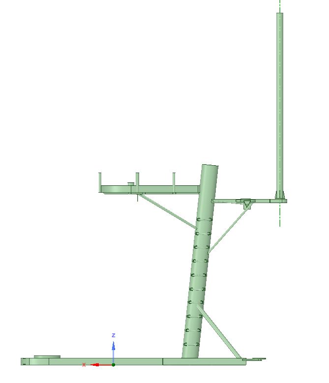

I've been doing quite a bit of 3D parts design/printing recently, as well as various modifications to the several deckhouses. Last week I started design of the RADAR platform and service platforms that make up the forward mast assembly. With Tom Falley's assistance to help with my screw-ups ( :doh_1: ) I've been able to get quite a bit done to date. I am thinking about making the entire mast assembly in two main parts - the platforms and above as one unit and the tripod legs/support braces as another separate unit. I'm also designing the various lamps, instruments, etc. as separate part files in order to print multiple items with a certain amount of leeway in scale due to resin shrinkage during printing. Anyhow, here's a design shot of the work in progress:
There is quite a bit of work to do, so this is far from complete. In addition, support struts may be modified as this is still a "work in progress"!

Though not visible from this angle there is an involved set of supporting beams on the underside of the platforms which will add a lot to the realism. Good job Hank! Looking forward to the pieces coming together.
Tom

Yes, the underside has quite a bit of detail - and thanks to your DSM know-how, I've been able to continue on that file and hopefully soon get it to a point where it can be printed.

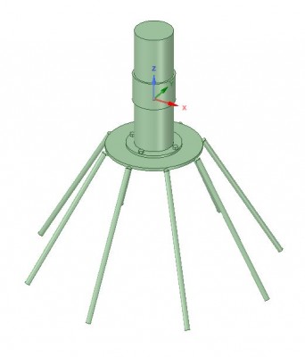

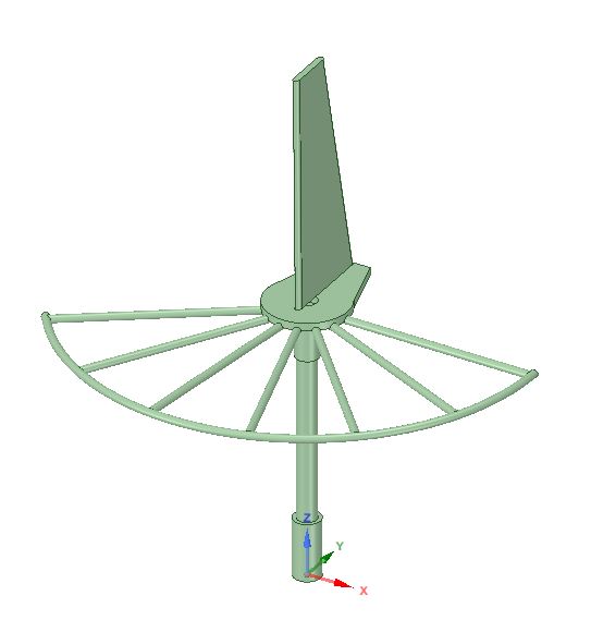

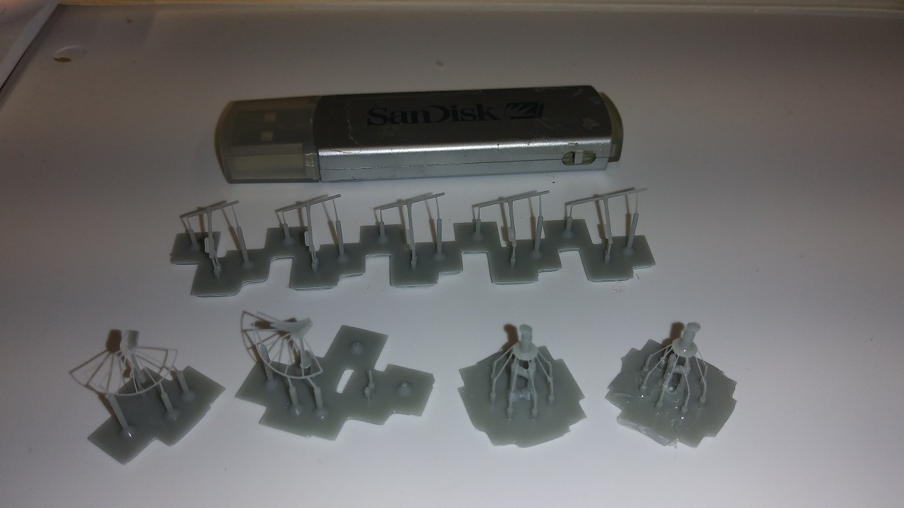

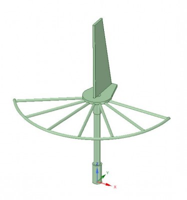

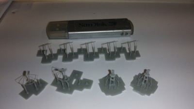

Along those lines, I've been working also on design/printing of 3D parts for the various RADARs, antennas, and support structures, etc. I could just as well make a lot of this by hand, but to tell the truth - the 3D parts are more precise, detailed, and simply look better!! So, here are some design photos of the parts I've been working on:
Quite a few others, but they are still in progress. I did print these three today and surprisingly enough, 2 of them actually came out in useable form:
As a point of reference, the flash drive is 2 3/4" long. I need to go back and do some refinement to the NT 66131 antenna as it didn't print. I was completely shocked that the AS-390 and NT 66132 DID print correctly and with such fine lines. The TDQ NT 66095 did print very well so that was a pleasant surprise, as well. I will have to double check the sizes as this is one of the factors in 3D printing - the need to slightly oversize very tiny items in order to get an acceptable part. I have drawn up most of the various ship's lights and their supports and will do so throughout the model.

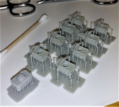

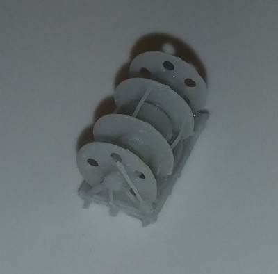

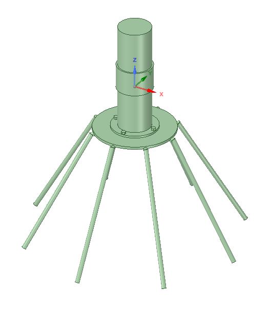

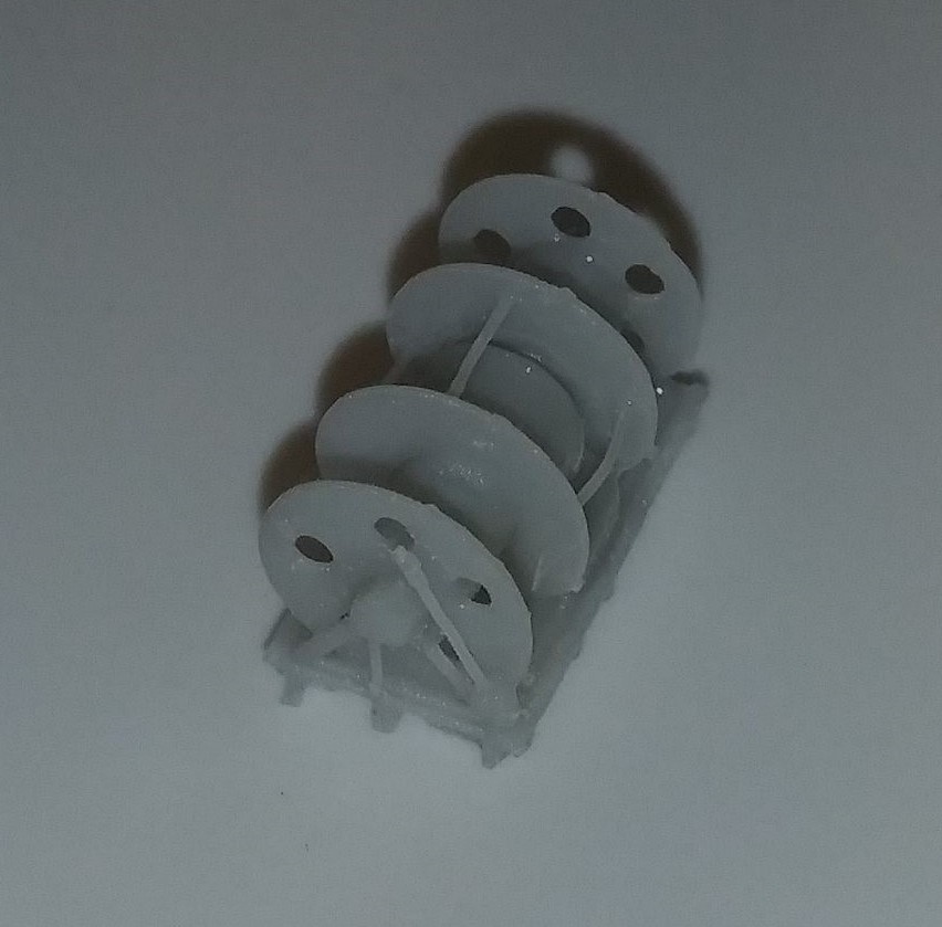

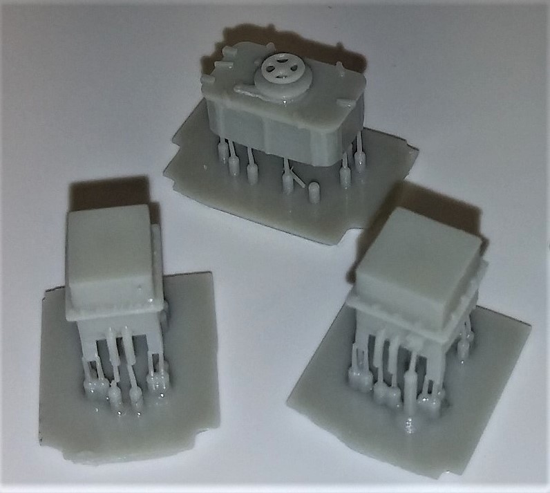

Over the last couple days I've been refining my antennas in order to get them to print correctly - this is where the scaling factor comes in. At this point, I've been able to print out everything I've designed at least twice so I've got enough on hand to move on to other items, etc. Along those lines I've been creating a couple deck pumps which I had already constructed by hand, but now have much more detailed items to use in their place. In addition, I've redone the round & oval scuttles and after hatch in order to further enhance the handwheel on the tops of each part. Here are design snips of the part prior to printing and then a photo of the printed items:

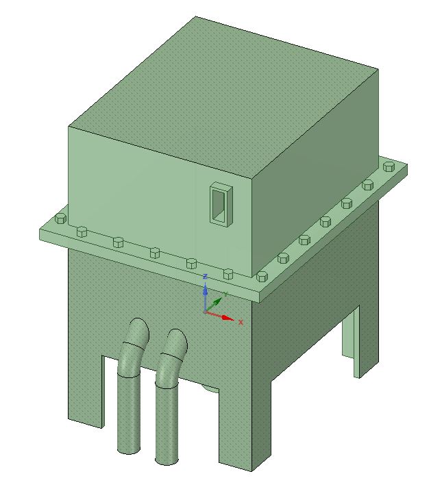

I will use the same part (After Hatch) up fwd on the focs'le after sanding the base of the hatch at an angle to match the molded kit part.
So, I am building up an inventory in a plastic parts box of all these tiny parts to be used when the time comes for them to be installed on the model. And, believe it or not - I'm actually learning something every day about this new 3D "tool" - a nice complement to the modeler's tool box.

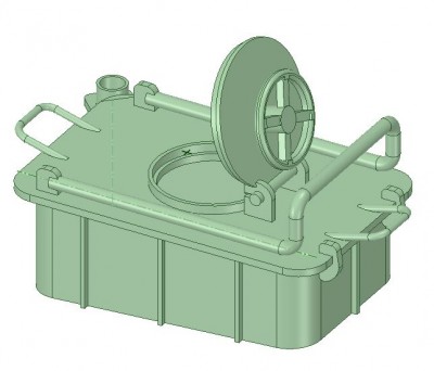

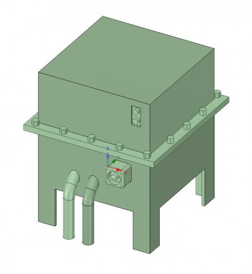

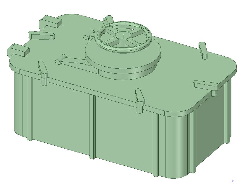

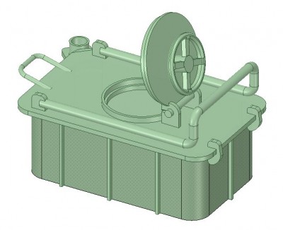

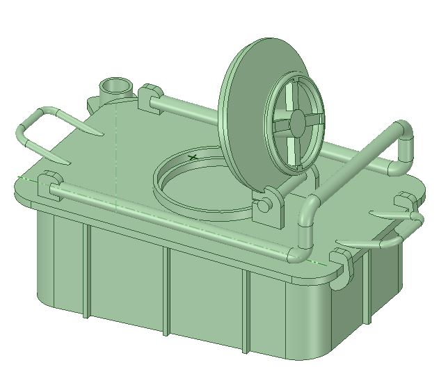

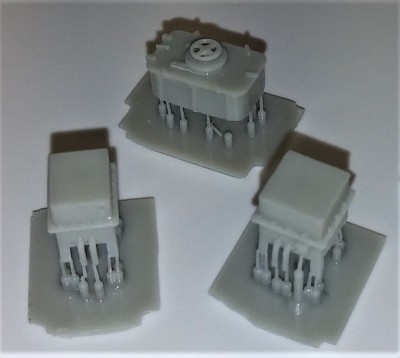

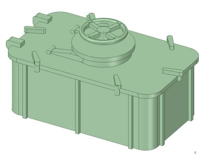

Well, this afternoon I drew up a new after hatch from the TFD Plan Book & o.h. foc'sle photo of ISHERWOOD - the result is a hatch with the corner davit pipe socket, a raised scuttle, end grab bars, and the bar brace for when the hatch cover is opened. Here is the photo of the design and then a photo of 8 of these little dudes - they did come out just about 95% and that's an accomplishment! One of the original hatch units is shown at the bottom left:

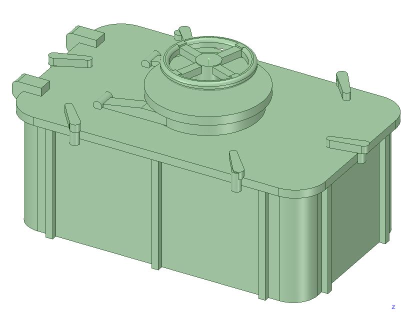

I've now also designed the forward hatch in like fashion:
After a minor design mod. I'll try printing the forward hatch(s) tomorrow.

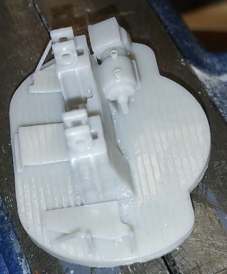

Here is the 1st edition of the basic foundation as printed today @ 1/144 scale (28mm wide):
This will go thru several versions until I have all the assoc. equipment, etc. in place. Comparing this with the styrene handmade foundations, I'm quite certain that this is the route to use as these will be much more accurate & detailed than I could make by hand. Another item mentioned above, the T-Mk. 6 Fanfare Noisemaker is now part of my parts inventory. Here it is just after printing once the supports were removed:

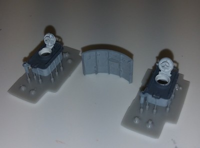

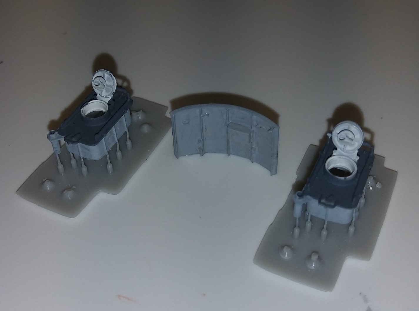

I have now printed all the parts that go with it - Shield, Fanfare Decoys, Life Rings,etc. One of the more interesting designs was the work Tom & I shared on designing the main deck fore & aft hatches. The final version has a 120� open scuttle with inside/outside handwheels - just like the real deal. This photo shows the part after a 1st coat of paint:
I'll do touch up on painting soon enough. So, these little items, generally not available on the 3rd party market, are now in my parts box - with only a small bit of cleaning up and painting to be ready for installation.

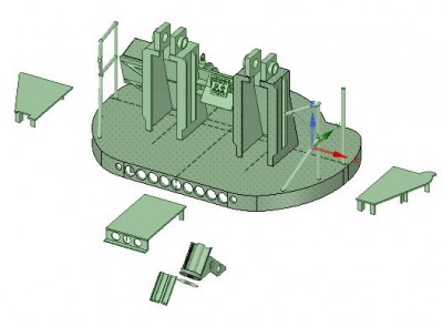

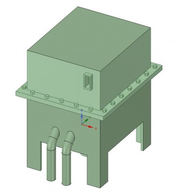

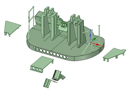

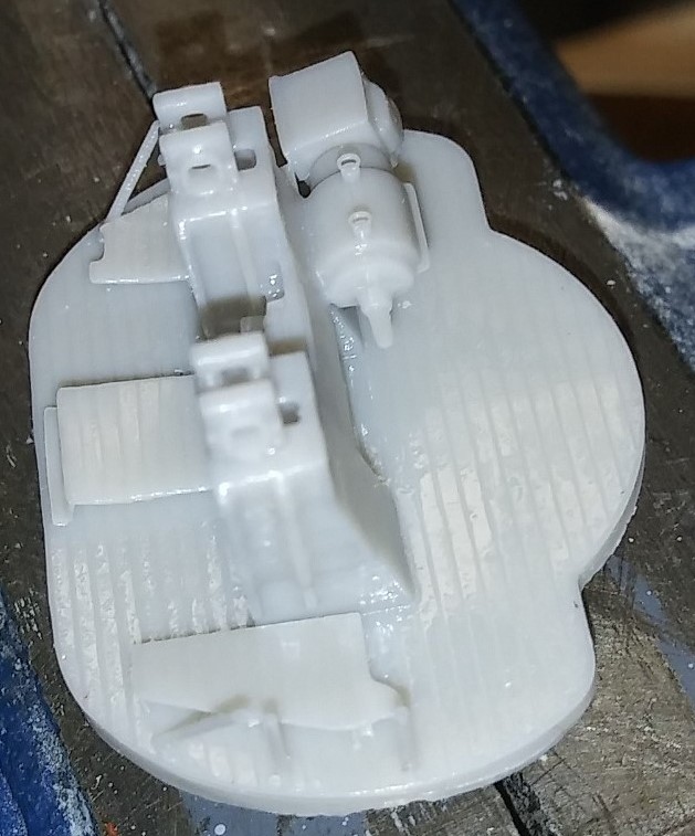

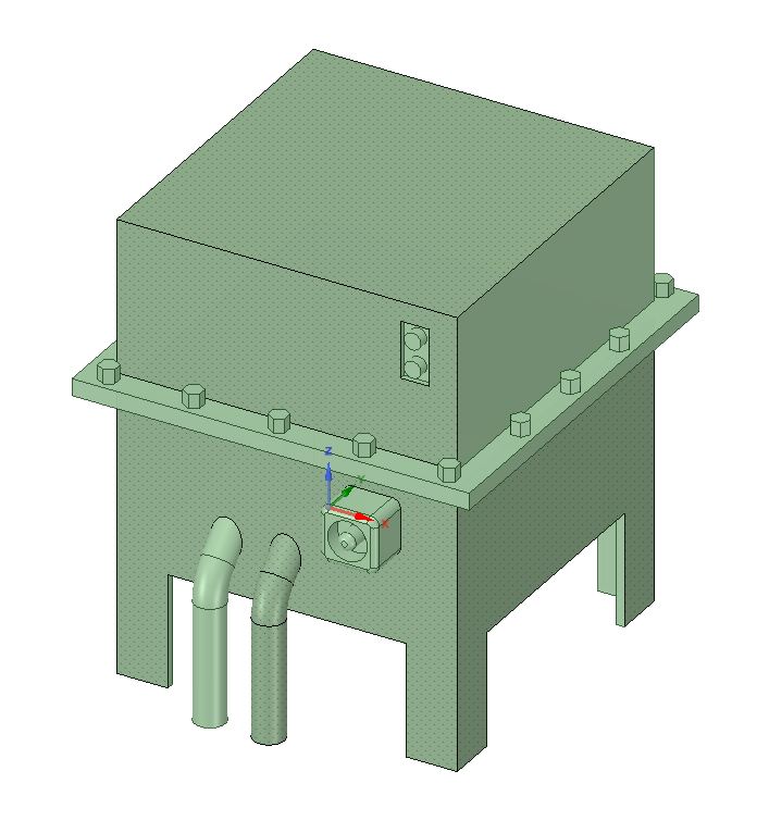

As I mentioned in my last update, I am working on creating the foundations for the 3"/50 Dual R.F. gun mounts as Willie and I will be sharing parts for various things on our respective builds. I have now made 2 editions of the foundation and it will require further work and additional equipment, but here is a 3D design photo for the part:
The three magazine platforms have been moved to a separate design file so I can print them as separate objects - these need only some minor adjustments for final printing. There is a whole slew of parts that make up this gun mount - and none of these are simple affairs. The last 2 days I have been creating some of these articles and have a few that I can share design photos:

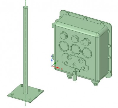

There is one of these control units on each side of the mount.
This unit is located on the right side of the mount - I will have to size this to scale once I make an initial print of it.
I don't know how long it will take to design everything needed to build this mount, but I will (and AM) having to simplify some of the items as this mount is a very complicated pieces of equipment. Perhaps that is why no one doing 3D parts has tackled it (exception being smaller scaled versions by Veteran Models). As for the model, I've done a bit of modifying the kit propeller shaft bracing and should be able to finish those items next week.
