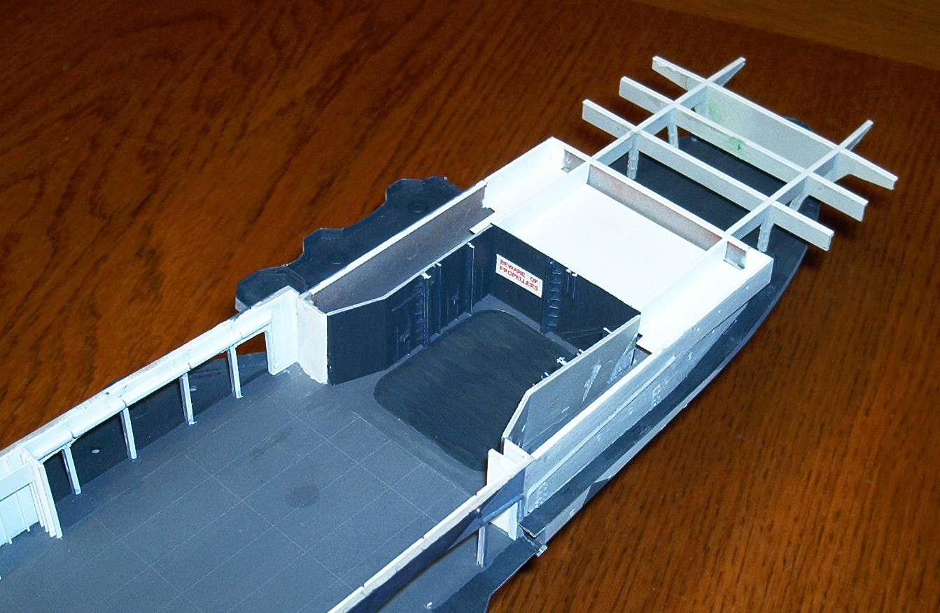

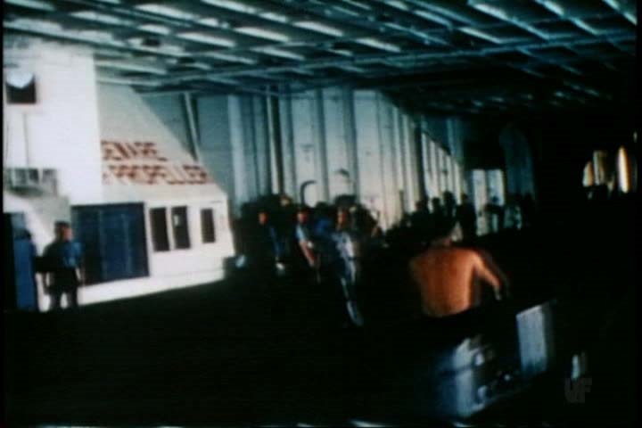

Forward elevator well bulkheads
Wartime photographs of the forward elevator well on any of the Essex class ships are rare indeed, especially those showing the forward bulkhead. Although wartime photos of this area of USS Yorktown continue to be elusive, Tracy White was kind enough to send wartime photos of this area on USS Intrepid CV-11 and USS Lexington CV-16. The details visible of this area as shown in the wartime photos of the two ships, including details of the forward bulkhead, are identical. Therefore, I replicated these details on USS Yorktown consistent with the photos of her two sisters.
Unlike the white hangar deck interior bulkheads, the black and white wartime photographs show that the forward elevator well bulkheads were painted a very, very dark color, possibly Navy Blue 5-N. After discussing the most likely color for these bulkheads with Tracy, I will be painting the bulkheads shown here Navy Blue 5N.
Additionally, each ship had the warning "BEWARE OF PROPELLERS" conspicuously painted on the forward bulkhead, although done somewhat differently for each ship. Intrepid's warning appears to be 36" tall white letters (with the word "OF" in smaller 18" letters) painted in all caps across nearly the entire width of the bulkhead. Lexington's warning appears much smaller, painted in two rows of about 12" letterings in all caps, possibly in red, on a white rectangular background, located on the left (port) side of the vertical elevator track. Like her sisters, Yorktown probably had a warning painted here too. If so, it was probably similar or identical to the warning on the funnel uptake trunk as seen in the film "The Fighting Lady": red letters on a white rectangular background.
Elevator well bulkhead details confirmed by photographs provided by Tracy White.  <br />These bulkheads will be painted Deck Blue 20-B.  Note that the vertical track on the <br />forward bulkhead is offset to port.  It is unclear what function was served by the <br />three diagonal pipes or rods visible on the bottom right of the forward bulkhead.

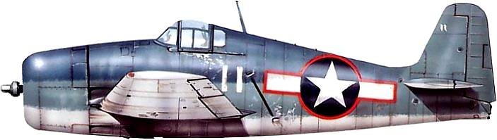

Air Group 5 F6F-3 Hellcat on the USS Yorktown (CV-10) in early 1943.<br />Non-specular blue-grey over light-grey scheme
During July-August 1943 the national insignia "Star and Bars" carried a red surround.
The red surrounds had been ordered repainted blue by the time of the Marcus Islands Raid on 31 August, 1943 but it is possible some aircraft still retained the red surround during the raid since photographs of Lexington's air group show red surrounds well after August, 1943. Air Group 5's Commander's Hellcat had blue surrounds during the Marcus raid (see photo below).

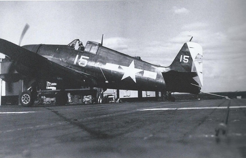

For purists, note that TBF (Grumman-built) Avengers had bronze green pilot's cockpits with the rest of the cockpit as interior green. TBM (General Motors-built Avenger) cockpits were painted differently than TBF (Grumman-built) cockpits.
Air Group 5 TBF Avenger on Yorktown in 1943

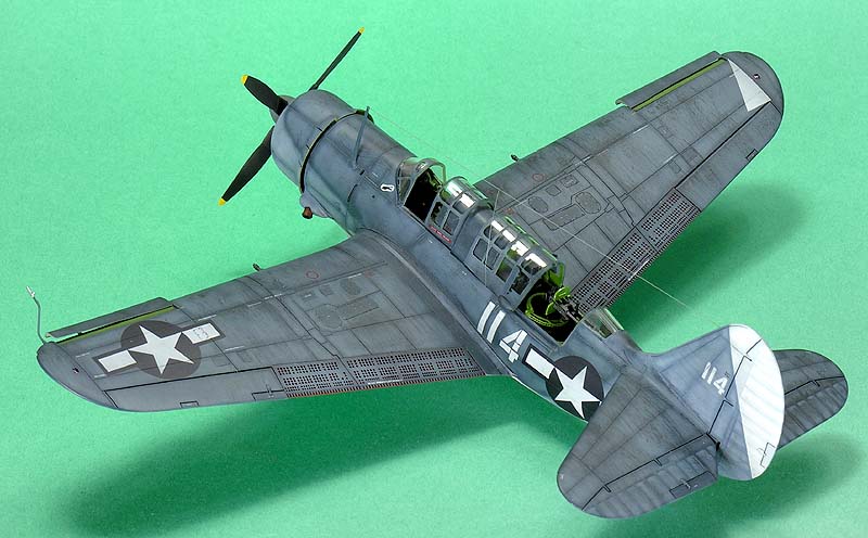

While aboard USS Yorktown CV-10, Air Group 3 retained Air Group 1's Helldivers and Avengers but received new F6F-5 and F6F-5P photo recon Hellcats probably painted overall glossy sea blue (Reynolds, pg. 189). F6F-5P variants substituted a 20mm cannon with 200 rounds for the innermost machine gun in each wing (pilotfriend.com). CVG-3 aircraft carried the white diagonal stripe through the January 12, 1945 strikes on Saigon (Reynolds, photo on pg. 214). CVG-3 transitioned to Yorktown's new aircraft identification markings by February 1st: a diagonal white field on the tail, white triangle on the wings and willow green propeller spinners (Reynolds, pg. 226). VB-3 Helldivers wore a diving black panther insignia.
1/48 SB2C-4 by Bob Laskodi in VB-3 (of Air Group 3) markings, Jan-Mar, 1945
1/48 SB2C-4 by Bob Laskodi in VB-3 (of Air Group 3) markings, Jan-Mar, 1945. Modelers note: Bob correctly shows the outermost flap's underside painted white. If you display Helldivers on your model with wings folded up, paint the wing undersides medium blue and the flap white.

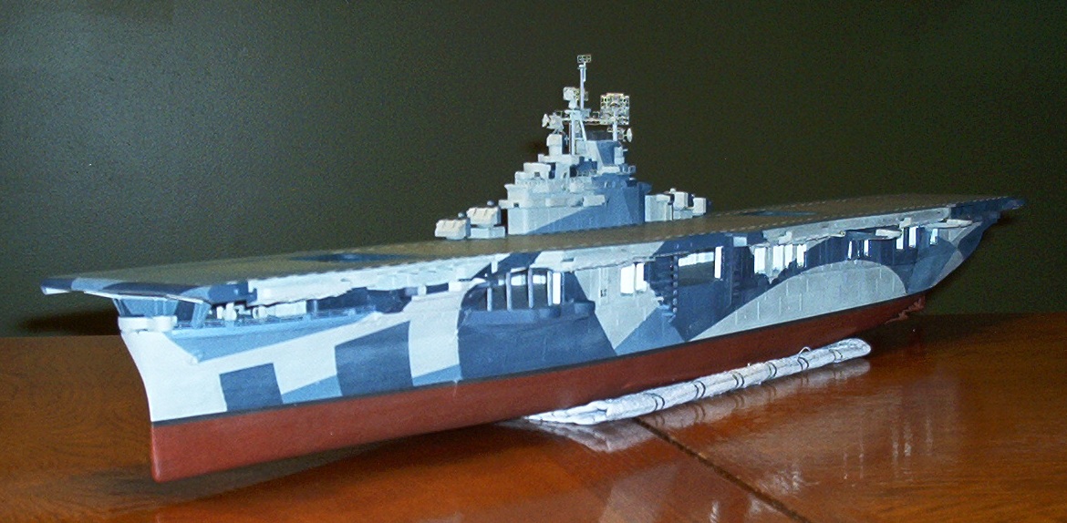

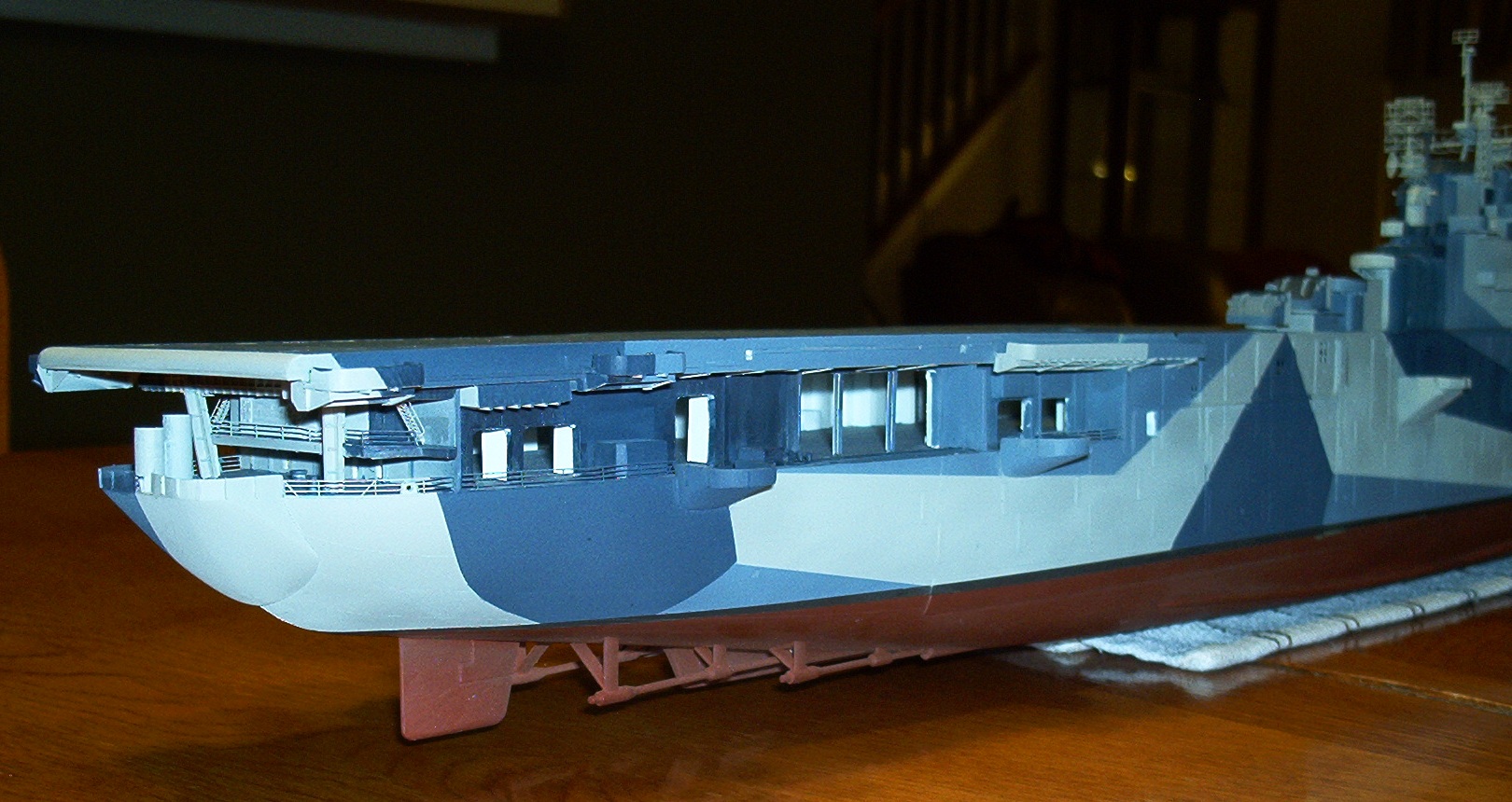

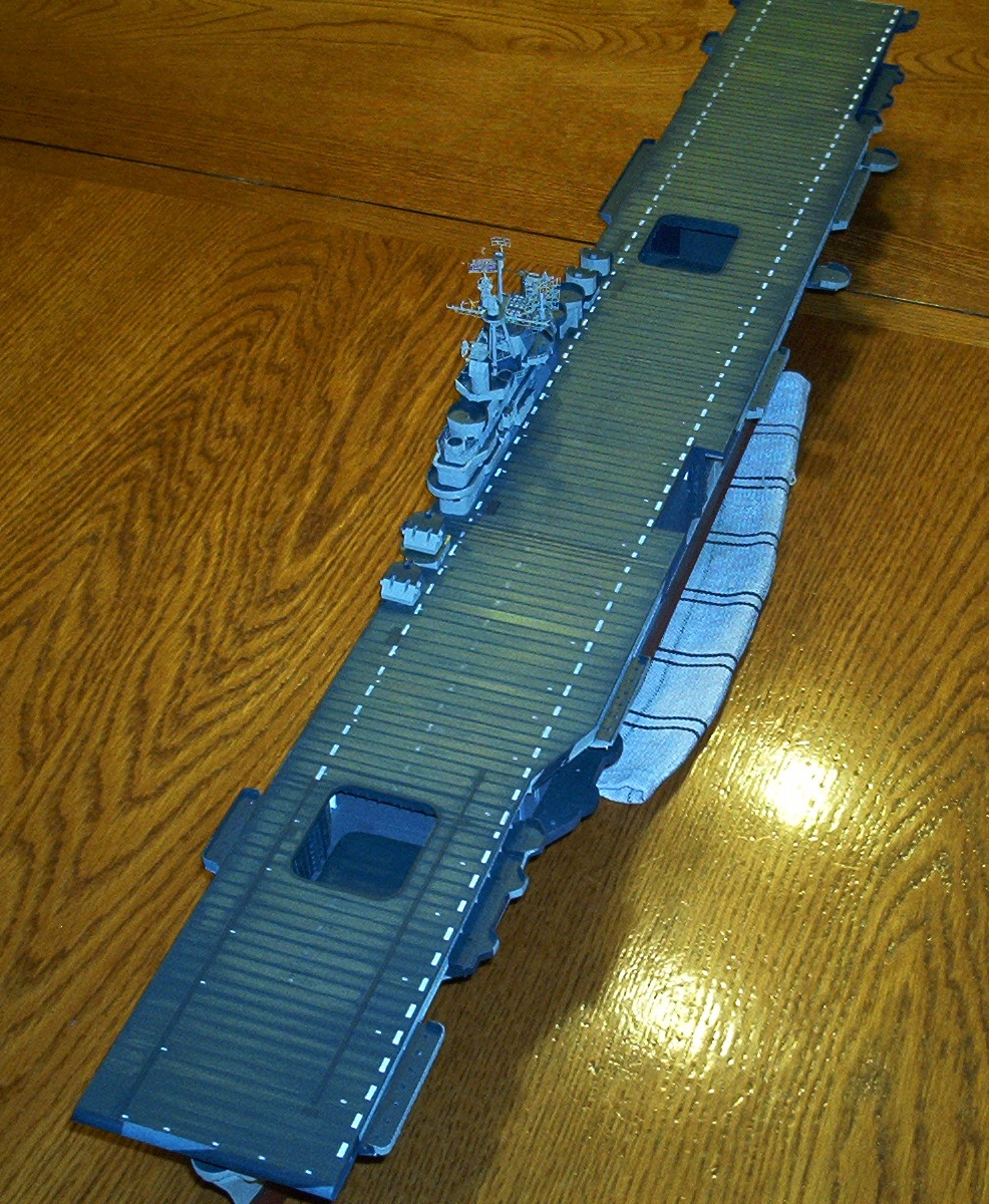

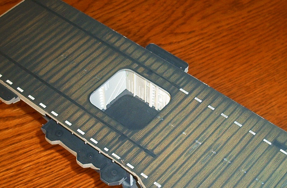

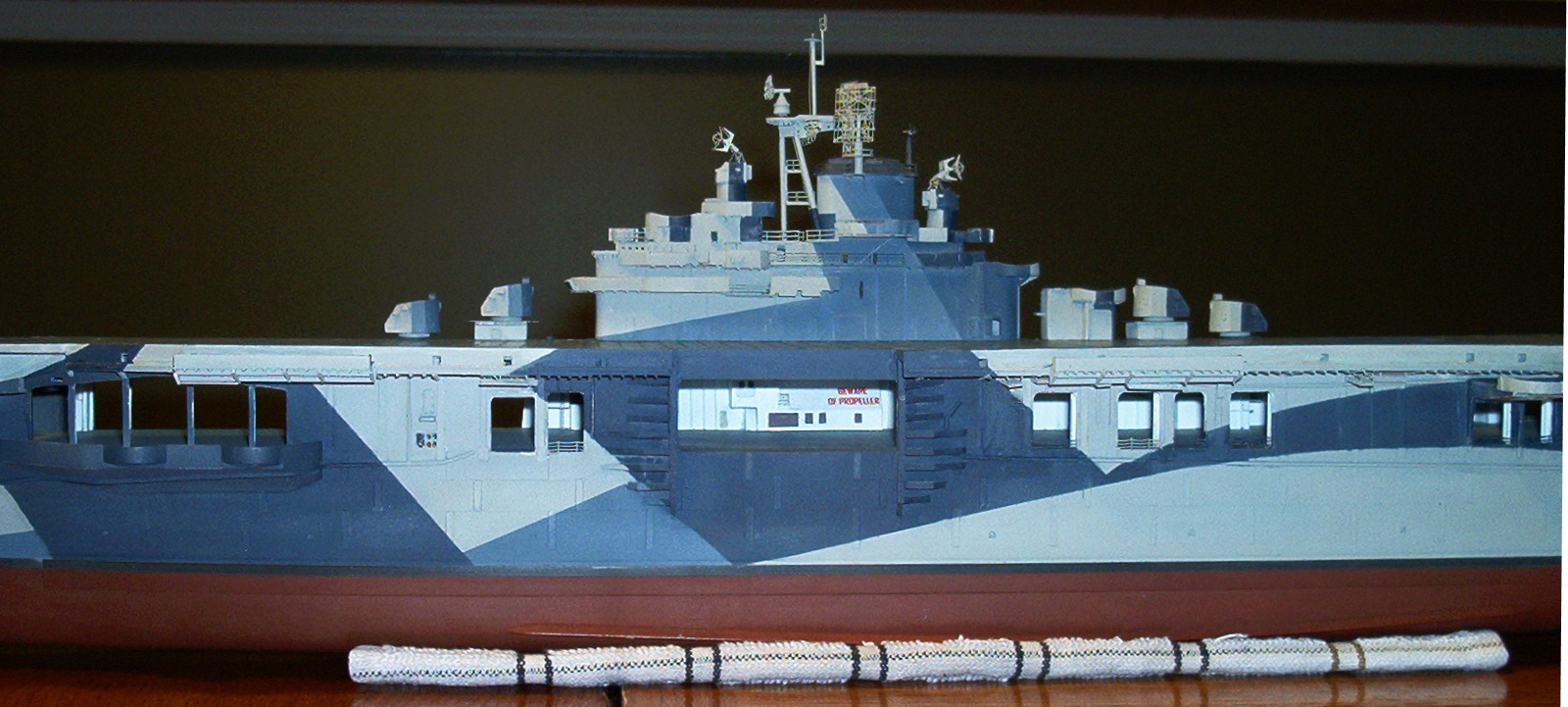

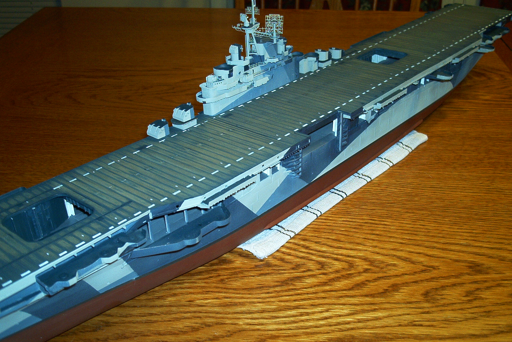

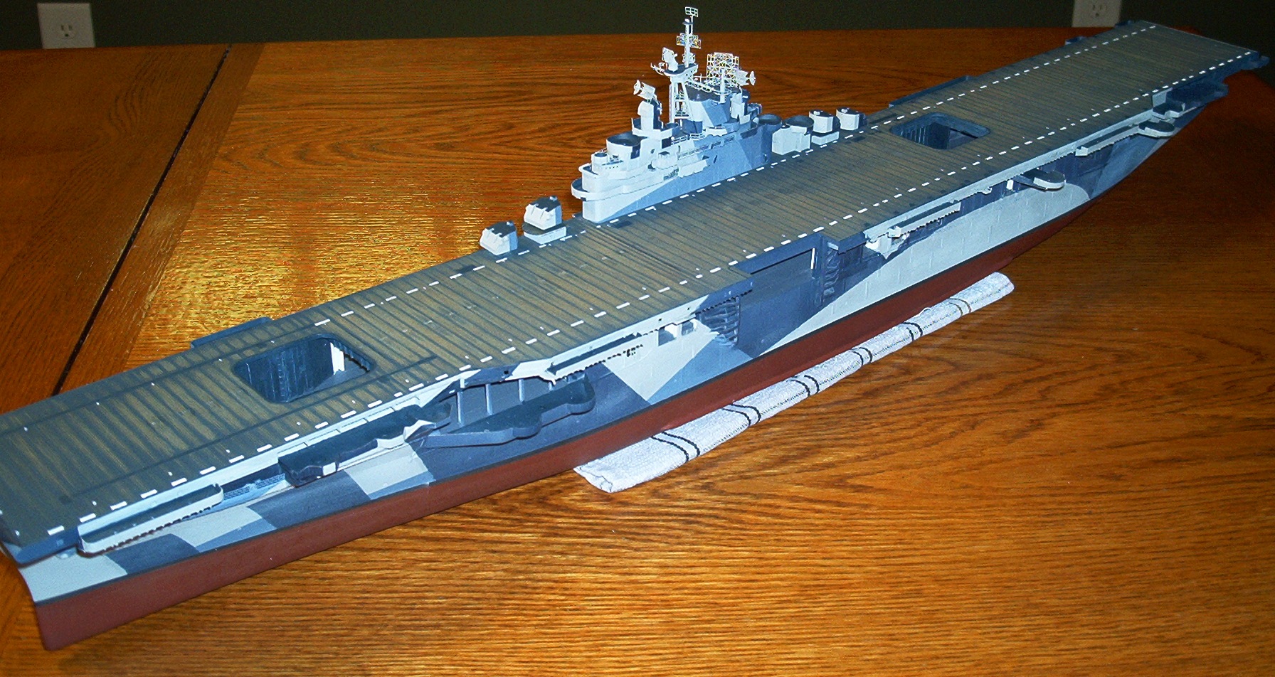

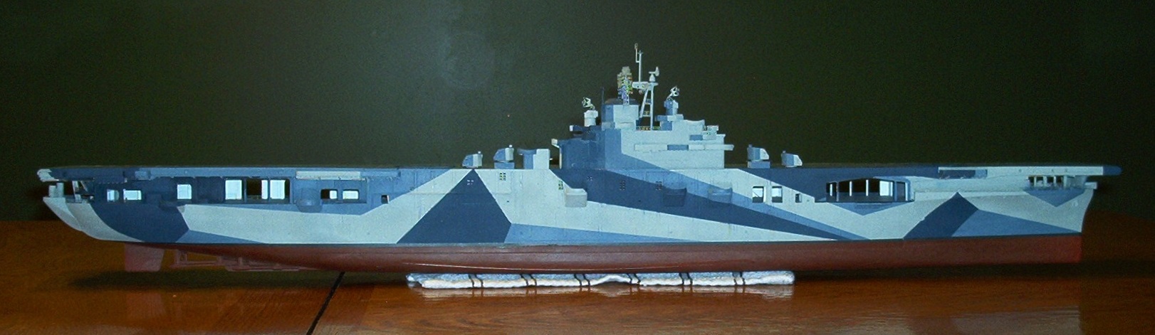

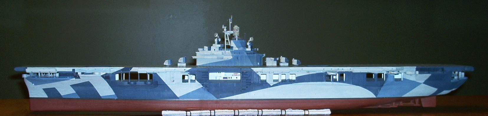

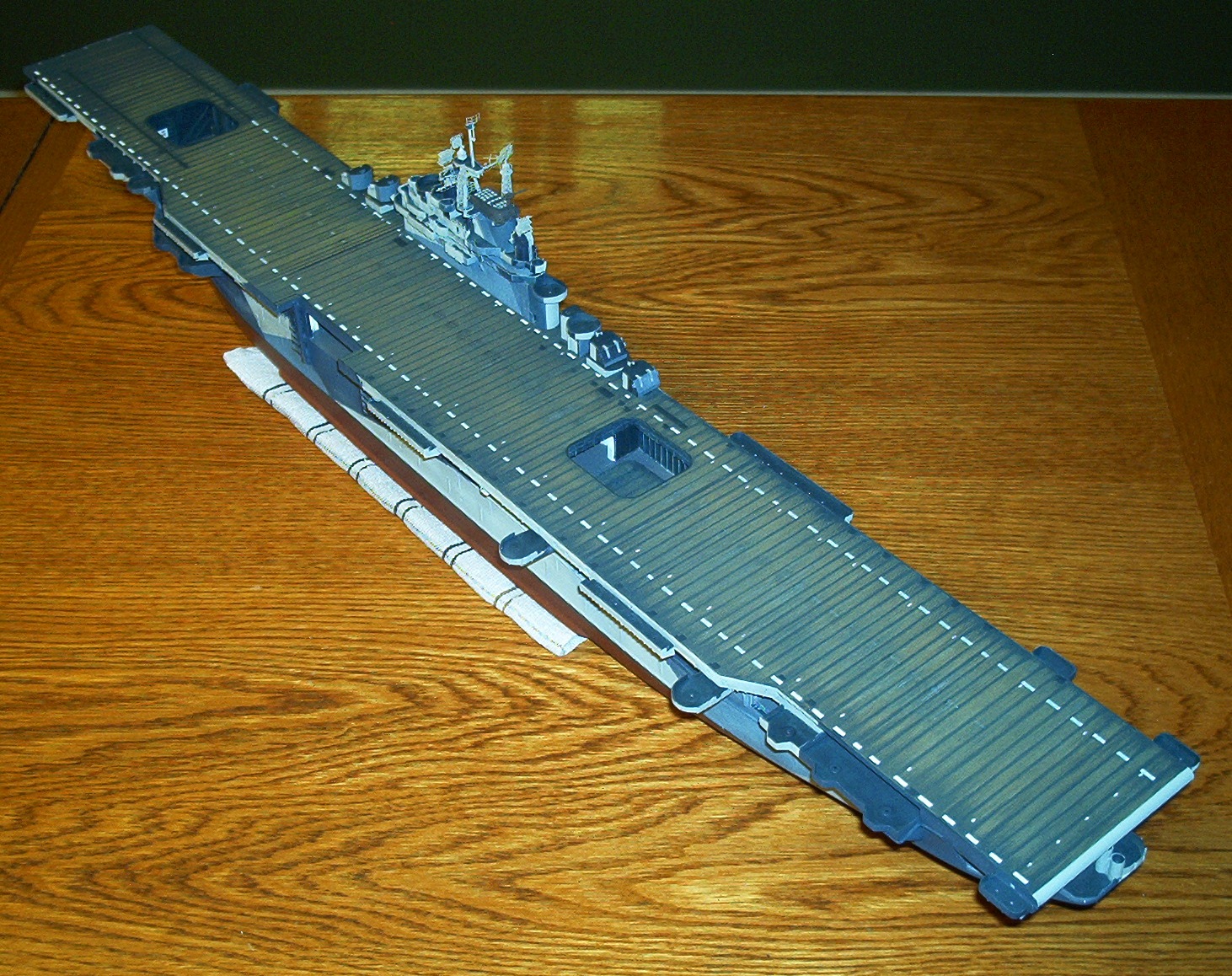

A bit more progress. Painting needs some touching up. It's about ready for PE and further detailing.
Flight deck, island and 5-inch mounts dry-fit in place.
Elevator well bulkhead details corrected for 1945 and painted.<br />Note that the lowered elevator is painted Deck Blue 20-B while <br />the hangar deck itself is painted Deck Gray.  The actual color <br />of the elevator well bulkheads is not certain, however black-<br />and-white photos indicate they were painted a very dark color, <br />possibly Deck Blue 20-B or Navy Blue 5-N.  After some <br />discussion with Tracy White, we feel that 20-B is the most <br />likely color and so I have painted the bulkheads that color.

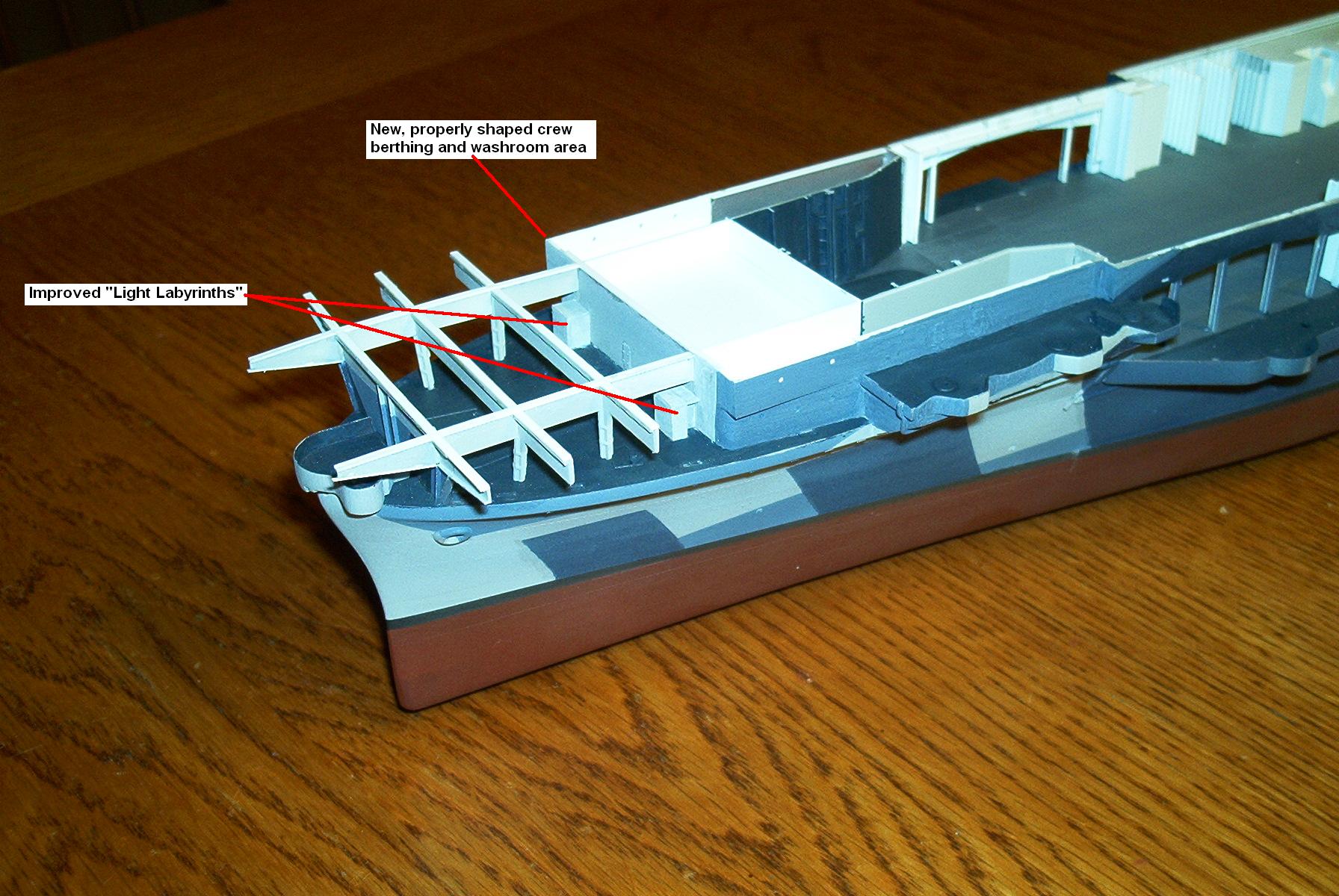

Kit crew berthing area replaced with properly shaped boxy <br />structure.  Portholes in the new structure were made using a <br />punch and die set.  The light labyrinths appear in AOTS drawings;<br />note that they are not symmetrical to one another.

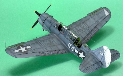

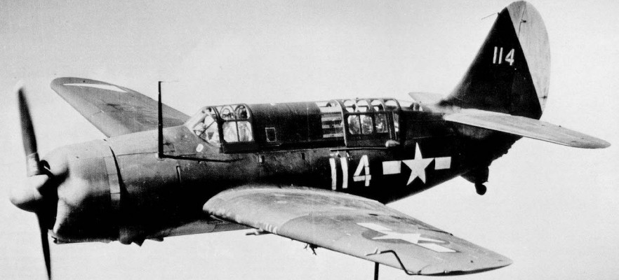

One for Helldiver fans: a CV-10 SB2C-4 of VB-3, #114, as modeled above by Bob Laskodi.  Note the small diving black cat insignia under the windscreen.

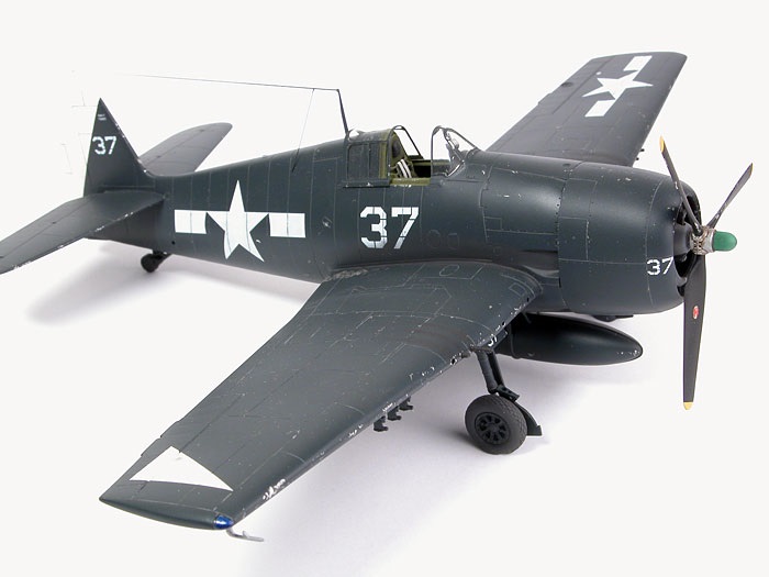

For you F6F fans, here's a wonderful 1/48 scale F6F-5 by Chris Evenden in Yorktown markings for 1945. Note green spinner.

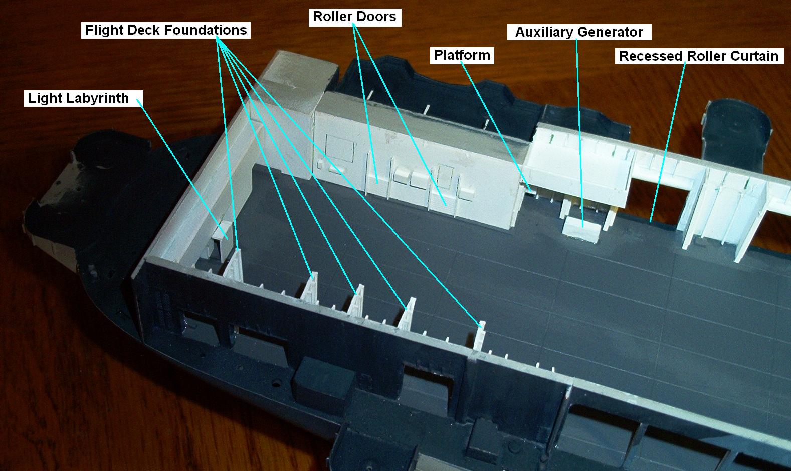

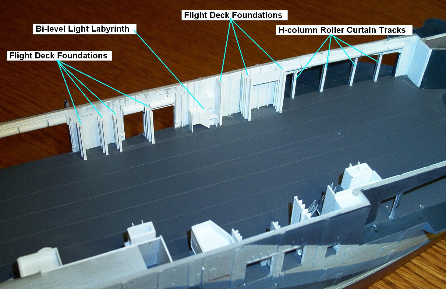

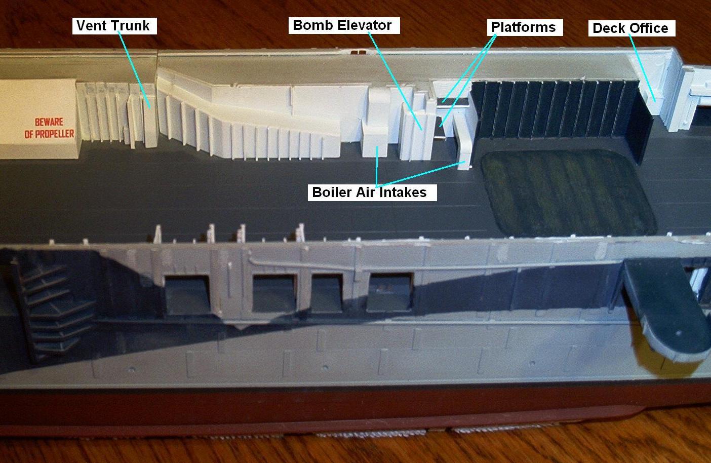

All of the major structures of the hangar bay have been fabricated and installed as per AOTS or photos from Tracy White. The hangar deck is now ready for some final touch-up painting. A few more minor details and markings will be added then the flight deck will be fixed in place.
The kit parts of the starboard side of the hangar interior required major modification to make them appear more closely to AOTS drawings A6, A7, A8, A9 and E7.
The bomb elevators should be positioned consistent with the steel elevator hatches of the kit's flight deck parts. Trumpy beautifully represented the flight deck surface detail including the steel elevator hatches. Their locations are consistent with AOTS drawings. Simply dry fit the flight deck parts on the model and positioned the scratch-built elevators right under the hatches. Trumpy's flight deck parts (the best parts of the kit) also include the torpedo elevator hatch. However, it is not necessary to replicate the torpedo elevator on the hangar deck since the real torpedo elevator was hidden within crew berthing areas on the starboard side of the aft aircraft elevator (within kit part D17) and therefore not visible on the hangar deck.
Kit parts D10 and B20 are not accurately shaped and required <br />significant modification, especially the forward end of D20, to <br />make them more closely represent how the structures are <br />drawn in AOTS.  Most of the scratch-built structures added<br />such as bomb elevators, etc., are identified in these photos.
Two-bar photo-etch rails will be added to the platforms. The<br />empty space above the deck office will be largely taken up <br />by a new boxy structure not yet fabricated.  Note that some <br />of the flight deck foundations and bomb elevators do not <br />reach the top of the bulkhead.  Since I built the gallery deck <br />level crew compartments onto the bottom of the flight deck <br />parts, it was necessary to allow sufficient space for those <br />compartments by building some of the flight deck foundations <br />and bomb elevators short.
Tracy White graciously sent photos of light labyrinths which <br />helped significantly in replicating these features.  The rough <br />area on the bulkheads in the left side of the photo above the <br />short flight deck foundations will be covered by the gallery <br />deck level crew compartments therefore this area does not<br />need to be painted or cleaned up.
According to AOTS, a few of the aft, port side roller curtains<br />on the real ships were recessed into the hangar.  That's why <br />you see a strip of Deck Blue 20-B on the hangar deck edge <br />at the opening instead of Deck Gray.  Most of the roller <br />curtains were positioned nearly flush with the edge of the <br />deck but not here.  As seen in September 1944 photos, kit <br />part F16's splinter shielding protecting the two fantail Bofors <br />mounts is not accurately shaped for Yorktown.  The splinter <br />shielding should be straight along the aft end of the part, <br />not rounded inward.  You can see in this photo I have <br />removed the incorrect sections.  They will soon be replaced <br />with correctly positioned strip styrene consistent with photos<br />of the real ship.
of the real ship.

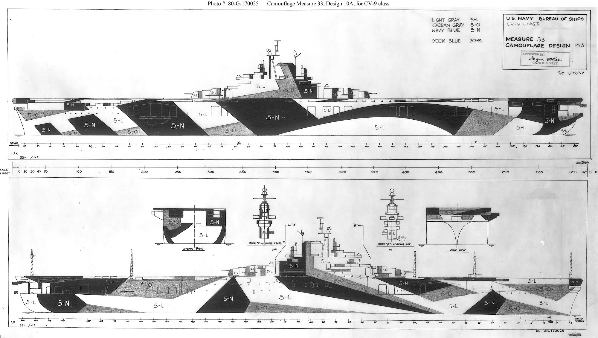

A bit more progress. The hangar deck is complete and the flight deck is now permanently fixed to the hull. Paint touch-up, PE and further exterior detailing is underway. Radars have been fit to the Mk-37 Directors.
Here is the official 1944 Measure 33 Design 10A specification. Post-refit photos of Yorktown during her shakedown in Puget Sound show that her late 1944-early 1945 appearance is very close to this pattern but there are several minor variations (Sumrall pp. 1, 29 & 49). The model is painted according to photos, not the specification.
Here are some overall views:
Note that the port side camouflage pattern for the island does not align with the hull pattern.  <br />This was done deliberately to match post-1944 refit photos of Yorktown (Sumrall, pp. 29 &amp; 49).
This was done deliberately to match post-1944 refit photos of Yorktown (Sumrall, pp. 29 & 49).
Masking the flight deck was tedious but I like the effect.  Several markings have not yet been applied,<br />most notably the two large black numeral &quot;10s&quot;.
most notably the two large black numeral "10s".
