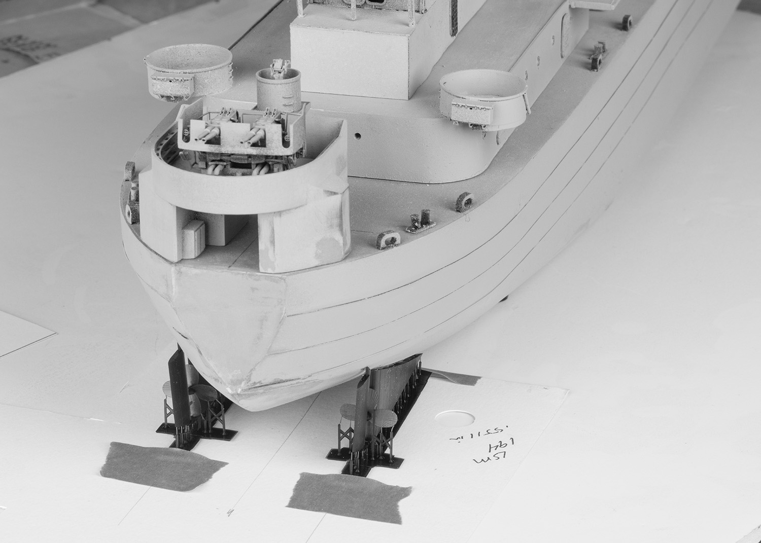

Showing skegs/props/rudder assemblies inserted under the stern and glued with epoxy. Currently removed the printing supports and puttied the transition, to be sanded and cleaned up.

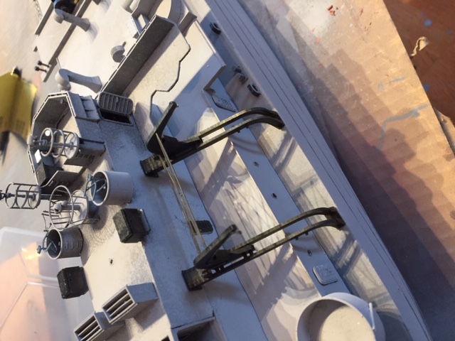

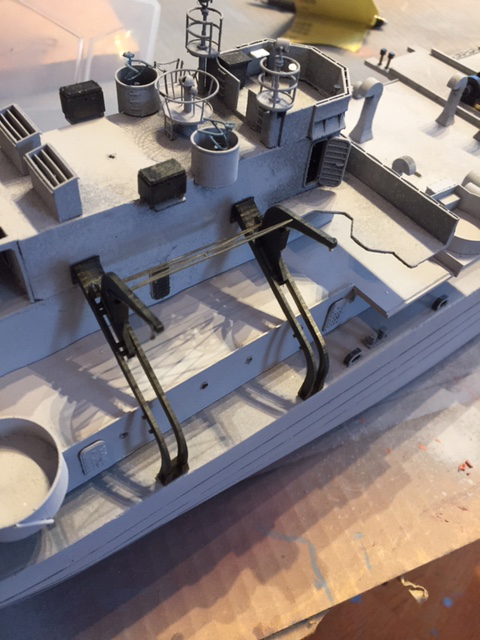

Slipping standards: Eye-Phone photo of the trial fit of the Whelan Davits. Now I can print the Port-Starboard davits with additional detail. Unlike the APA, the boats do not rest in cradles, but hang from the davits, which is a minor issue for modeling as to modeling the pieces from which the boats hang with sufficient strength.
A ponderable!
Tom

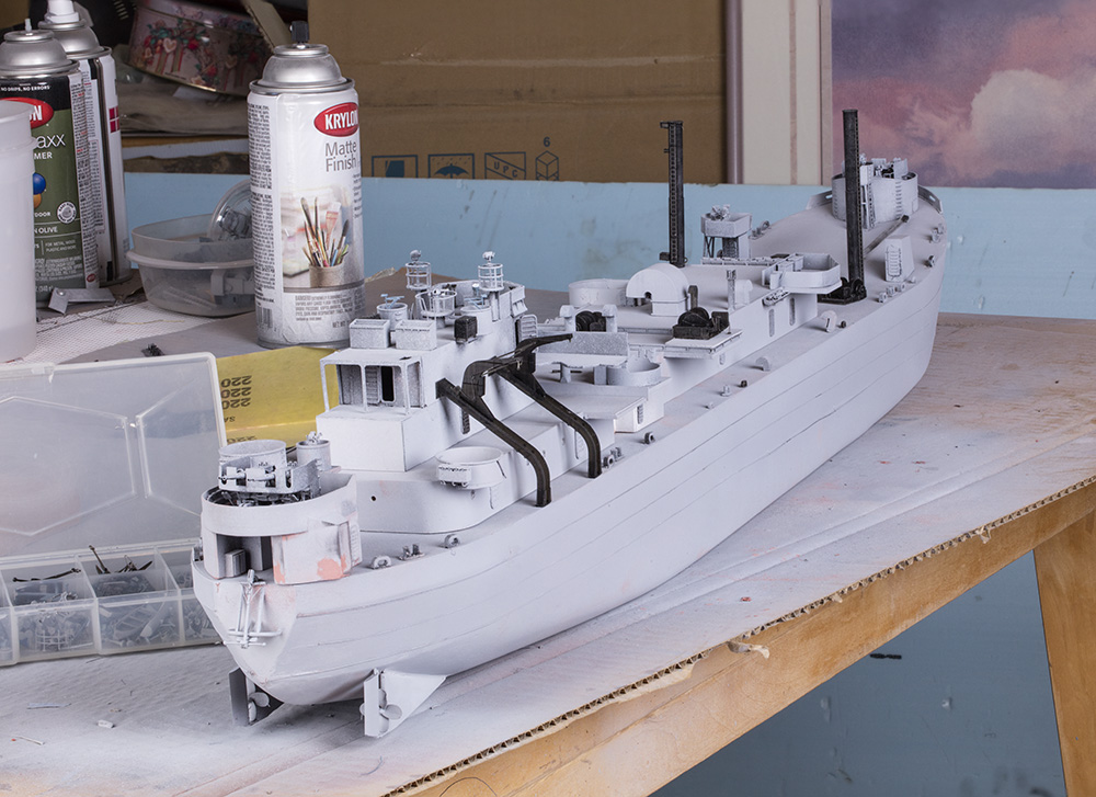

Lots of items (everything just sitting in place) on board. The Whelan davit is a test horse, the more detailed final items printing. The increased diameter of the forward boom resulted in a more useable item. Before a lot of these items are finally attached other detail must be accomplished such as rails, maybe some painting etc in proper order since some of these areas will be difficult to access once some items are in place.
A somewhat rough and ready on the ways photo, but I am using a long focus (100 mm) macro lens and two studio flashes with soft boxes. To get sufficient depth of field with a long focus lens, photo stacking is due where a series of photos are taken with each having a different focal point. The software combines the series of images into an image with greater depth of field.
Tom
