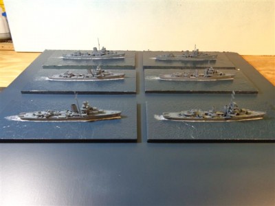

Man, I was working on the Tamiya Hammann kit when I reluctantly decided to take all 5 of my Midship DD kits and have another go at them. I thought the funnels were bad but, I took a look at the the bows of each ship and they are terrible too! All of mine are rounded at where the waterline plate starts where they should be raked. As of now I am fixing all of them with some Evergreen strip to give them their proper appearance.
On a successful side note: I scratch built a Benham stack that I think looks pretty good to my eyes. I just have to do some additional sanding and tweaking but, I think it looks right. There is hope and a glint of light at the end of the tunnel.
My thanks to everyone. These are my favorite US destroyers and the information and insight provided here has been a great help with my goal of reproducing at least one of each class.
They look great considering what you had to work with. I am in the process of completing 5 of my kits and the road blocks and hurdles seem never ending! Thank you for the inspiration for helping me forge ahead!
Appreciate your kind and encouraging words. The Midships Models are so frustrating because there is so much that could have (easily?) been better. Good concept; poor execution. Still, the only game in town, and if you really want to model these ships, as I did, worth the effort. I found a number of "common" fixes that I could apply to all and built them in successive pairs which seemed easier.
The Farragut is a backdated (no 40mm) Niko model. These all are part of a larger, and also now completed, collection of SoPac U.S. Navy destroyers. I actually bought a few more Midships kits for pre-war and late war versions but they'll wait.
Happy to read you are back at work with yours and look forward to hearing more.
