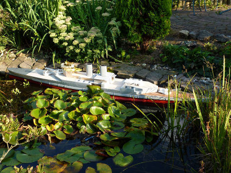

Hello, dear friends!
Today�s post is sent not from the shipyard in the basement, but from Mom�s pond - to see whether Renown is waterproof - and how much ballast to be added. At first, she is dry, even with no grease in the shafts. But she is a lightweight... I had to drop two of Grandpa�s lead-bars inside, so that the total weight will be approx. 42 Kilogrammes.
Porpulsion is working very effectively - sorry to the fish!!! So now almost everything is prepared for the trials...
Best regards from sunny Dortmund!
Joachim

- JIM BAUMANN
- Posts: 5689
Re: 1/100 HMS Renown (1942)
TOP TOP !!!
Now that IS real progress!
Jim Baumann
Jim Baumann

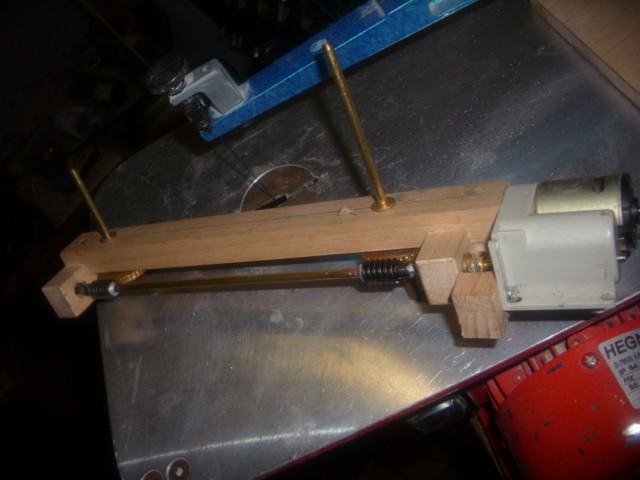

Due to high season in organtuning, works on Renown are proceeding slowly only. The basics of the turrets turning mechanics are done, at the lower end of the rear axis the cam for the switches is still missing. Once linked with all the cables ans switches, it won�t be looking that orderly any more, as I fear
Meanwhile, I�ve made two trunks for the smoke gas. They reach down to the deck and shall end on the upper cover of the windtunnel, where the two smoke generators will be placed. Here you find some pics of this preliminary state - later invisible being all internal....
Best regards and happy modelling!
Joachim

A little progress can be announced: I�ve started planking the fo�c�sle... Shame, the prepared plankes will not be enough, so some more hours of cutting are already booked for next year.
Meanwhile, a miracle has happened: My next attempt to create a turning-mechanism for turrets A and B is working! The speed is almost realistic, only the noise is not. But I guess, later on the water it won�t be that bad
Today my Conrad-order has arrived, so in the much too short chrismas-holidays the funnels are intended to smoke for the first time. This is linked with a further experiment: I�d like to vary the cloud of smoke from small to full spead, so I�m going to try to control the both smoke generators with a simple controller for electric rc-planes (does only have to go stop and forward). So if xmas starts to become boring - up and away to the yard...
Have wonderful chrismas days and a good start into 2012!
Best regards from Dortmund!
Joachim
