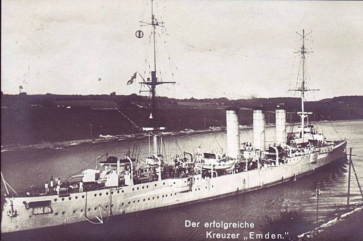

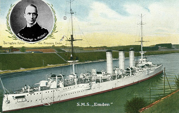

I am returning to building model ships after being away for several years. To get my feet wet again, I purchased the Revell Emden/Dresden 1/350 kit. I intend to build these ships as pretty basic OOB models. In doing a little research on the Dresden, I have run into a situation.
Most pictures of the Dresden, as found on the internet and in the kit, show the foremast stepped immediately behind the bridge/conning tower. However, I found two photos of the Dresden (one in Anthony Preston's book Cruisers, and the other on an internet site), both labelled "Dresden" on the photos, that show the foremast stepped immediately ahead of the bridge. Was there a relocation of that mast in a refitting? Or were those two photos misidentified?
I know there was a second Dresden put in service after the first was lost, but it had the foremast behind the bridge also.
Since these two models would be practically identical, it would be nice to have a prominent feature to differentiate the two. Also, in the kit the Dresden is equipped with four shafts and screws. Written references describe this ship as have twin screw turbine drive. Sources agree that Emden was the faster of the two ships, yet Emden used VTE and Dresden used turbine.
Can anybody here give me some advice on this?

Re: Calling all SMS Emden/SMS Dresden fans
the foto on page 21 of preston book is of a light cruiser class leipzig, the munchen probably, as you seen from the decoration on the bow.
ciao peppe
I don't have Preston's book, but Peppe is right, some ships of the Bremen class did have their foremast stepped forward of the bridge. These were Bremen, Hamburg, Berlin and L�beck in their original configuration, but most of these (except Berlin) had their foremast later stepped behind the bridge. Leipzig and Danzig from the Bremen class always had their foremast behind the bridge.
Likewise, the next classes (Konigsberg and then Dresden/Emden) always had their foremast behind the bridge, which was apparently the norm since 1906.
Unfortunately the differences between Emden and Dresden were very slight, even to the point that I know of a well known example of an official photo of Emden, being in fact the Dresden! The giveaway: the steam pipes adorning the three funnels run distinctly different in these two ships, so if you compare this photo with others from Dresden and Emden you will come to the same conclusion. Apart from that I wouldn't know other differentiating features, above the waterline. Another option though is converting one of the kits into a K�nigsberg class vessel, the differences are more visible then, in particular when you would model SMS Stuttgart. A nice conversion by Wolfgang Kring can be found here:http://www.modellmarine.de/index.php?op ... &catid=146
When you want to go this route I can provide you with more detailed plans of that class.

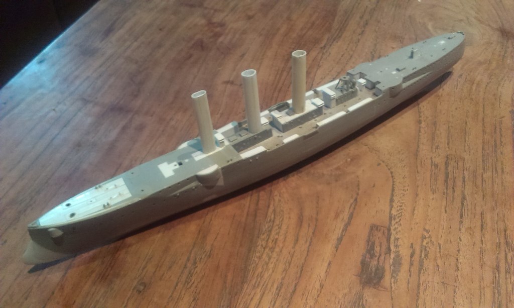

- Maarten Sch�nfeld
- Posts: 1843
I fully agree!
The Revell Emden and Dresden kits really have a lot of potential, I already mentioned the conversion to a Stuttgart (Konigsberg class) isn't too difficult, for myself I started a conversion to the Nurnberg sister ship.
I also have started another conversion of the same thing into the Leipzig (Bremen class) as pictured here (sorry, I only had my scanner at hand...). This requires a lot more indeed: taking out a one inch section at the waist, new bow with much more 'ram', funnels replaced by scratch ones (cross section oval on the middle and forward one), bulwarks blended in, focs'le deck reconfigured, ventilators improved etcetera. But it is completely doable. I also believe a Kolberg class belongs to the possibilities, although that one needs adding a section to the middle. A Gazelle class is under consideration, but structurally these ships were somewhat different, having a different frame spacing to start with. But I might...

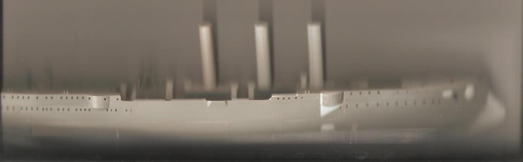

Hi Maarten,
unfortunately the link does not work properly - or the photo is a strange (kind of aquarium view).
I had thought to built Leipzig using Blue Ridge's Emden kit, but I have not done it, because the proportions are very different. Not only Leipzig is shorter, but also the forecastle and poop are much shorter. And the hullform at the positions, were cuts would have been done, is very bended. I thought it would be easier to scratch built her.
The conversion to Kolberg is much easier: I have added three pieces (one in the forecastle, two midships), but the elongation of the forecastle and a (bigger) elongation midships would also do the job.
Lars

As the Blue Ridge 1/700 Emden kit is made of resin, conversion will be rather more difficult than with the Revell 1/350 kit. But he's where I made the hull cuts:I had thought to built Leipzig using Blue Ridge's Emden kit, but I have not done it, because the proportions are very different. Not only Leipzig is shorter, but also the forecastle and poop are much shorter. And the hullform at the positions, were cuts would have been done, is very bended. I thought it would be easier to scratch built her.
below the waterline: at the widest point of the hull, halfway the bilge keels. You may disregard this of course with the Blue Ridge model as it is a waterline model.
above the waterline: one cut just aft of the rearmost hammock lockers. second cut just aft of large front casemate and one just in front of it. The front casemate is effectively relocated. I retained the foc'sle and poop decks, with considerable changes. I replaced the main deck with Evergreen 2020 'Car Siding', having v-grooves spaced at .020 inch (0.5 mm).
Btw: I used original Kaiserliche Marine plans of SMS Danzig that are available from a Russian website, that unfortunately cannot be linked here as they seem not to respect copyright of other users of this site. Problem might be that you will have to search for 'Danzig' spelled in Cyrillic letters though...

- Maarten Sch�nfeld
- Posts: 1843
I owed you a better picture of my SMS Leipzig model, still...
