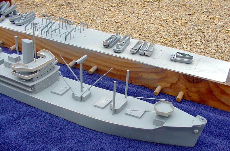

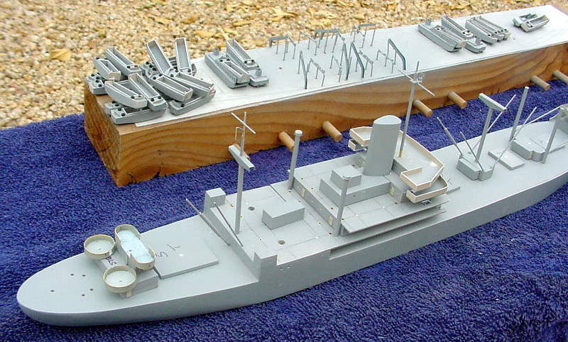

Just about all of the large and medium sized parts are done. I left the davits and boats on the isolation block, the pile at the rear is the 16 boats that go under the davits. On to painting and assembly.
Jim

Looking like a hero!!!! :thumbs_up_1: :thumbs_up_1: :thumbs_up_1: :thumbs_up_1:

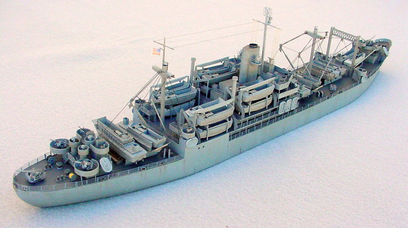

Re: The "others"..USN/1944..1/350...Two C-3 APA's...One done
Post by JimRussell »

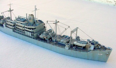

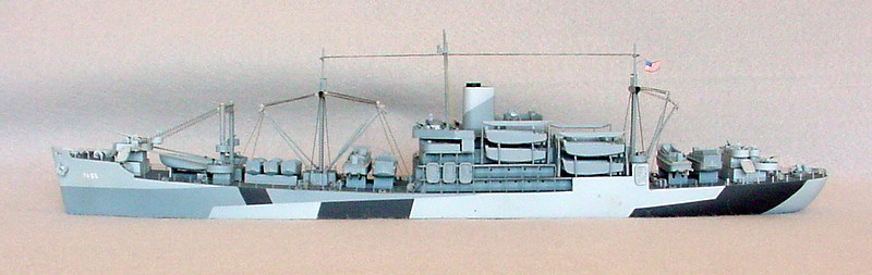

One C-3 done.
Jim

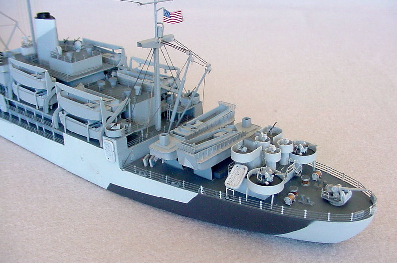

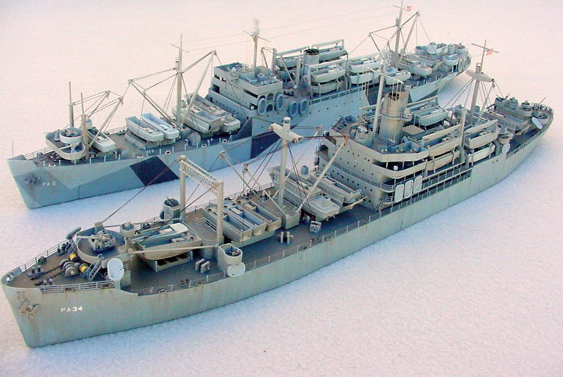

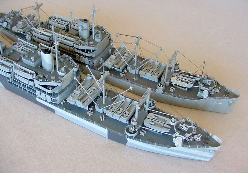

Two APA's. The second photo shows the difference between a beam of 56' vs 70'.
Jim

WHOOOOOAAAAAA!!!!! that is fantastic Jim!!!

you are a artist sir! :thumbs_up_1: :thumbs_up_1: :thumbs_up_1:

Excellent work Jim. I do have to say the pictures here do not do your ships justice, not after having seen them in person!

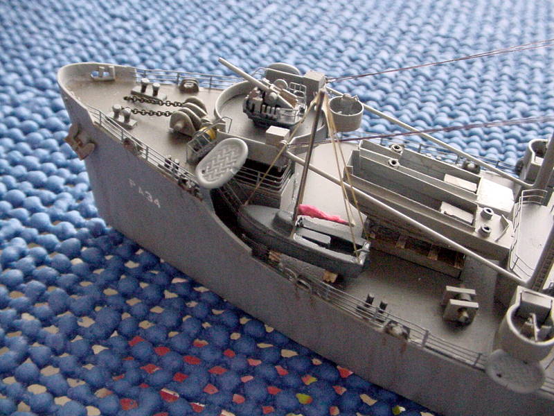

One more photo, in honor of "Beachhead Belinda".
Jim
Post by Sr. Gopher »
Wait, is that a sailboat on the deck??
Sr. Gopher wrote:Wait, is that a sailboat on the deck??
Yes, it is a sailboat, specifically a 24' centerboard sloop named the "Albatross". The sailboat was an important secondary plot line in Kenneth Dodson's 1954 novel "Away All Boats" (in 1956 the book was made into a movie with the same name). The book followed the campaign of the fictional USS Belinda, APA-22 from the Gilbert's in Nov 1943 to Okinawa in Apr 1945.
The book does not go into detail about the ship itself, but does state that she was built on the west coast early in the war, had a 70' beam and carried 4 LCMs. The only ships that met this criteria were the C-3 conversions, which included the Bolivar I have just finished.
Similar to "The Caine Mutiny", one of the major plot lines of the book was a study of command at sea. In this book Captain Hawk was at all times competent, but both he and the crew were in various ways negatively influenced by the length and insanity of the war. One of the devices the Captain used to "shake up" the crew was to have them build a sailboat, to make him and the boat a concrete and absurd focus for their anger. The Captains own problems showed up when he decided he absolutely had to have red sails for his boat and became obcessed with the song "Red Sails in the Sunset".
Anyway, just to have some fun, the Bolivar is shipping Captain Hawk's red sailed "Albatross".

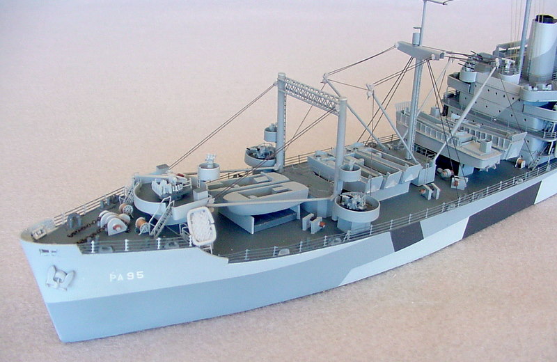

Re: The "others"..USN/1944..1/350...Two C-3 APA's...Two done

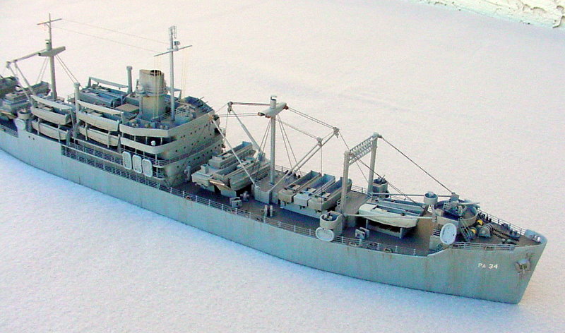

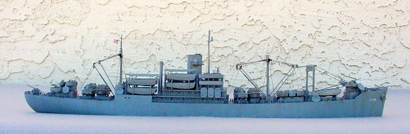

The Burleigh is done...
jim

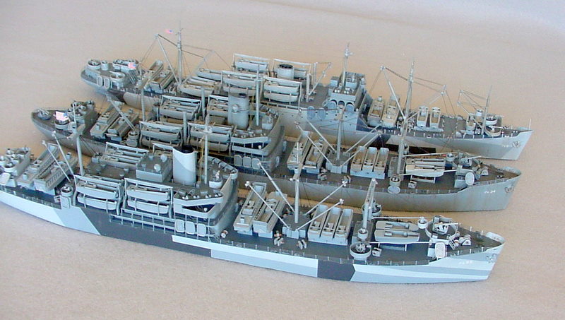

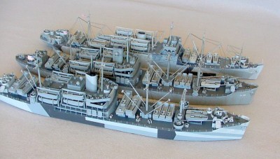

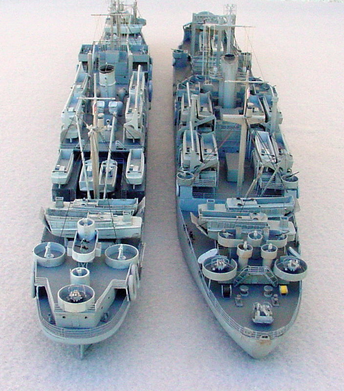

pic 1..two c-3's (the difference between the LCM-3 and LCM-6 can be seen)
pic 2..three APA's
On to the C-2's. since I now have a fleet of 3 APA's, they obviously need leadership. In other words, the Admiral needs a ride. The USN provided with a class of ships called AGC's or amphibious force flagships. I will do AGC-3, Rocky Mount which was the ride for Admiral Richmond Kelly "Terrible" Turner during the Mariana's campaign
jim
Post by GTDEATH13 »
Incredible builds... :thumbs_up_1: :thumbs_up_1:
Thanks for sharing... The camouflage is really impressive, both the pattern and the paintjob... :cool_2: :cool_2:

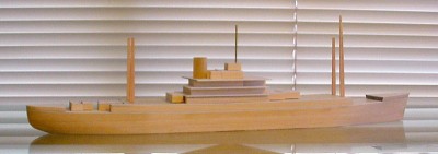

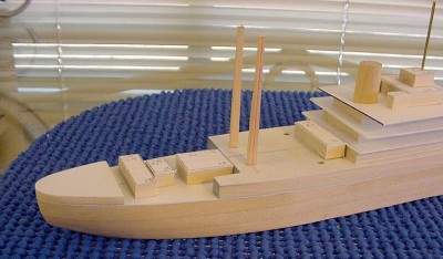

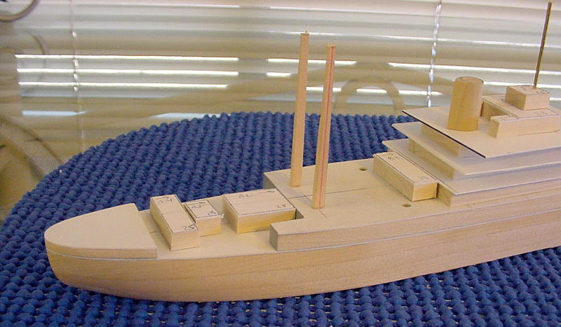

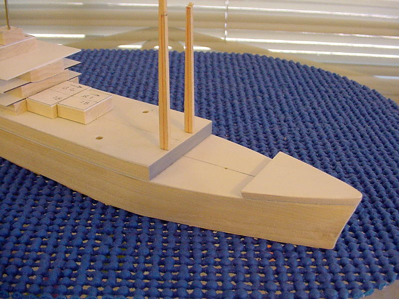

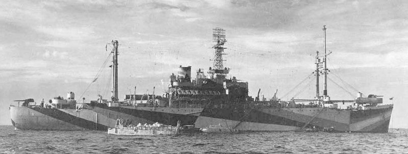

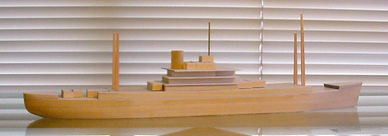

Vacations are over, time to start building!
The next ship is AGC-3, USS Rocky Mount, an Amphibious Command Ship. The need for a ship dedicated to command and communications became apparent early in WWII and a number of merchant hulls were converted for this purpose. Rocky Mount was converted from a C2-S-B1 hull.
She collected 7 battle stars during WWll, carried Admiral "Terrible Turner" during the Mariana's campaign, was present at Leyte Gulf and last but not least FDD had plans for her.
#1 is a Navsource photo (no credit given).
#2 is the ship roughed out in a similar pose.
Sometimes photos give you interesting stories if you use some imagination. Photo #1 is not dated but 1944 would be a solid guess. You can see there is an extension on the top of the starboard forward kingpost carrying a SG surface search radar. The ship as built nor any of her sisters had this extension in 1943 and it disappeared post war. Most ships of this class had the extension in the 1944 - 1945 period. It does not take much imagination to guess that the higher surface search radar was authorized because of the LARGE size of the fleets under command. Never again.
Jim
