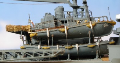

The changing from motor pinnance to motor boat is completed: Dirk

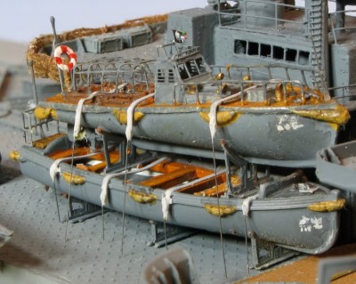

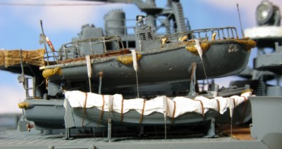

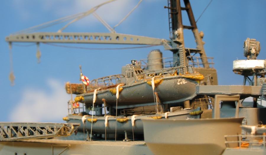

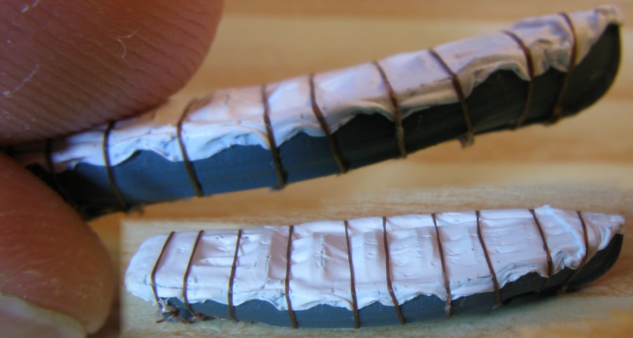

I added another 9 m cutter, this time covered by a tarpaulin. I used Teflon� tape (Polytetrafluorethen (PTFE)). The inspiration came from sirmaumau (viewtopic.php?f=59&t=49603&start=20).

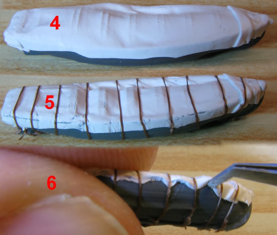

IJN Mogami (Tamiya 1/350)

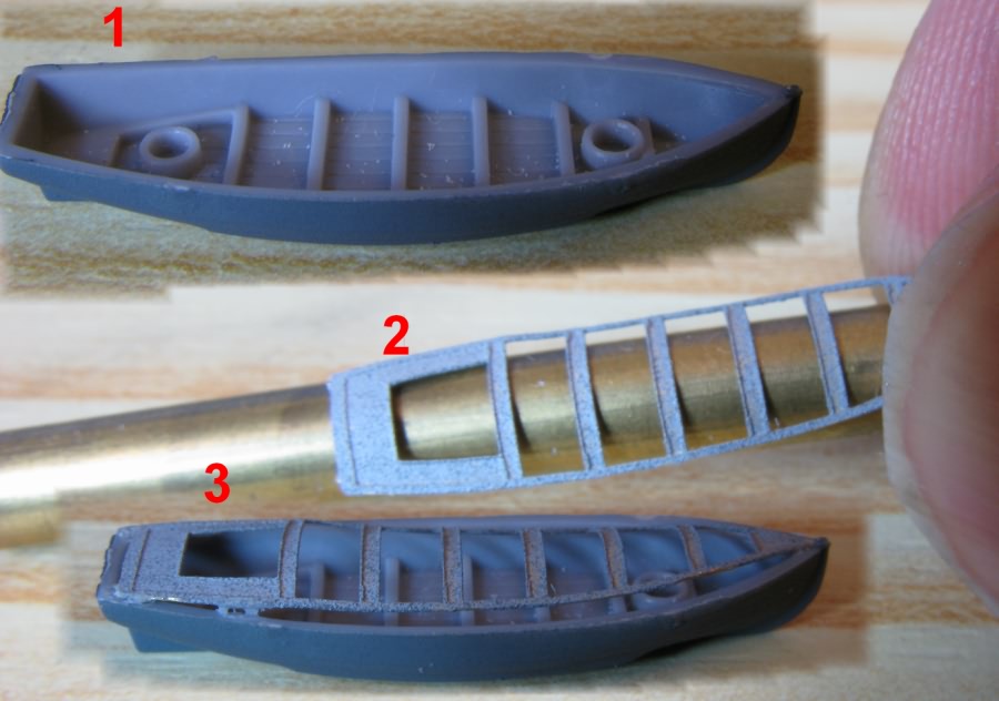

When I saw sirmaumau using the PTFE for boat tarpaulins I immediately started to do some experiments with this material. It seems to be difficult to produce wrinkles with this material. Typically it will be very straight and smooth. Then I had an idea which I want to show here:
(1) Starting with a spare cutter with a nice (airbrushed) bottom. The inside can be ugly as shown here.
(2) Bending a spare PE part for such a cutter
(3) Gluing it roughly to the cutter. This is only for producing some features in the PTFE cover.
(4) Putting the PTFE tape in place. I fixed three points with a little bit of CA glue.
(5) Attaching very fine thread (here UNI-Thread W6/0)
(6) Producing additional wrinkles carefully with a pair of tweezers
Mogami112, 108 and 109 show the result.
I want to add here that this one possibility and my main aim is do give some inspiration. The PTFE is very white but Enamel colors can be used. I also made experiments with a very fine layer of a pale yellow by airbrushing. Then by elongating the tape a little bit this seems to give nice aging effects. More experiments are required but I think this material is interesting for us ship modellers.
Dirk

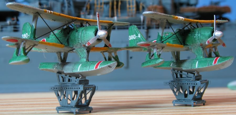

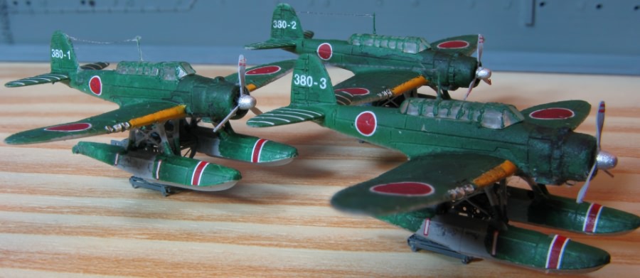

I finished the first 3 Jakes. They are from the Hasegawa seaplane set A and are coming with a clear canopy.
Dirk

Great job on the planes Dirk!! canopy painting looks amazing
i think i will try the teflon tape idea once i get to the boats i'm impressesed by how easily the ripples on the canvas can be recreated . keep it up!!

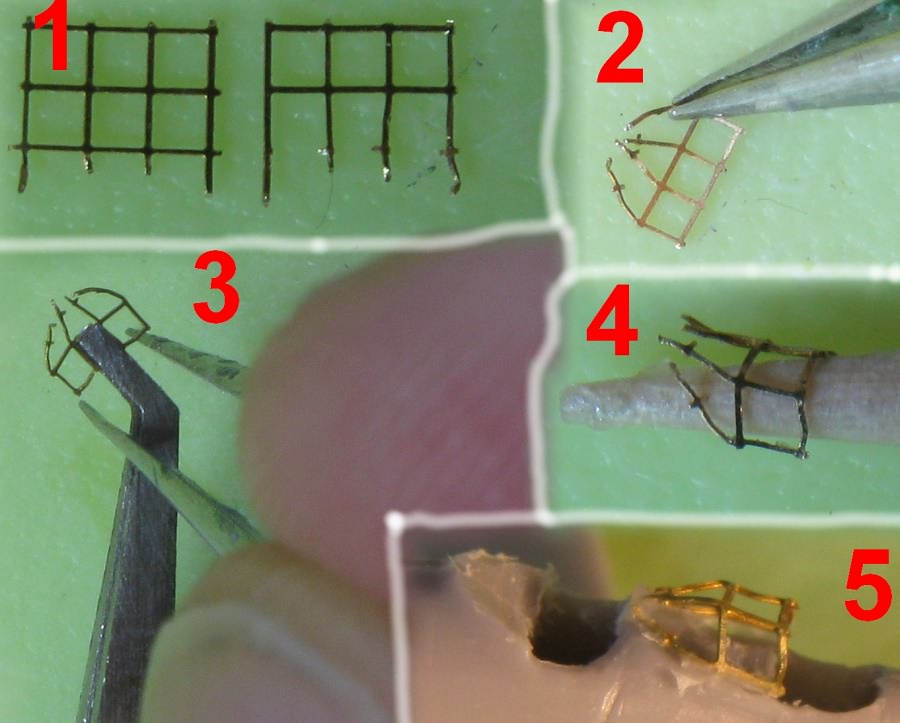

I am no producing five Petes and five additional Jakes.
In the case of the Petes I am bold and start without prototype.

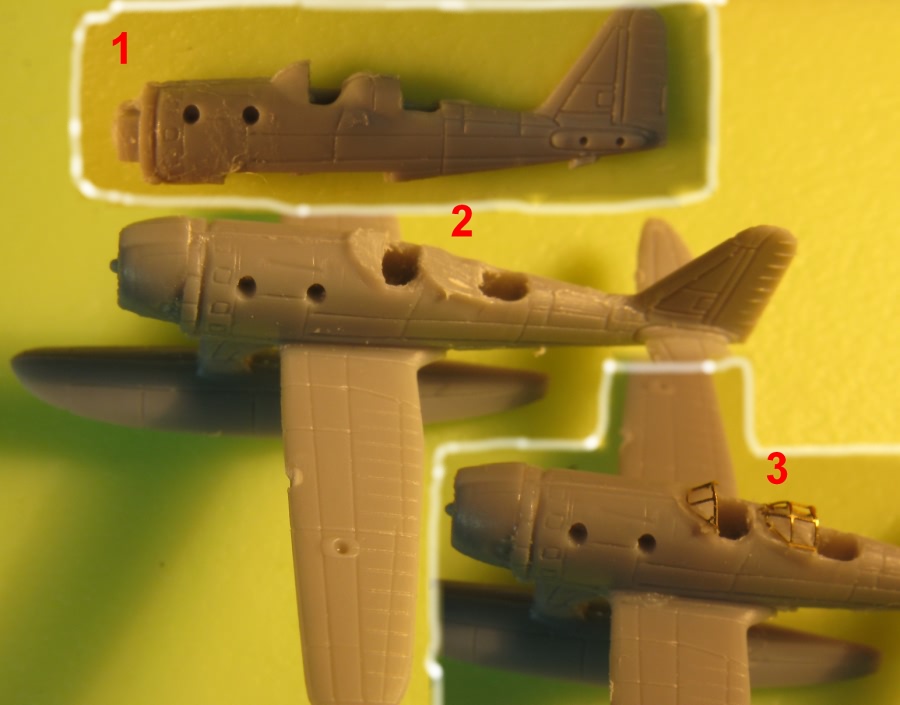

The Petes in the Hasegawa kit don�t have transparent cockpits and unfortunately no PE parts are included for that. So I have to produce them myself. It is not very difficult and a lot others here have shown the advantage of glazed PE cockpits. Here some details for my Petes:
Mogami115 shows the process:(1) Initial Hasegawa fuselage with plastic cockpits
(2) After removing plastic cockpits
(3) PE parts in place
I want to go a little bit more in detail (example rear cockpit of a Pete).

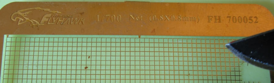

I started with a Flyhawk grid (0.8 mm x 0.8 mm) with has an appropriate distance and is not too coarse. Mogami117 shows details of cutting and bending: (1) After cutting from FH700052 (this is for 1/700 and not 1/350; I don�t care.) and (left) removing three struts
(2) In-plane bending
(3) Shearing with two pairs of tweezers
(4) 3D bending with the help of a tooth pick
(5) New part in place
Dirk

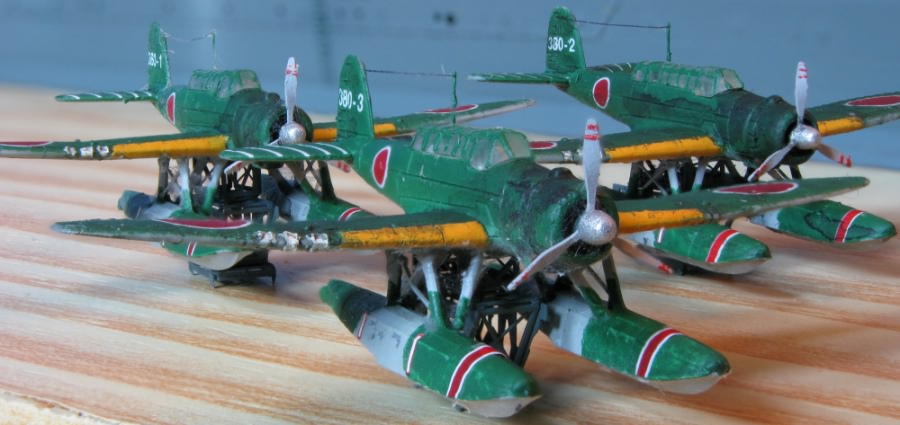

Here is more of my progress with the Petes:
Mogami118 and 119 shows two of them in the �normal� configuration.

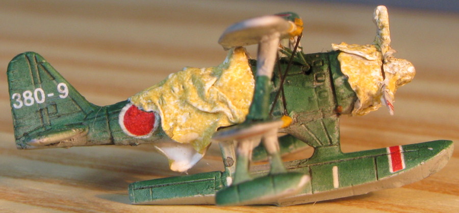

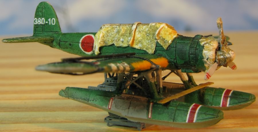

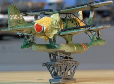

This time I also used the Hasegawa decals for the propeller stripes. With my Optivisor this is now possible. Mogami120 shows a Pete protected by PTFE tape (before appling it I airbrushed it with a thin layer of yellow/brown.). There are still some parts missing (color not dry) and I hope I can add this tomorrow. I want to prepare two Jakes and two Petes in this version. Dirk

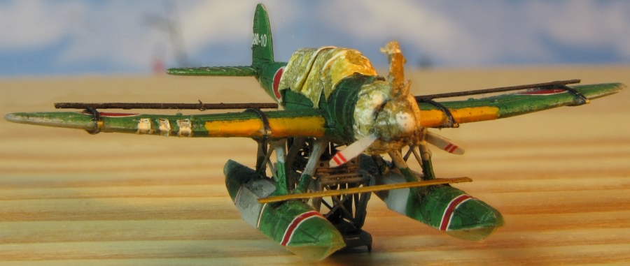

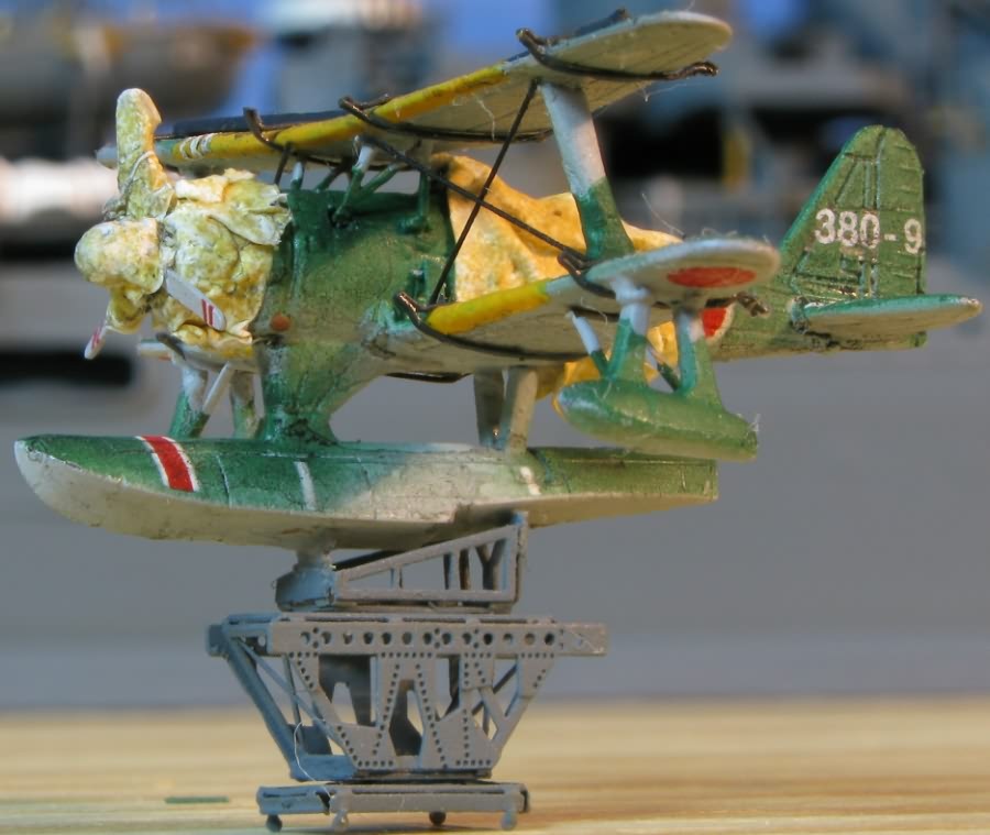

I added the support constructions to the wings of the Pete. I think this construction was used during cruising to protect the planes against damage from storm and heavy sea. As a guideline I employed the famous picture of Mogami showing her in July 1943 with 4 Jakes and 3 Petes on the floatplane handling deck. This picture can be found (digitally colorized) on the fantastic home page
http://blog.livedoor.jp/irootoko_jr
Dirk
Dirk

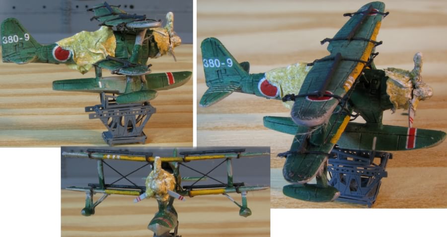

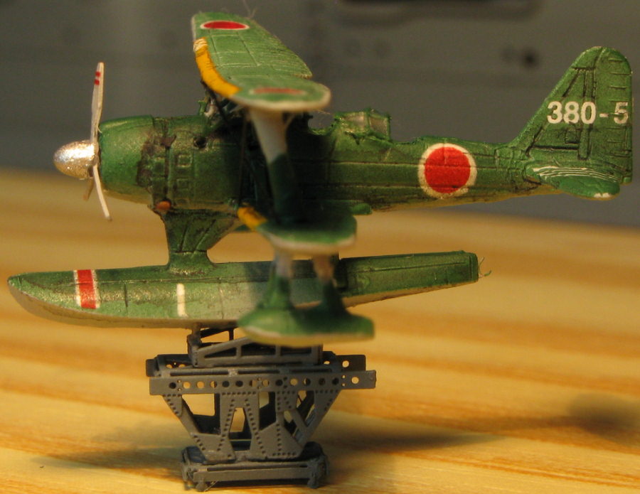

� and here a Jake rigged for cruising. In the 1943 picture of Mogami all visible 7 planes are prepared like this.
My intention is to have 2 Jakes and 2 Petes in this configuration and 3 Jakes and 3 Petes in the �ready for takeoff� state.
Dirk
