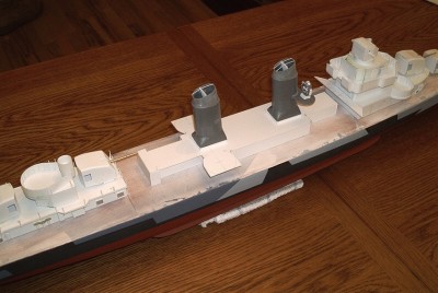

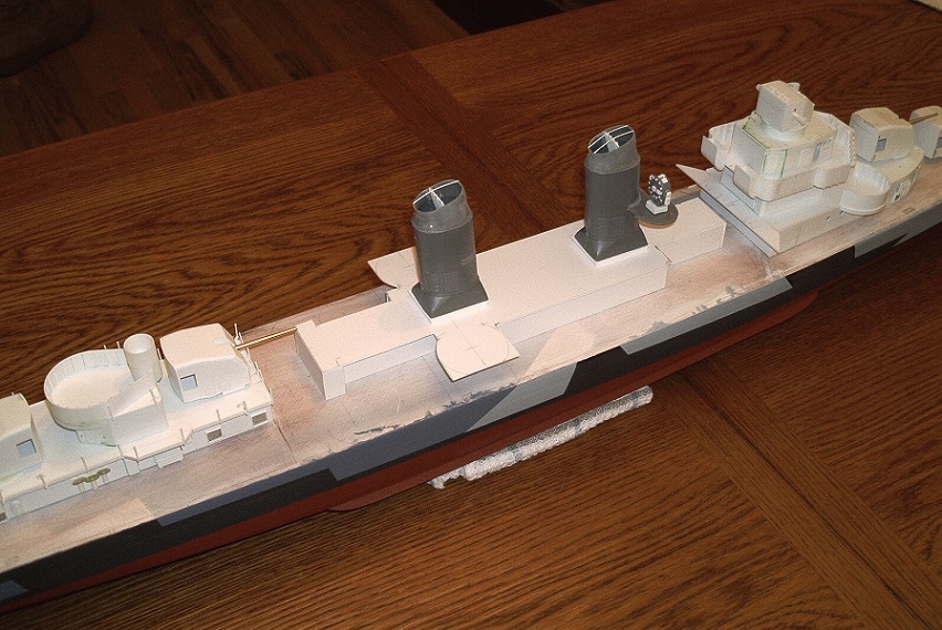

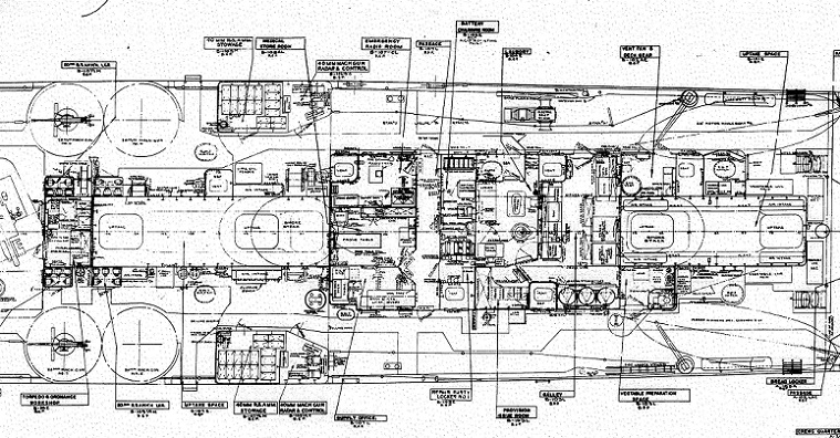

Roughing out the midships deckhouse begins. Slightly modified kit
funnels and searchlights are being used. Most bulkhead corner
joints will be rounded. Ammunition handling rooms below the Bofors
platforms have yet to be built. Fabrication of the interior structure for
the funnels has also begun. A Mk-51 Bofors director platform will be built
and installed on the aft funnel. The existing molded-on intake vents on
the funnels will be replaced. The main portion of the real deckhouse was
the galley. I am tempted to build a galley and open the watertight doors
but I fear despite the open doors the interior will not be visible and the
effort lost.

Thanks for the compliments, gentlemen!
Timmy, I really like the Lindberg kit. Sadly, the only parts that are
reasonably accurate in scale were the funnels, whaleboats and
searchlights.
Tim, the galley is very very tempting. Not sure if I will do it. If I do,
maybe I'll have some SOS cooking on the stoves.
If anyone has some good photos of a Fletcher's galley interior, please
send!

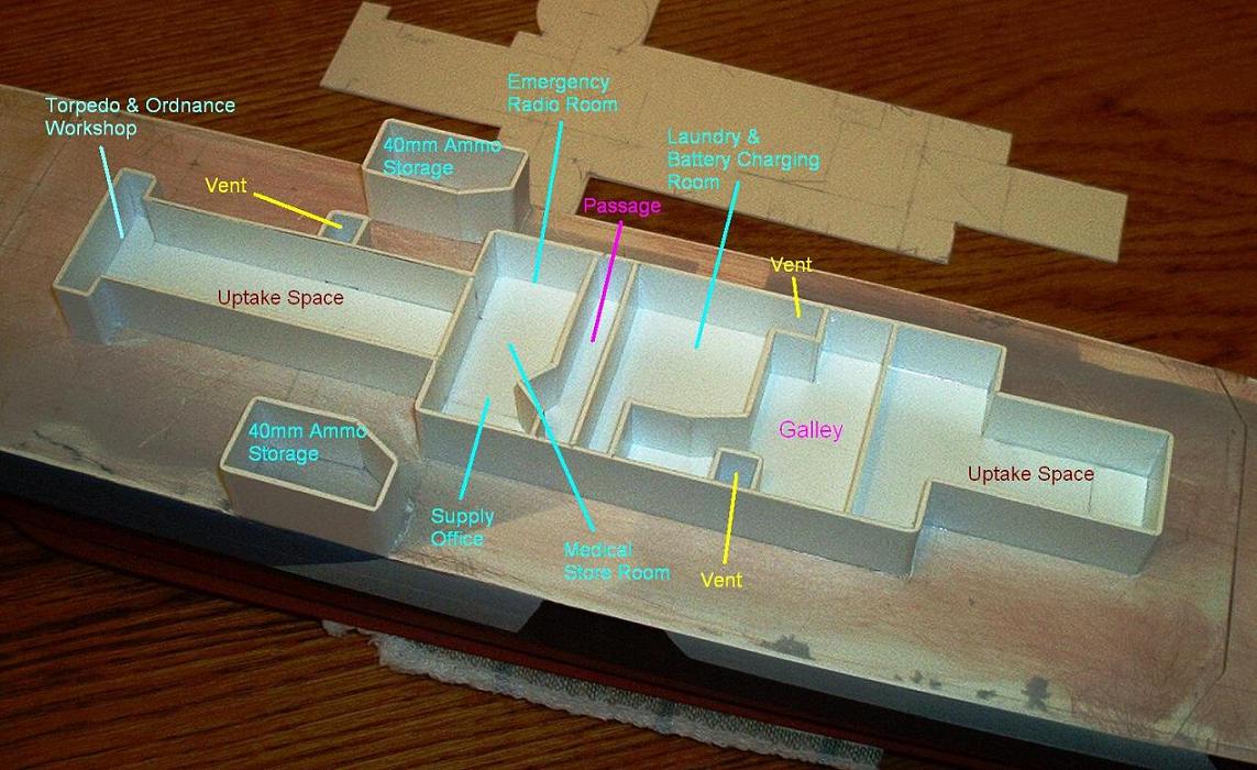

Midships deckhouse interior work has begun. Thanks to all who have
offered their help with researching details.
Helpful comments are always welcome!
