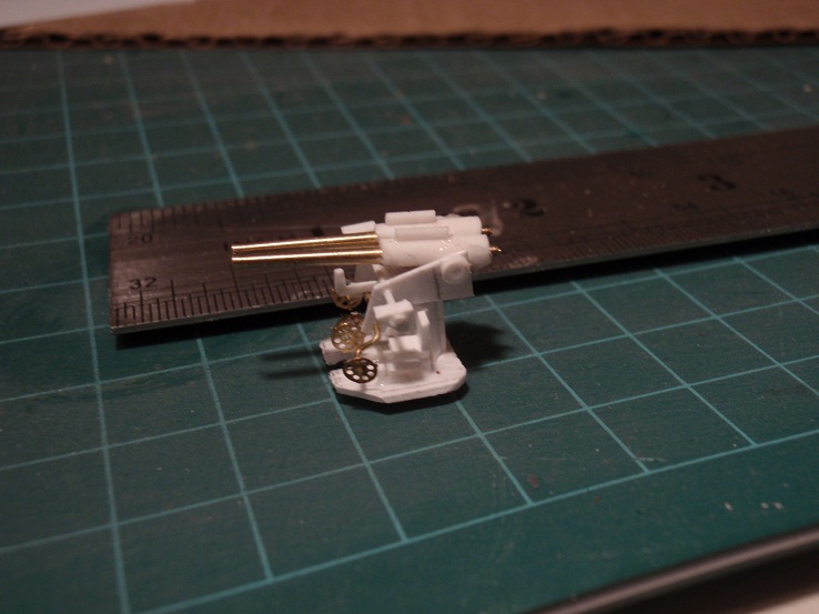

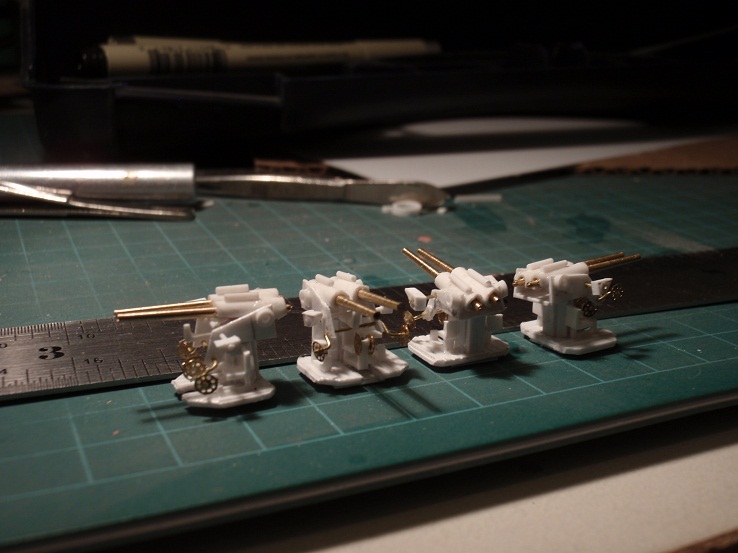

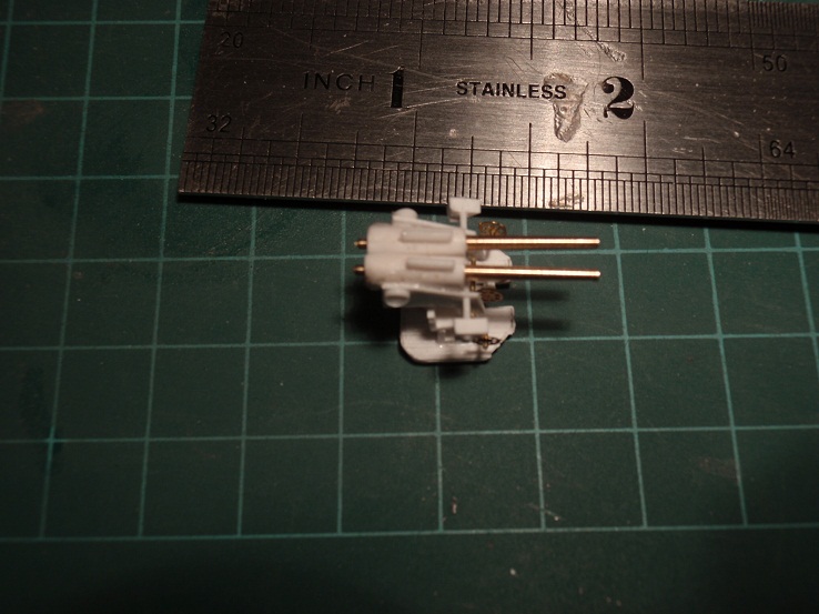

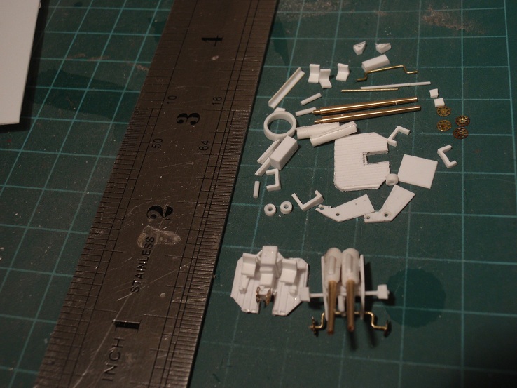

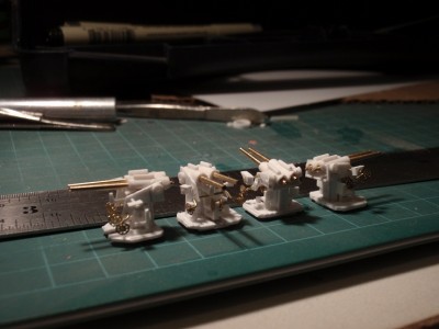

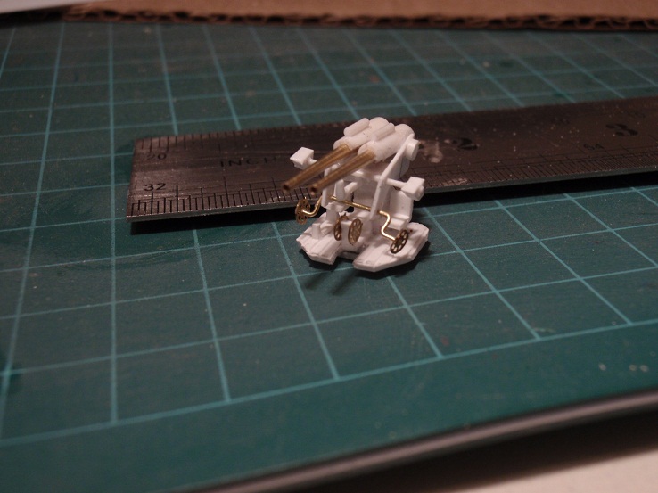

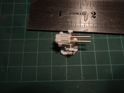

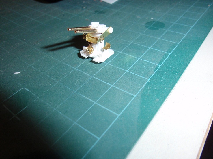

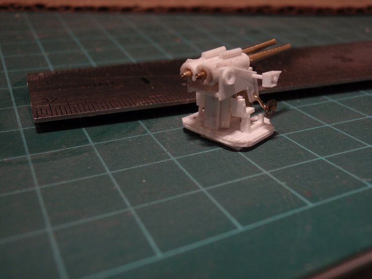

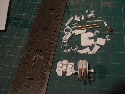

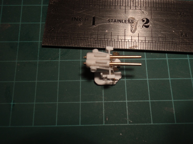

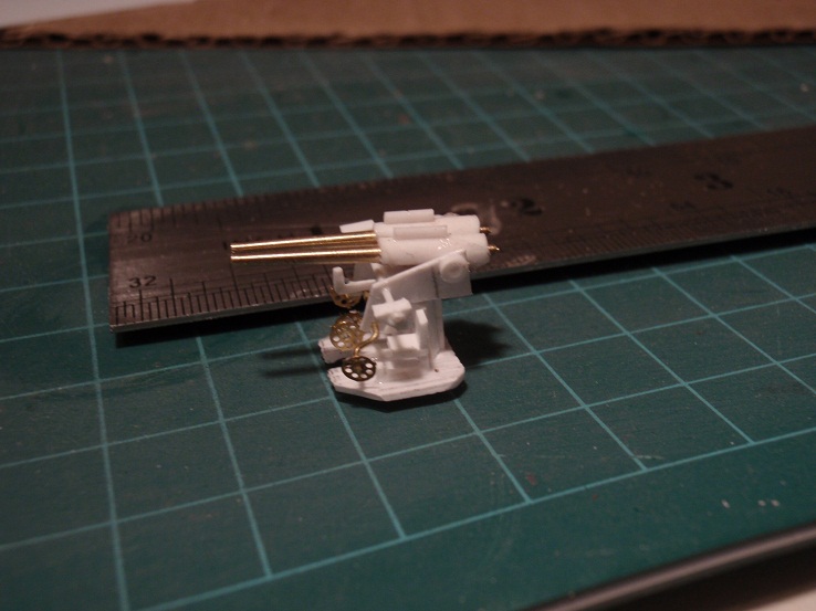

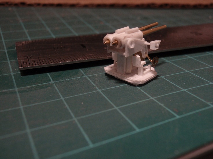

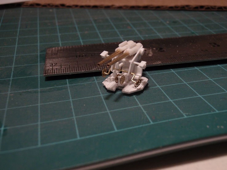

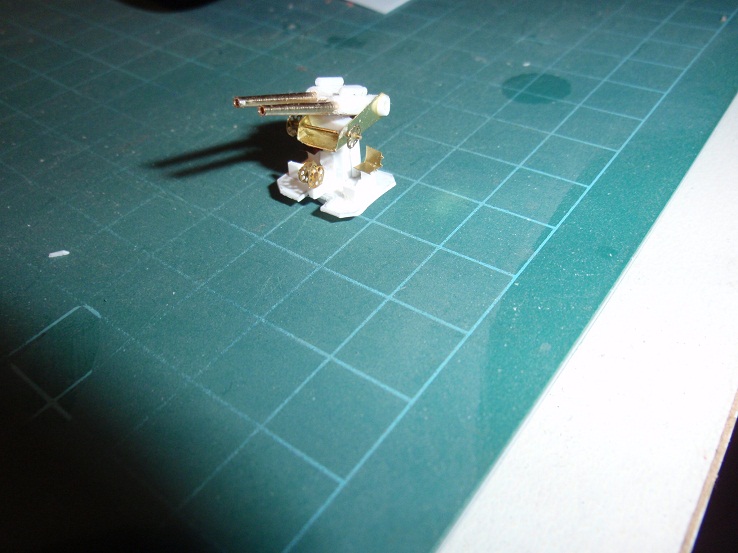

hello all,i took a brake from the hull for a while.built some 37mms ,i had no scale drawings only a basic outline on the plans and a couple of pics so i made one as a trial effort them modified the rest.they have photo -etch hand wheels and the barrels are some left over 57mm,s from my 1/192 jean bart build,they are darn close to the 37mm,s in 1/144.photo-etch and barrels in 1/144 are hard to track down.there are 40 pieces to each gun,there are 4 of these on sheer,thank god she is not japanese or there would probobly be a bunch of them.i found these a lot easyer to build from scratch than the 25mm,s on nagato that were photo-etch.just a little bigger in scale made a big differance.still small for my fingers.anyone know any where one can find 1/144 barrels.
this is my mock up to see how things fit
sub assembly and the parts for 1 gun
a few differant angles
all 4  37mm,s  together

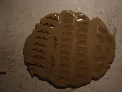

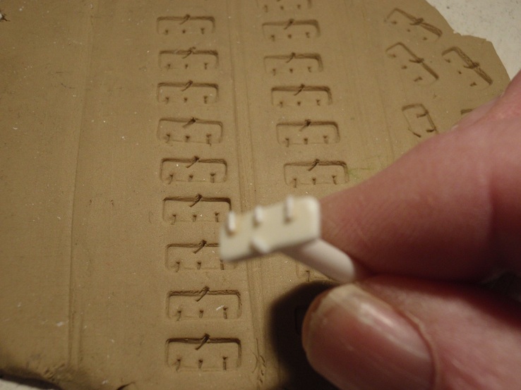

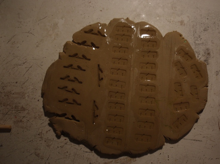

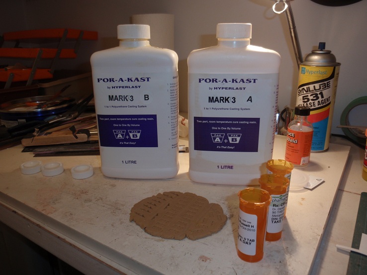

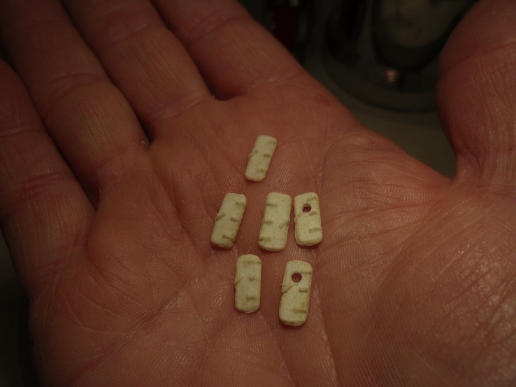

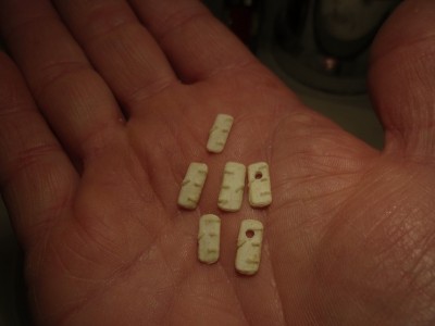

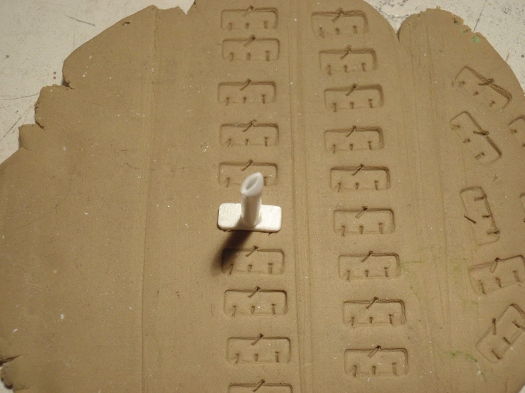

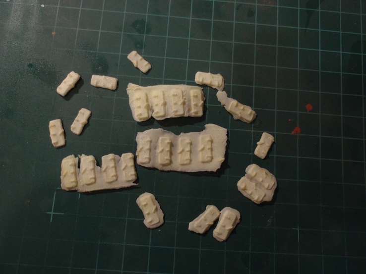

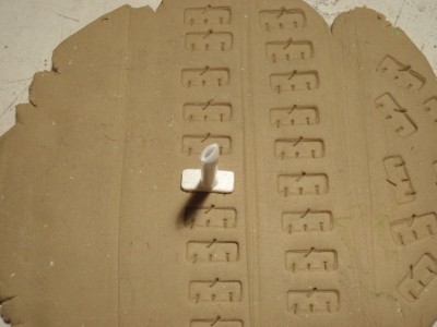

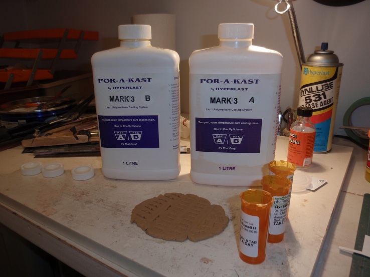

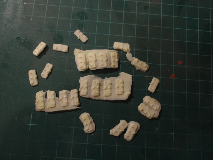

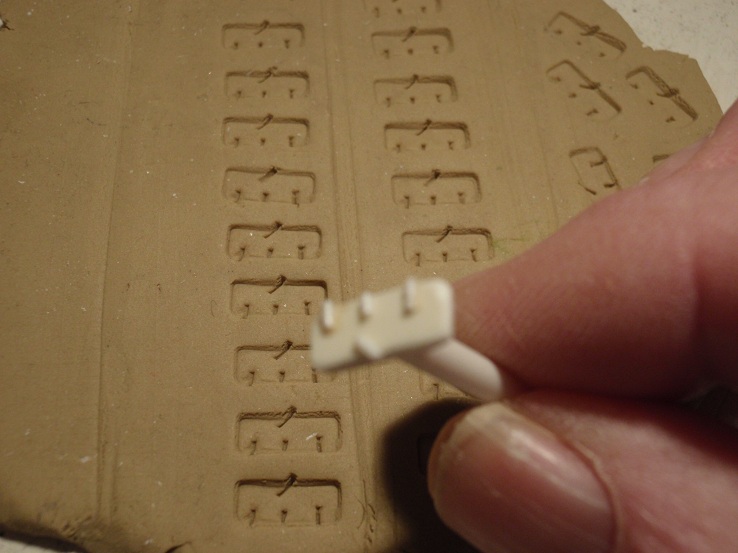

with all the snow it's a good day for modeling.i thought i would cast some doors today.instead of making a mould i used some playdough .i made a master and press'd it into it ,this way i could make all of them at once .came out pretty good .i used a toothbrush with soap and hot water to clean them up.they did clean up pretty good but next time i will use a plyable wax ,i did this before but i forgot what i used so i tryed playdough ,it's o.k but with wax one does not have to clean them in soapy water.
this is the casting resin,the same company makes the moulding stuff .they are both mixed 1 to 1 ,can behind is mould release
this is the resin in the playdough,after filling the doors i used a straight edge to take away the excess.
24 doors all the same ,some will have a porthole in them

A great idea! I have dozens of doors to build for my model, and I have been wondering how I will do it. There are several different types, and most are not available commercially. I have considered stamping them out of thin brass or making white metal castings, but this technique certainly is easier.
russclark
Posts: 1173
Re: 1/144 admiral sheer s.c. scratch build
Post by russclark »
hello phil,what works better than playdough it a soft wax,like what some cheese is coated with ,if you warm it up a bit it is fairly plyable.easy to push a master into it.also no need for mould release.

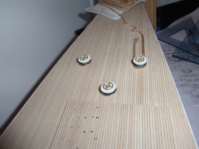

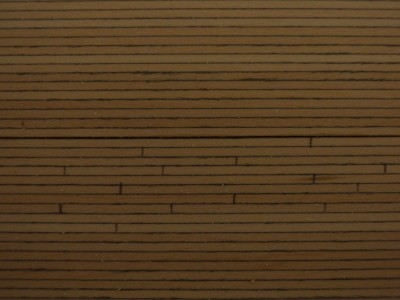

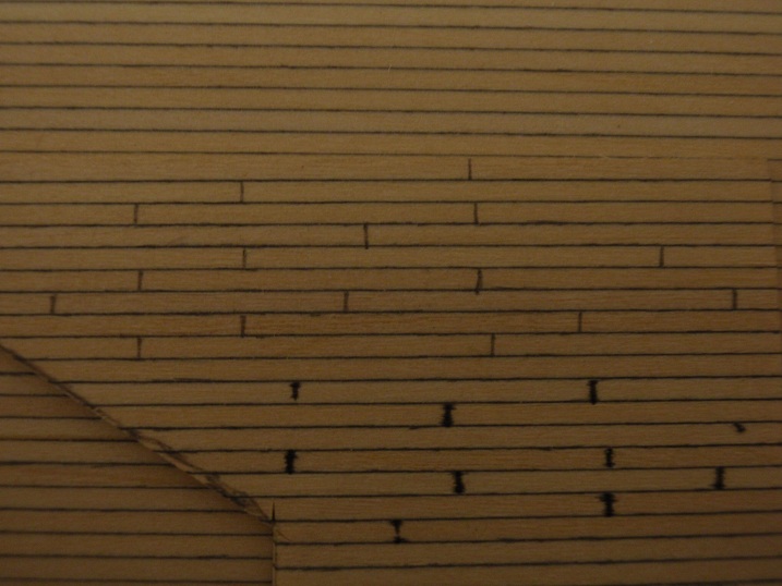

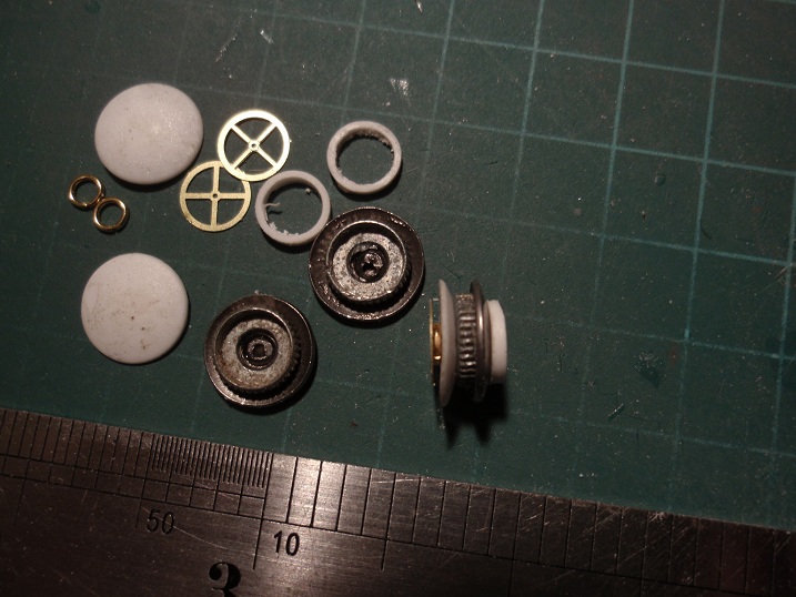

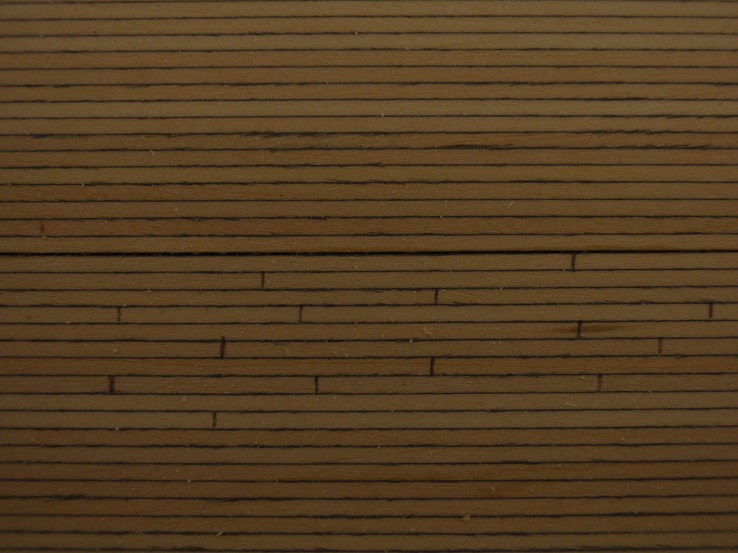

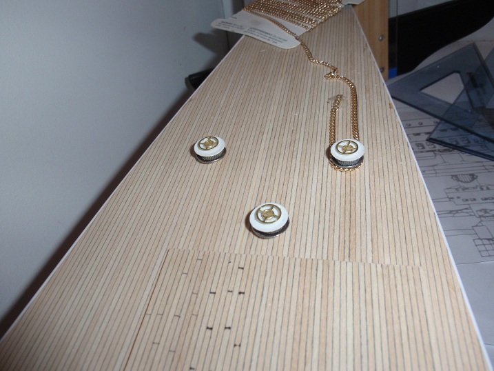

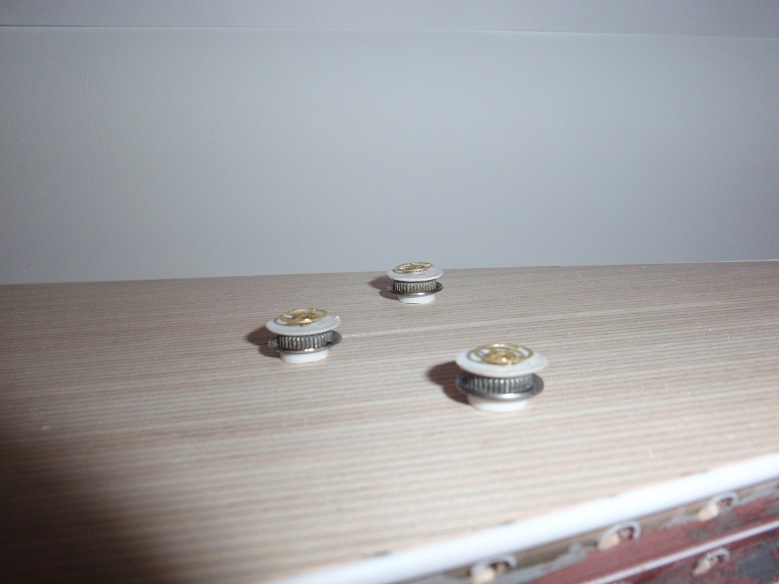

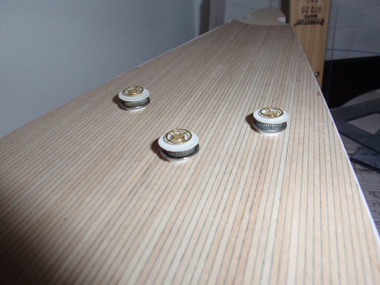

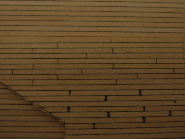

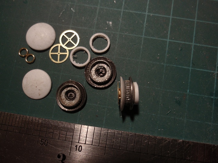

hello all,todays project was the build the 3 anchor capstians.i always look for things that will make a part but are somthing else.the winchs are made from thumb tacks, bic lighter parts, and the things you get from ikia for covering screws and one piece of photo-etch a hand wheel.all modified a bit . my decking has no plank end lines .i have two ways to do it one is a fine pen with black ink the other is a lead pencil.i picked the pencil it did not smudge, and is not as bold,also if i make i slip up i can erase it.
top is pencil and the lower is ink you can see how the ink smudged a bit
pencil done on a spot that is hidden
