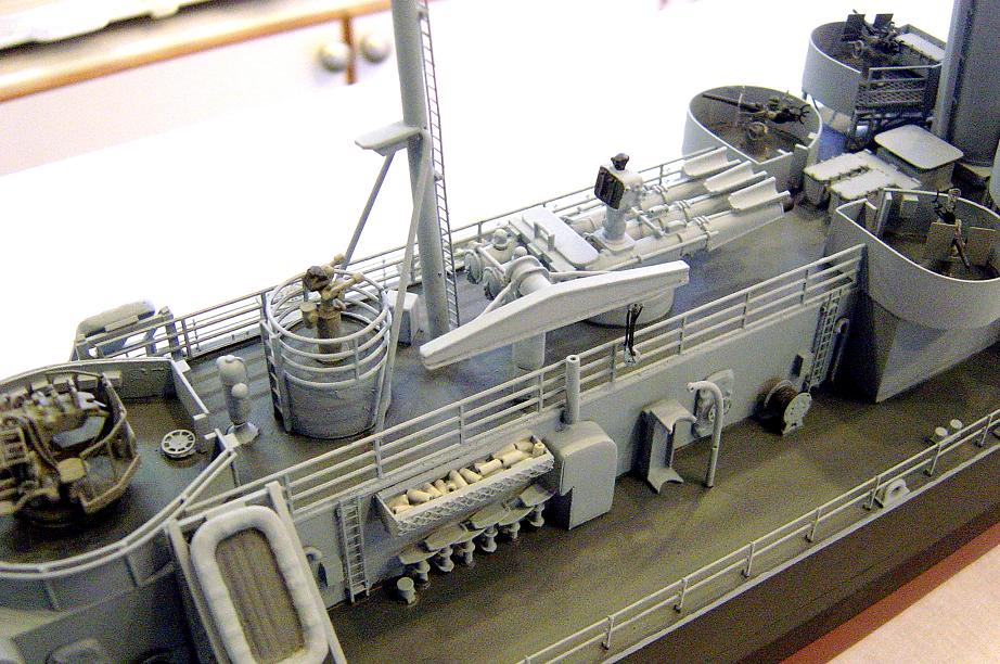

Ok.....Lets take a look at some details around the ship..........

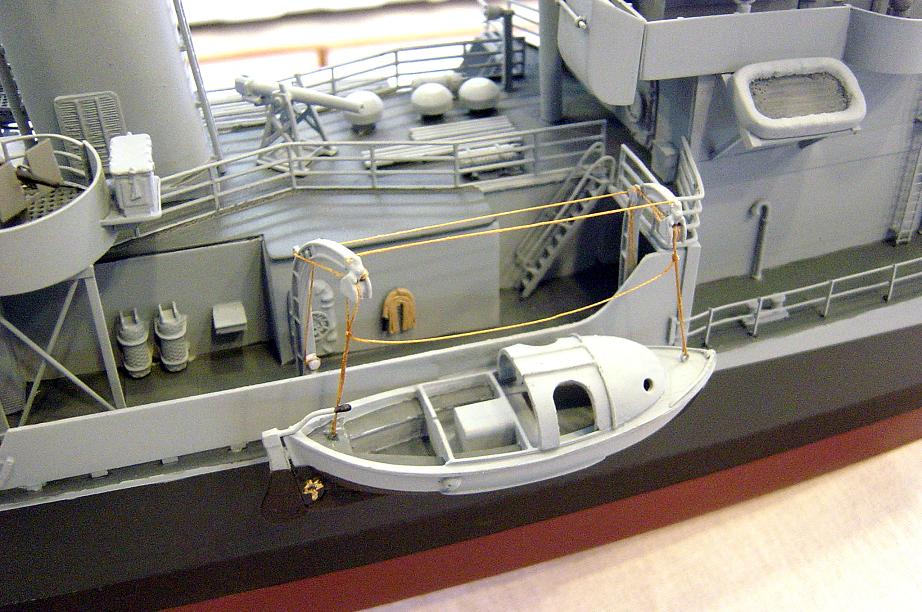

Good view of the 26' MWB here. Davits are cast metal. Note the practice loading machine just in front of the stack. Other details include a watch desk, cane fenders and draped firehose. Inclined ladder is p/e brass. I did some simple rigging here. I made the liferafts from cast resin.

Midships 20MM location here. Guns are cast metal while the other parts are p/e brass. Just behind the stack is a vent, then a spare barrel box, then two ready service lockers. I cast the w/t doors from resin and added the handreel, an HO freightcar brakewheel. Note the perforated deck on the fwd. 20MM mounts.
Same location from portside. Note the torpedo tube set-up. These are individual cast resin pieces. I decided to display them open. The nose of the torpedos are visible here, made from shaped wooden dowel. The base is scratchbuilt. The item on top of the tubes is the director. Other details on the tubes were added by me.

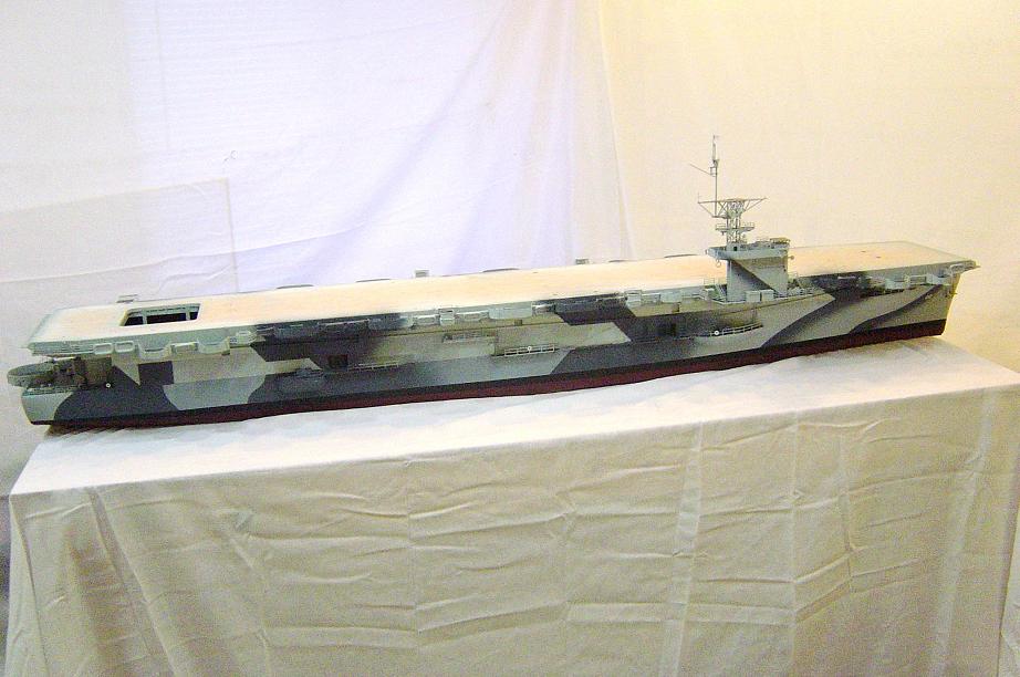

Hello again all :wave_1: Now that most of the construction on the CVE has been finished, I am ready to finish paint the ship. USS Guadalcanal was painted in Measure 32, Design 4a. This was another one of those '"dazzle" schemes. Used as a course, speed, and ID deception to submarines. There are several MS 32 designs. 4a incorporates straight geometric lines as well as shaded demarcations between the various colors. There are four colors,5-N,5-L,5-H and 5-P. I'll be using WEM Colourcoats enamels for the job. All areas are airbrushed with the exception of the decks which are brushed. The deck color is 20B. I mixed a one to one ratio of Tamiya German Grey and Light Grey for those. Lets take a look.......
Here is a drawing of how MS32/4a would appear. In researching this, I found that the stb. side of the pattern matches close to actual photos of the ship. The port side is a different matter. It is quite a bit different than the drawing. This leads me to believe that the drawing is a general guideline, rather than followed exactly.
Here is CVE-60 in January of 1945, anchored at Mayport NAS here in Florida. Compare this photo with the drawing. You'll see it's fairly close.
This is the replica. The pattern is rather involved and takes some time to do, as one color needs to dry before adding the next. The WEM paints dry much slower than acrylics. I would rather airbrush enamels anyway, as acrylics can be difficult. I started by painting the whole ship in 5-L, adding the next color in turn. I did the 5-N last, because of the shading, and it is the darkest color.
The carrier again, June 4, 1944, alongside U-505. Note the pattern here is quite different than the drawing.
Heres another portside view.
And again, the replica. I think this is pretty close. Can't really see the pattern that well in the photos. Also, being black and white and very old, it's difficult to distinguish colors. A best guess scenario on my part.

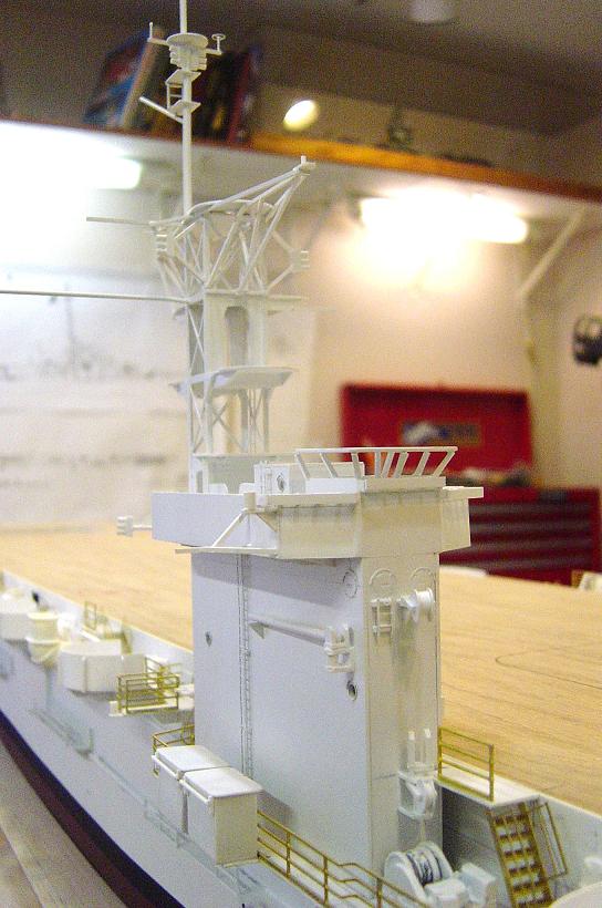

Next, some views of the Island assy.....
Radars yet to be added,as well as searchlights and other small details.
