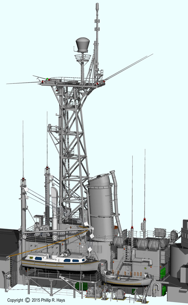

Here, finally, is a picture of the two 7th Fleet boats in position on top of the missile house.
I found blueprints for all of the ship's boats (and a LOT more) in the Barbour Boat Works collection at the East Carolina University Joiner Library:
viewtopic.php?f=52&t=155093
Barbour Boat Works built a lot of different small craft for the Navy, and it is the Barbour collection that is in the library, but the basic hull design came from the Bureau of Ships. The drawings were prepared by W. R. Chance and Associates in Washington, D.C., and William Garden in Seattle. Some of the drawings were from Bryants Marina in Seattle.
So it is possible that the basic hull design was used for other boats and by other companies.

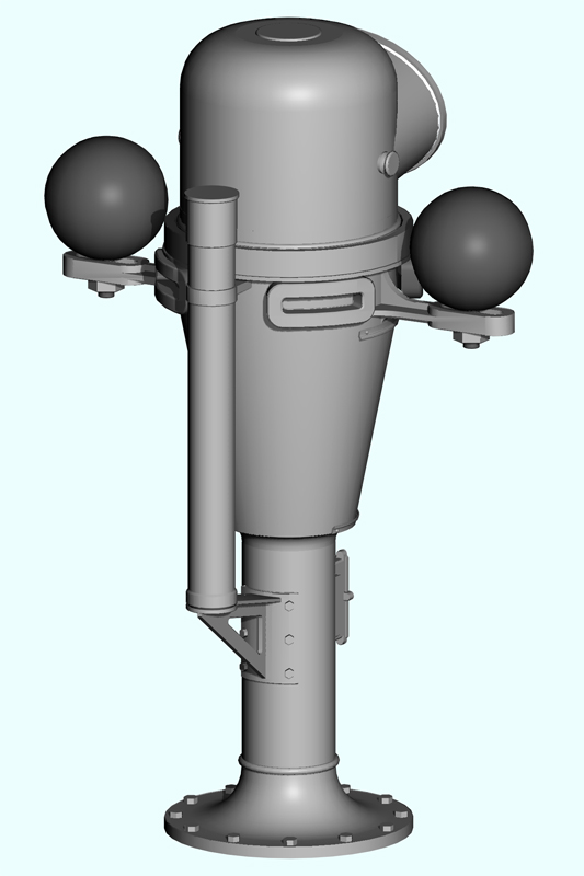

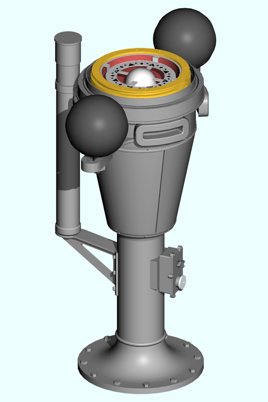

Things have been a bit slow lately on the Virtual Ship Modeling pages, so I thought I would post an update.
A detailed ship model has thousands of individual assemblies, each a modeling project in itself. Here are pictures of the ship's binnacle (compass stand). Binnacles evolved from wooden boxes to house a magnetic compass to the far more complex versions found on mid 20th century ships. The OK City's binnacle was basically a WWI vintage design with electromagnetic compensation coils added to the outside. It had a removable hood.
When steel hulls came into service in the mid 1800s they played havoc with the magnetic compasses. The large iron balls (the "navigator's balls") were added to allow some compensation for the magnetic field of the metal hulls. The balls were moved in-out to fudge the ship's magnetic field to reduce interference. Later the four electromagnetic coils were added to allow more precise adjustment of the ship's magnetic field.
Adjustment of the compensation devices was done while "swinging ship." The ship would be positioned in a harbor with known geographic reference points. The ship would be turned so the bow pointed at a known reference point - giving a known true heading. The compensation devices were adjusted until the compass indicated the true magnetic heading. Of course the local magnetic deviation had to be taken into account. Then the ship was swung to point to another target of known position and the process was repeated, until several points in a circle were used. This tended to average out any peculiarities from a single heading.
The ship also had gyro compasses - they too were aligned by swinging ship - and that is what we normally used for navigation. But in case the gyros failed there was still the old fashioned binnacle. I wonder if modern ships still have magnetic compasses?
The OK City's binnacle was originally (1960) on the after superstructure below the radar tower - just above After Steering. But by the 1970s that After Steering position had been eliminated. The binnacle was moved to the forward superstructure on the deck above the pilot house.

We called the compensating devices "Navigators Balls".

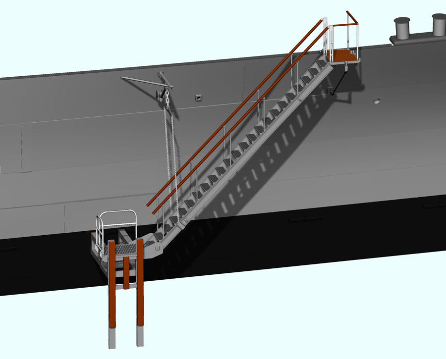

I have been pretty busy with other things lately and haven't had much time for CAD modeling, but I finally got around to figuring out the ship's accommodation ladders. I say finally, because it has taken me years to find photos of the ladders used on the USS Oklahoma City CLG-5 while I was aboard.
Part of the problem is that I have blueprints for the ladders used on the CLs and early CLGs. Five blueprints and no two are alike! Then I found some pretty good photos of the ladders in the early 70s - and they are different from the blueprints in many ways!!
What you see here looks like the early 70s photos, with dimensions taken from the blueprints where things were about the same. So this is a best guess.
Although I have modeled the ladder along the forward side (there was also an after ladder that was a bit different), my real reason for modeling it was to get the pieces. The various parts were stowed along the sides of the missile house, under the midships boat decks and on the side of the forward superstructure. They are very visible details. Now I can finish the missile house and the midships superstructure.

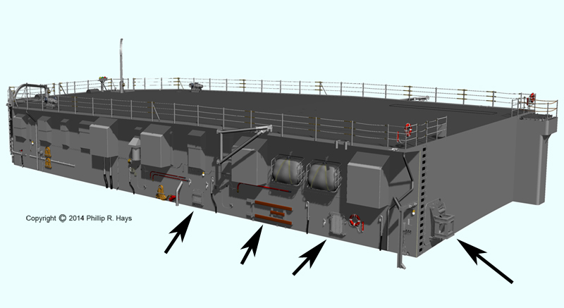

Here is a picture showing where some of the parts of the forward and after accommodation ladders were stowed on the missile house.
Now the missile house is done - I think. I have been working on it for four years. While studying photos showing the ladder parts positions I discovered I had left out one of the fuel tank vents. I also found another minor error. So maybe it's finished, and maybe I'll find another correction someday.

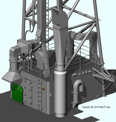

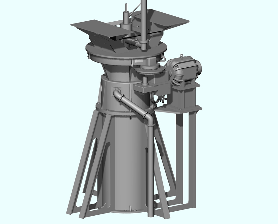

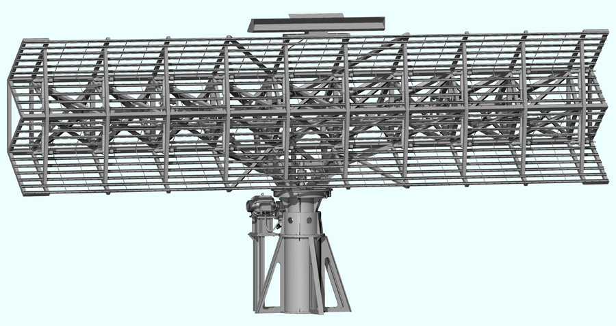

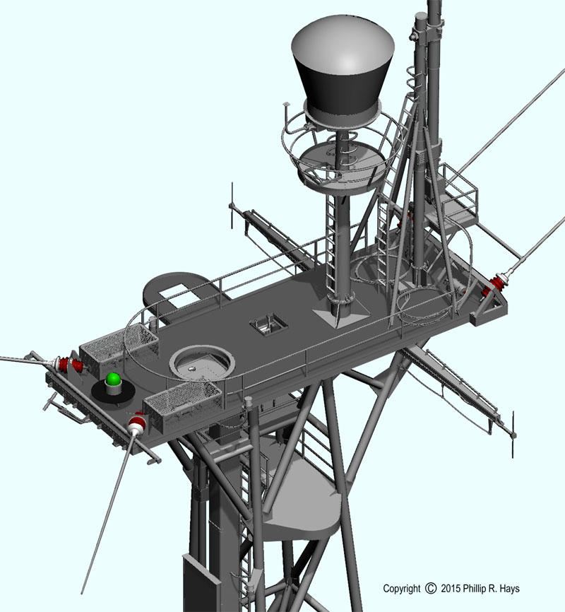

Here is another update.
I have finished the midships tower. The original work was done about 10 years ago. Since then I have found several high resolution photos showing much more detail. I just went over the entire model and updated it, adding details and refining the CAD drawing (I have learned some better techniques over the last 10 years).
The tower originally (1960) carried a AN/SPS-39 3D air search radar antenna. The ship was very top heavy so this antenna was removed in 1967. The AN/SPS-30 3D air search radar on the after tower made the SPS-39 redundant. Several other antennas were moved from platforms on the tower to other places lower on the ship.
One interesting feature is the rotating stub mast at the forward end of the top platform. Cramp Shipyard in Philadelphia was upstream from a bridge that was too low for the ships to pass under unless the top part of the mast was hinged down horizontal. Some pictures showing how this worked are posted here:
http://www.okieboat.com/CAD%20radar%20towers.html
At the base was the Radar V compartment where the SPS-39 equipment and other equipment was housed. This was an armored compartment and originally had an armored door. But somewhere along the line before 1971 the door was replaced with an ordinary water tight door.
I needed the tower to finish the midships superstructure. Well, it is almost finished. I still need to decide how the boom vangs will be rigged for the boat booms. No two photos show the same arrangement.
Next will be the forward superstructure. It is a lot simpler than the midships structure!

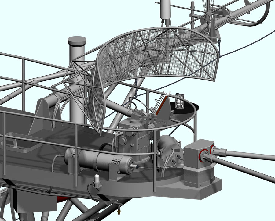

I have started on the forward superstructure - the last major part of the ship. But first I wanted to finish the forward radar tower. This is the very first part of the ship that I drew in CAD, so I could determine the lengths of all the tubes (the tower sides are angled, so you can't determine the actual lengths from the 2D blueprints).
Since I first drew it in 2008 I have become better at using the program and I have changed the way I draw things. So I have redrawn almost all of it.
The image shows only part of the tower. It is a maze of tubes, pipes, cables, spars, platforms, etc. There are 49 different antennas on the tower! Right now I am adding the wave guides for all of the radars, ECM antennas, etc. After that there will be a bazillion cables connecting all of those antennas and lights to the ship below.
To be continued ...
To be continued ...

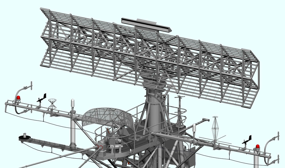

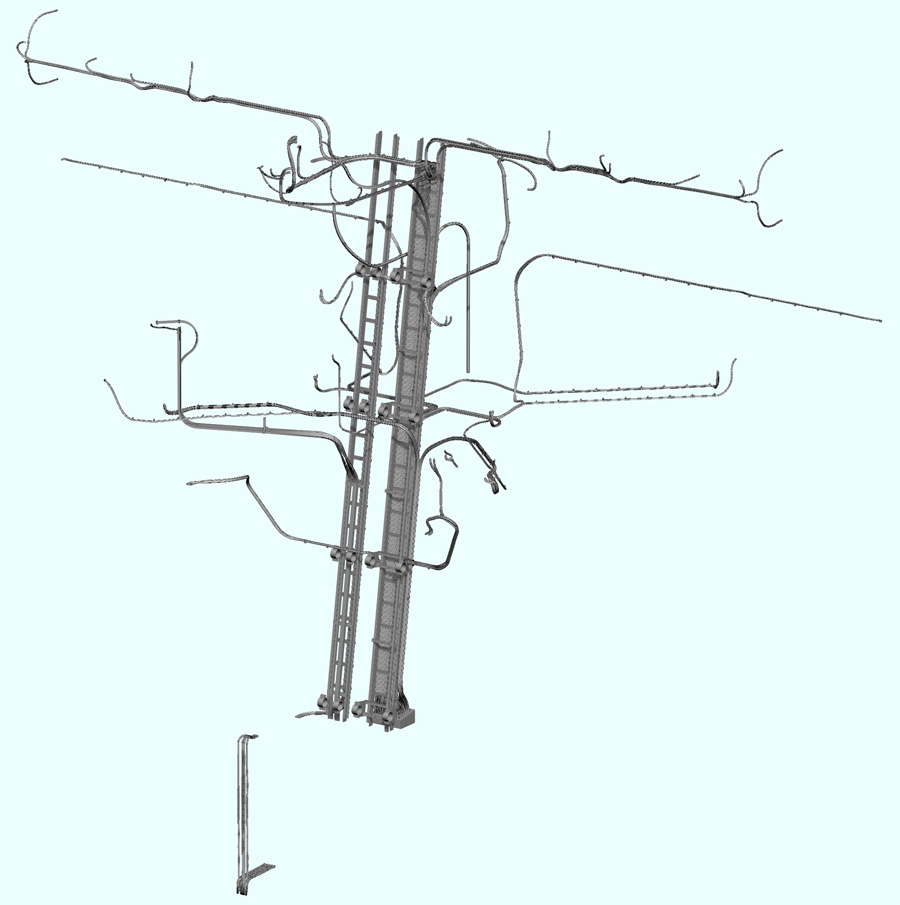

Well, I have finally finished the forward radar tower. At least it is almost finished - I am always discovering something new as I look at photos so who knows what will come up next?
The original 2008 drawing was done from blueprints and some fuzzy photos. Since then I have discovered high resolution images that show a lot more detail. Some things, like the water washdown system, weren't constructed the way the blueprints showed them. This was obvious from the high res photos. The rats nest of wiring was done almost entirely from the new pictures. Each antenna had from one to four cables, and there are a lot of antennas! I have data sheets for most of the antennas and they tell the cable sizes and numbers.
There are 46 antennas on the tower and the ECM shack. I found drawings and photos of most of the antennas, tuners and antenna couplers, and even things like insulators and antenna switches, so most of these models are pretty accurate - down to the pressure gauge on the TN-229/SRT tuner! However, while looking at the new photos I discovered yet another antenna, and I haven't figured out what it is yet - so there is a bit more work to do.
The OK City had the most extensive electronics intelligence and countermeasures of the CLGs - equal to or better than most other ships. The antennas on the "cloverleaf" half way up the tower were mostly ECM, and the framework hanging off the sides of the O6 level ECM shack (the wide compartment at the base of the tower) carried more antennas. The "spooks" recorded and cataloged every radio and radar transmission they detected as we passed down the coasts of Korea, China and Viet Nam, and could identify each by their unique "fingerprints." This gave a good estimate of the capabilities of their weapons and surveillance systems. It also helped us track North Vietnamese radars so we could fire TALOS ARM (anti-radiation) missiles at them.
They could also detect whenever a jet engine started up on North Vietnamese airfields using the then top secret jet engine modulation of RF signals. We often knew a MiG was taking off before it's wheels left the ground. Some of the ECM gear was able to take control of enemy anti-ship missiles and make them fly over us. Some of it detected Soviet IFF (Identification Friend or Foe) signals and allowed us to interrogate North Vietnamese aircraft and have them tell us where they were. It was pretty advanced technology for the 1970s.
Here are some images showing a lot of this detail. The forward tower is the single most complex part of the model, and I am glad to finally have it (almost) done. The file is 51 megabytes with 177,506 objects and 1,299,808 points. I need to redo the AN/SPS-43 air search radar - I have much better data and photos to work from now. And then I'll finish the forward superstructure - a fairly simple task. Then all that is left is to add life lines and the wooden deck to the hull, and put all of the pieces together for a family portrait! Maybe sometime before the end of this decade!

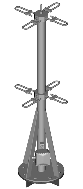

Does anyone know what this antenna is? It was common on cruisers, DLGs and other ships in the 70s. It was on the top platform of the forward radar tower on the OK City. I only discovered it recently while looking ay some photos. Most pictures are from a distance and it is obscured by the AN/SPS-43 radar base in most photos. I think it was added about the same time the AN/SPS-30 was installed on the after radar tower in 1963.
I would like to know the antenna name/designation, dimensions (it is about 5 feet tall), frequencies and what it was used for.
Thanks.

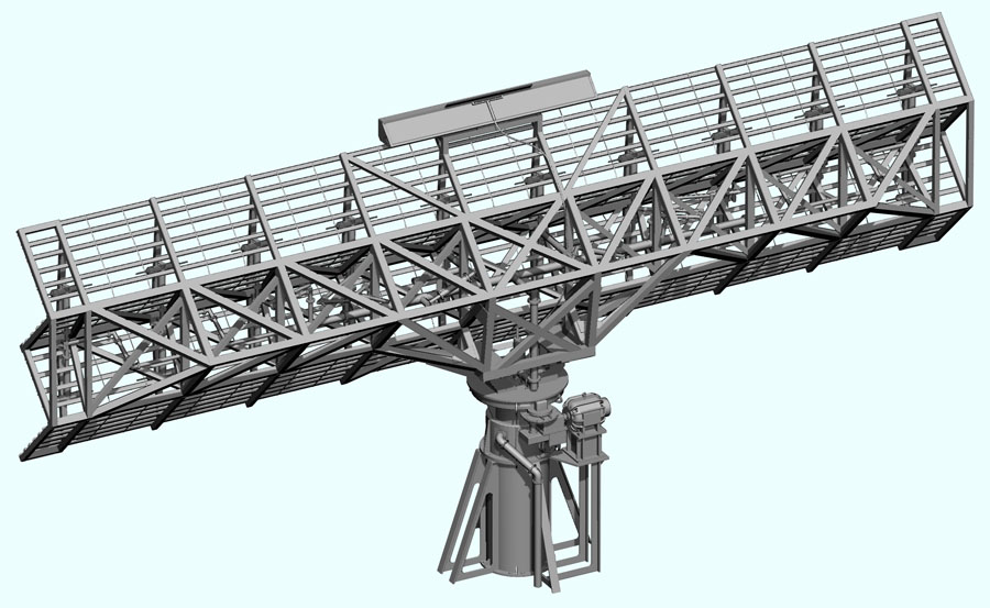

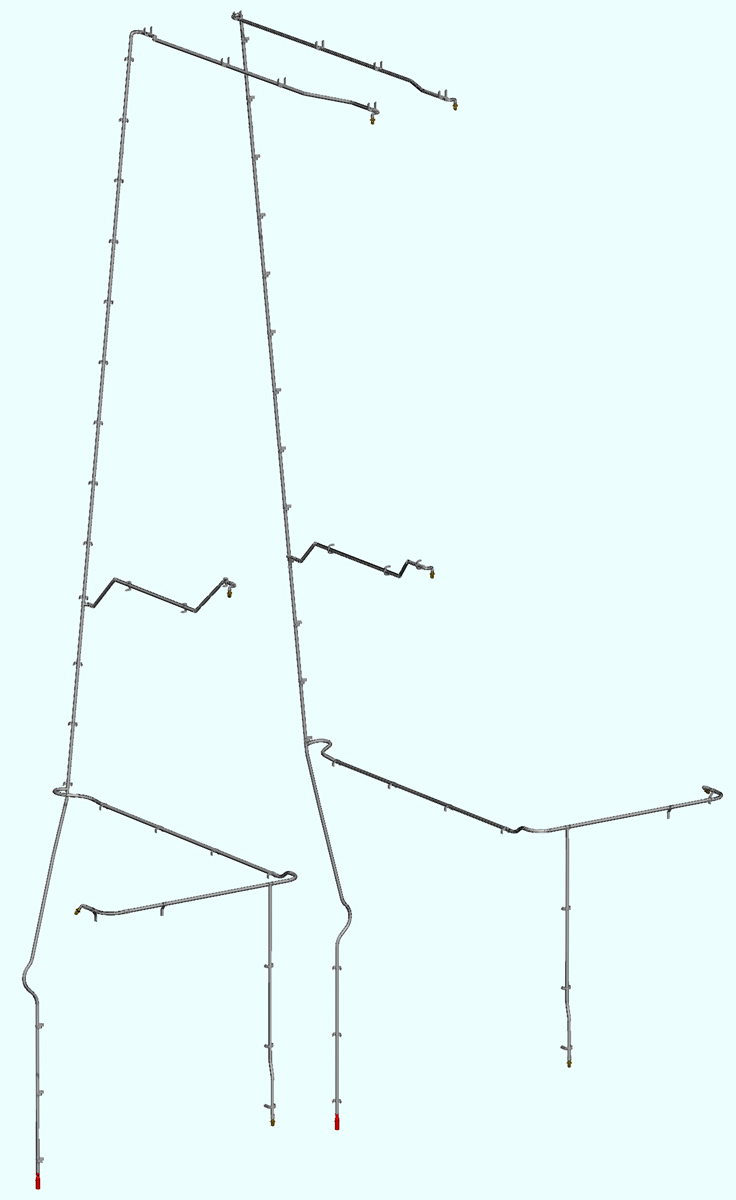

I have finished the AN/SPS-43 air search radar antenna. My first attempt was back in 2005, working from a few fuzzy low resolution photos. It wasn't very accurate. Since then I have obtained several high resolution pictures and a basic data sheet with dimensions. This version is pretty accurate.
The waveguide plumbing was tricky. I had to examine several photos taken from different angles to figure out all of the angles and sections. By using different lengths and diameters of waveguide the same amount of energy went to all ten sets of radiating elements. The received signals from all elements were combined in the waveguides to produce a single return pulse.
This completes the forward radar tower. Now I can continue with the forward superstructure - it is much simpler than the midships and after superstructures.

Here are some pictures of the fore top with the new AN/SPS-43 antenna in place.
