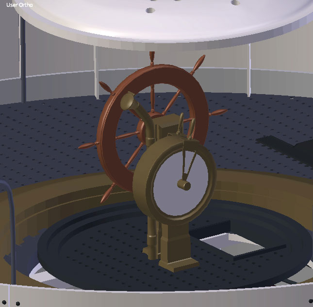

Thank you everyone for all the information, it's really helped. I'm thinking that Phil was right too. I've put in a telegraph that is about the size indicated on the plans. I've also included a speaking tube. I'm still not sure on that serrated-looking vertical thing. I'm thinking that, as Phil said, it's some kind of mechanical regulator, but without knowing really what it looks like, I'd rather err on the side of established design and put something in that people will recognize more readily. so I've left that out till some more info pops up. Again, if anyone can find any info, I'd be grateful! I've followed the plans as to placement and size, but it does look odd compared to other examples I've seen for other vessels. I'm wondering if Ericsson came up with one of his custom wonders for that bit of the monitor.
On a separate note, I've done most of the modelling. There might be some final bits and pieces (I've got to rig the lifeboats), but the major part of the modelling is complete. On to texturing!!
Owen

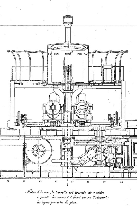

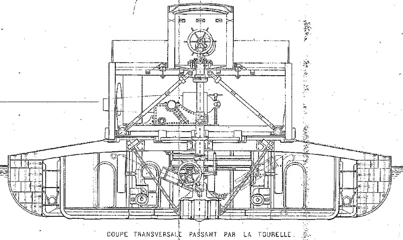

Here are some images from a French monitor plan. It is labeled "Monitors Light Draught Plan General" and "Cherbourg le 20 aoul 1867." The pilot house arrangement is similar to the pictures posted earlier. It appears to have a second conning station below decks with a helm and EOT.
You show a relatively modern EOT in your model, but I doubt that it had such a thing. The monitors were very early steam ships and there were likely many different methods of communicating engine orders in ships of different types. The modern EOT would have evolved later.
I looked for the history of engine order telegraphs and found a little information. A British patent No. 2384 was issued in 1870 to the Chadburn Company which produced EOTs well into the 20th century. The earliest US patent was No. 184,774 "Improvement in Apparatus for Transmitting and Receiving Signals &c," issued in 1876 to a British fellow.
A picture posted earlier appears to show a rack and pinion mechanism. A wheel (not lever) in the pilot house would have a pinion gear at the center. This would engage the rack gear to cause the vertical shaft to move up and down. If the shaft had a similar rack and pinion at the bottom it could rotate a lever or wheel to indicate the engine order. The monitor drawings show a wheel and not a lever in the pilot house, although they really don't show much detail of any sort. I would guess that these early systems just used a simple wheel.
It will be interesting to see if anyone can find a drawing or photograph of a monitor pilot house that actually shows the EOT mechanism.

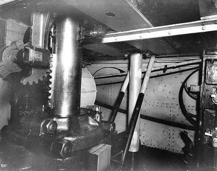

In the original USS Monitor Ericsson brought control inputs out of the (rotating) turret using square rods running in vertical keyways machined into the turret shaft. In the later monitors, where the turret shaft was fixed, he seems to have stayed with this practice. This is the type of linkage that may be shown in the image Roscoe posted above.

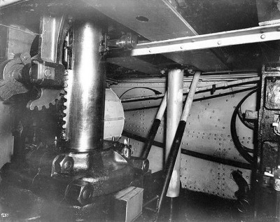

Here is a photo taken underneath the turret of the USS Catskill, showing a couple of outputs. Note the rack and pinion. I think the rack slides up and down and drives the pinion.
This picture appears upside down in "Old Steam Navy," where the author characterizes the quarter pinion as part of an appartus installed in the late 19th century to lift the turret hydraulically. This turret-lifting conjecture is wrong, because the same gear appears in a civil war era photograph of the USS Camanche. So what is it?
It would not be surprising if Ericsson devised direct engine controls for the pilothouse, like those we would expect to find in a locomotive cab. The turret was mounted just ahead of the boilers, so he could have easily fashioned a steam valve control.
There would need to be an additional, strongly leveraged control for the reversing gear. Maybe that's what the handwheel does, via a rack and pinion or a worm drive. By controlling the reversing gear, the handwheel would provide control of both boatspeed and direction. Zero position is stop. Full rotation in one direction is full speed ahead. Full rotation in the other direction is full speed reverse.

Post by DrPR »
Michael,
That is a great picture. Clearly, the rack and pinion is driving a shaft exiting to the left of the photo.
Look at the size of the gears and bolts! The size of the wheel in the drawings is pretty large - you would need a large diameter to get the mechanical advantage needed to move all of that mass!
I think the French monitor plans came from this site:
http://www.servicehistorique.sga.defens ... tebato.php

I've been looking at the blueprints and the photo. (do you have any more of the interior of the Passaic?)
That does make sense. You can really see the form of the thing and the linkages in the French plans. The one on the American plan seems to be a simplified version of that. It looks like there is some round form behind the wheel on the US plans, like there is a disc behind the wheel (with markings and an arrow that show the setting?). I can see how the wheel for the engine telegraph is off-set and drives the vertical mechanical gear. The only thing I'm not sure of is the form of the top of the housing on the US one. It looks slightly different from the French one, like there is some kind of metal 'hood' over the top of the unit. The French one looks like a more refined version of it. It's much more mechanically 'transparent' as to what goes where though. I'm trying do some sketches to get a viable form together for how the US one is different. When I get something that looks like it would work, I'll post it.
I am tempted to just model the French one. I can see clearly how it works and goes together, it's a lot more detailed than the one on the US plans and it might be more accurate to what was actually built than the US plans as well. I say this as it's possible that the French drew up their plans from an actual set of gear from an existing US Monitor, while the US Plans were done before the ships were constructed in the first place. I'd feel more comfortable getting something that is clearly defined as to what it is for the period, than making up something that MAY be like it was on the original and later winds up to be completely wrong to any vessel of the period.

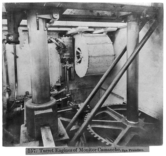

Same sub-turret apparatus in the USS Camanche. A more proportionate photo.
The pinion is fitted but the rack is not -- or not yet.
The Camanche was, in effect, assembled from a big kit shipped to San Francisco, and several photos show it in the process of assembly. This might account for the missing rack. Another explanation, from "Old Steam Navy" is that the Camanche kit, before it was shipped to California, was cannibalized for replacement parts for Monitors damaged in combat in the East.
The output on the right , picked-off as usual from a vertical slider, is the turret engine reversing control.

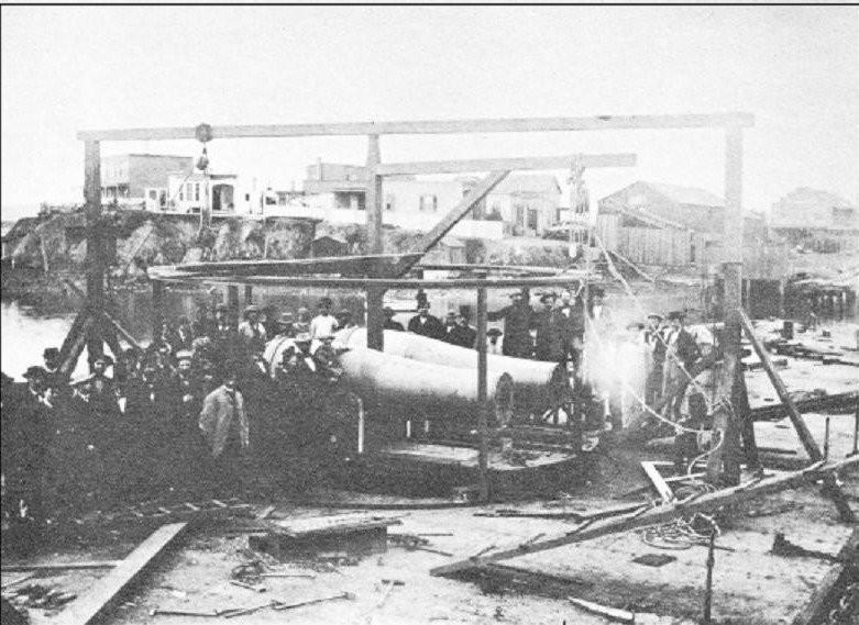

The is the Camanche's turret under construction. This photo was taken by Carleton E. Watkins, and appears in Vischer's Pictorial of California, published in 1870. The Henry E. Huntington Library has this book, though I have not seen it. There is a copy for sale on Abebooks for $27,500. Apparently the photographic prints were actually corner mounted into the book. Only a small part of the book treated the Navy. Still, it would be interesting to see. There is a Carleton E. Watkins site. He was in the business of making stereo views. Here is one of the Camanche:
http://www.carletonwatkins.org/views/hi ... 0679bl.htm
It occurs to me that because the USS Camanche was shipped to California for assembly, there might be in California a collection of these documentary photos of this monitor under construction. If so, this could be very helpful in the scholarship and CAD reconstructions we are doing here.

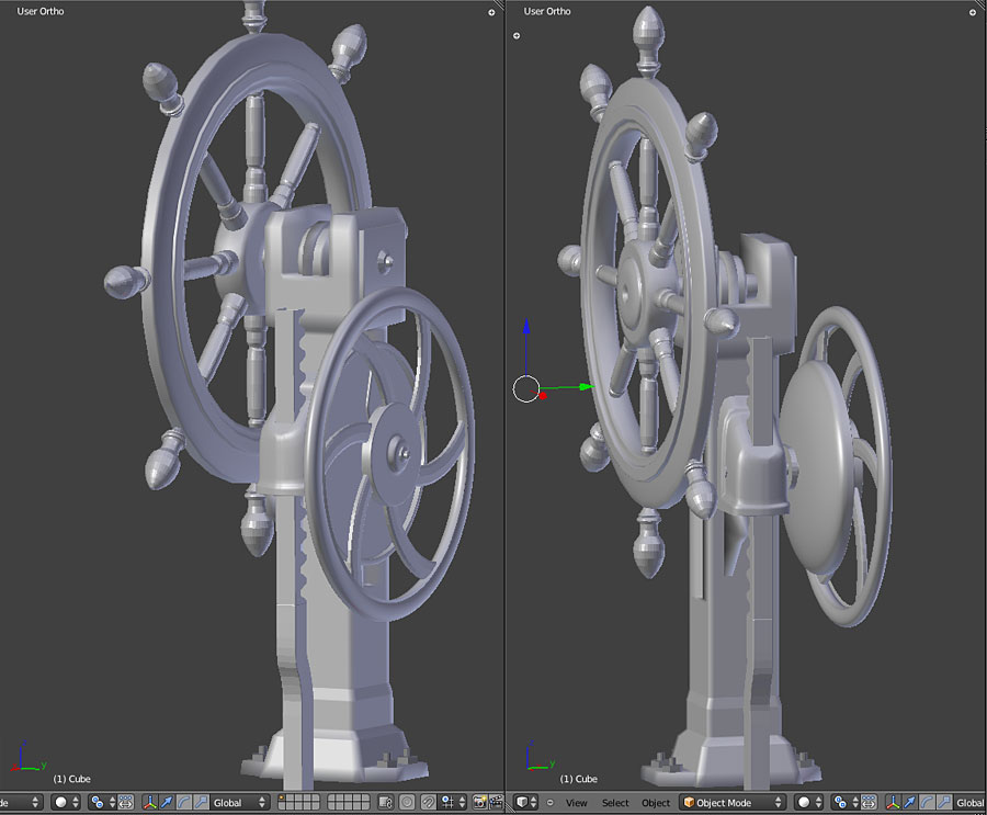

Here is my take on the Helm of the Tecumseh. I've got the basic 'workings' from the French plans (thank you Phil!), but it's got the 'styling' from the US plans and drawings. I've assumed that there is a disk behind the wheel that shows the 'speed' as on several US diagrams I can see that there is something round between the wheel and the background of the illustration. I've not put a compass on there, as I know that there has to be one, but there is no indication of where it is or what it looked like so I think I'm going to leave it, rather that put in something that is wrong. It may be that the compass was held in the hull, if only due to a lack of room in the pilot house!
I managed to find a contemporary drawing, from the Good People at Harper's Weekly. I can't say that it is particularly 'accurate' but it kind of confirms the general arrangement, if nothing else.
:shipcaptain:
Owen

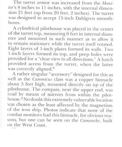

Attached is some discussion from the book, "Old Steam Navy" of where the binnacle went in the Passaic class monitors, and apparently in the Canonicus as well.
