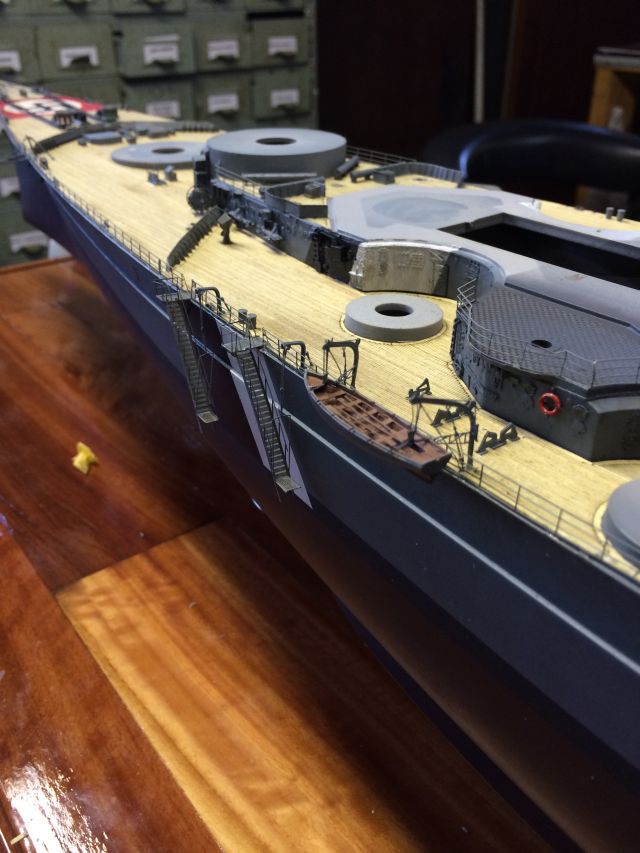

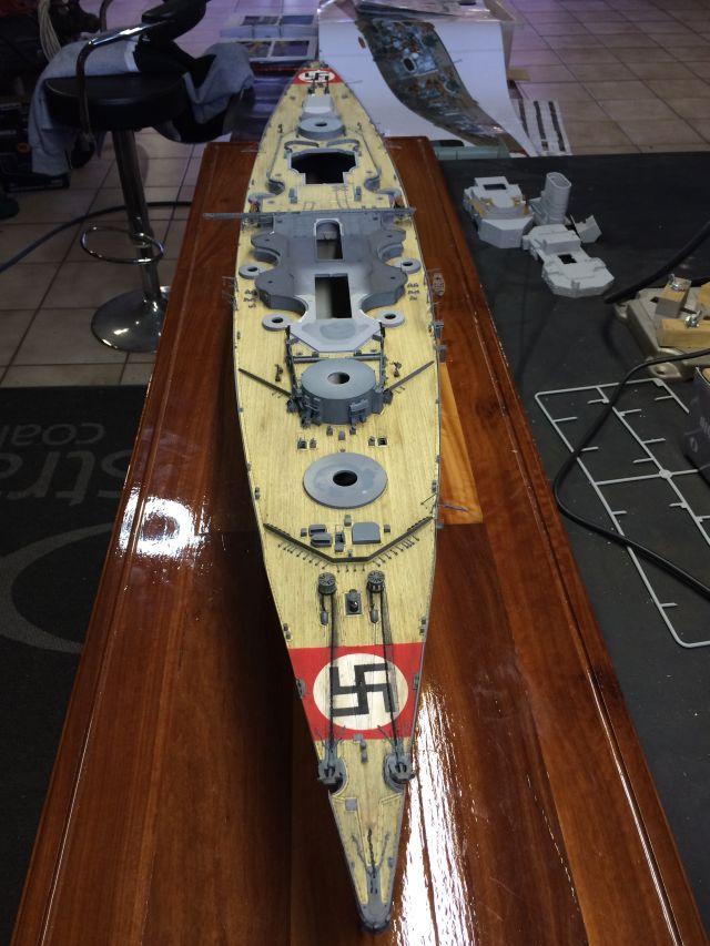

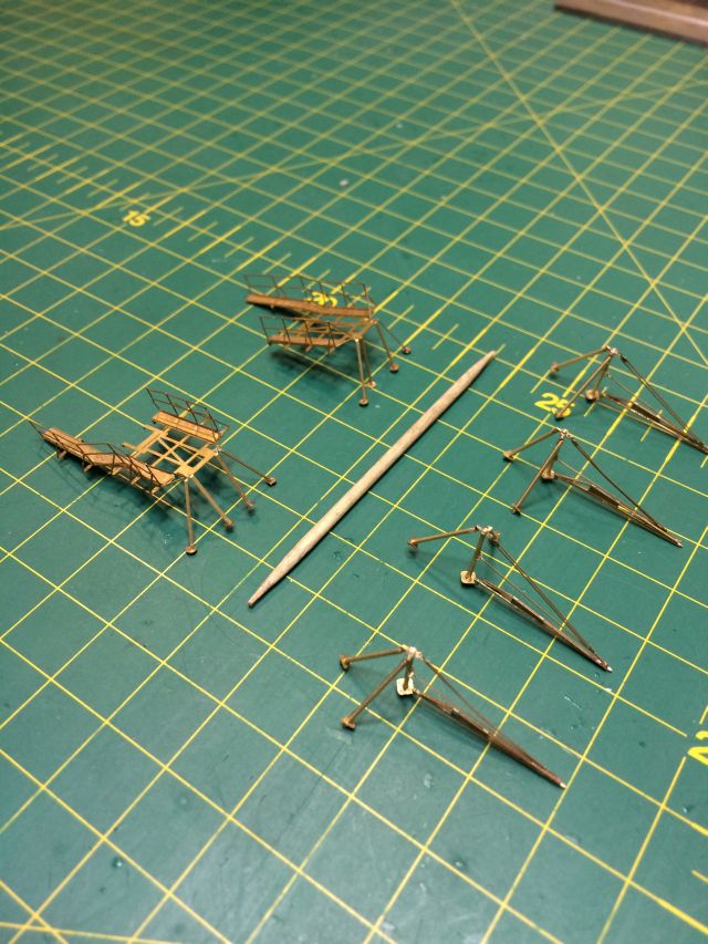

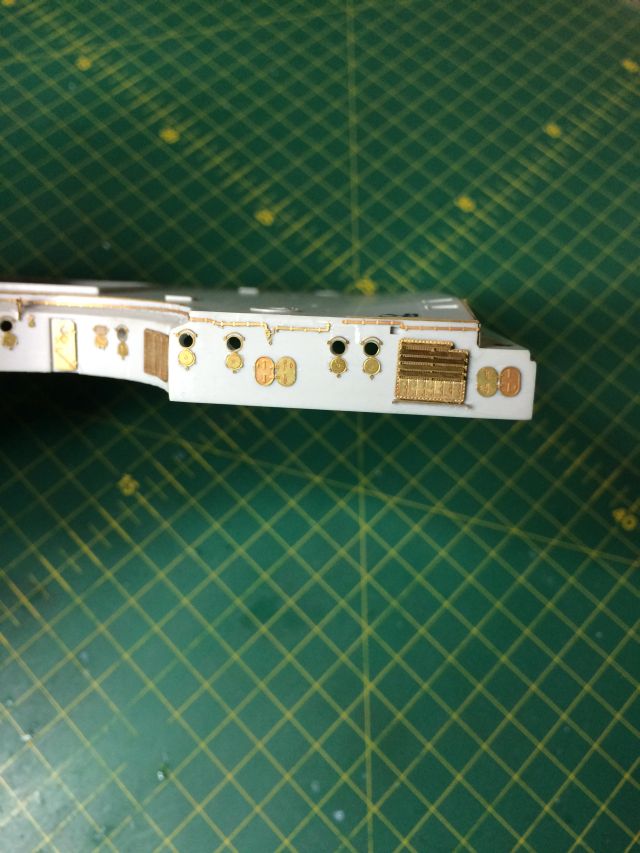

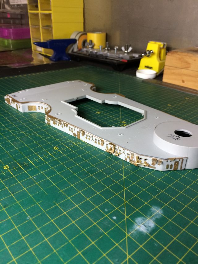

Mr Kim,

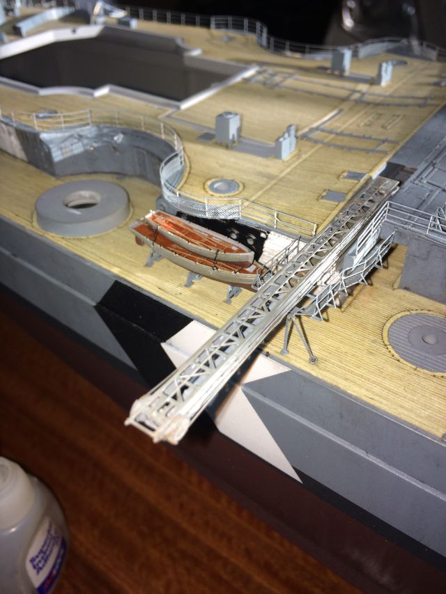

I would like to thank you and you staff for an excellent kit! :woo_hoo: I thoroughly enjoy the challenge to work with the kit and achieve a museum authentic model once completed. Your attention to detail and design is commendable. :thumbs_up_1: I post a few photo's to show my progress:

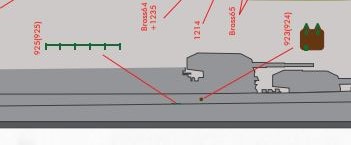

From the pictures I have of Bismarck I haven�t seen the part 925 (railing below the hatches alongside) in any of them.
So my q is, to add or not to add?

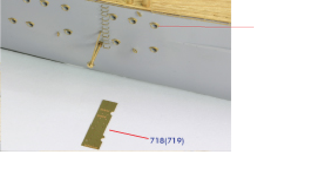

Hello @ all, hello Mr. Kim.
I think I need some help as I am wondering a little bit about the following issue...
See picture:
The marked parts - will these remain plastic or is there any PE stuff in the advanced set to replace these? I did not find anything in the instructionrs so far.....
Also the ladders and other doors at these parts... there is nothing in the instructions.....
Thank you very much for your assistance here!!!!
Michael

Morano wrote:Hi!
Trying to get a grip of this massive kit :smallsmile:
Refer the following link and see the photo noted as "The Bismarck's camouflage is touched up at Scheerhafen, Kiel in March 1941."
http://www.bismarck-class.dk/bismarck/g ... lprep.html
Keumho Kim

elmarriachi wrote:Hello @ all, hello Mr. Kim.
See picture:
Michael
PE doors, windows and some ladders are included optionally.
And I am sorry that we don't noted all of these locations.
Thank you
Keumho Kim
