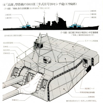

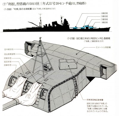

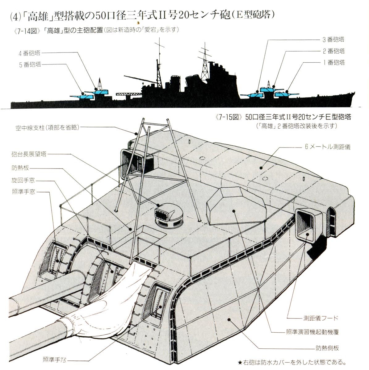

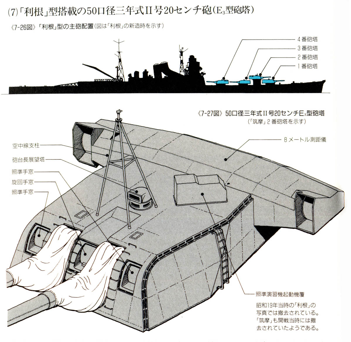

As promised. (Credit: Gran Prix Shuppan IJN Cruiser volume)
- 109
- Posts: 627
- Joined: Sun Nov 16, 2008 7:56 am
Thanks Dan.
I am collecting material on these vessels and that is of great help for me!
Biggest difference seems to be the 8m rangefinder on TONE against the 6m rangefinder on the TAKAO. There seem to have been 2 variants on TONE, however.
Have a nice sunday
Have a nice sunday

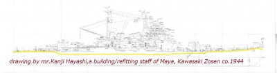

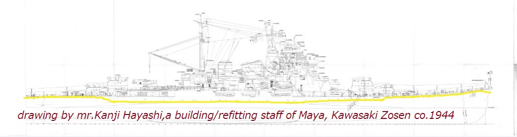

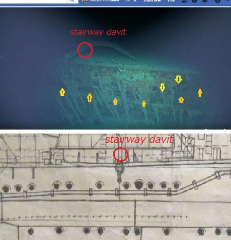

Illustrator of the then Kawasaki Shipbuilding co.,mr.Hayashi Kanji.was certain that Maya had degaussing cable,and,he said he didn�t quite remember how exactly it was arranged,so,he sprang it over on his drawing of Maya 1944. I took the liberty of trying to fill it with the cable on his behalf now.
I can safely say the degaussing cable was a "standard installation" to all IJN fighting ships,it was a must. If one ship would insist on going without having it, there ought to have been a very special,unfallible reason to avoid having the cable. None is able to point out the reason for a non-cable condition for cruiser Maya.
There was shortage of metals before the outbreak of the Pacific Ocean War,so,the cabinet ministers and their staffs lied to the Emperor when being asked by Him. The metals recovery law,as part of National general mobilizaton Law,was put into force,as early as in 1940.
cheers,
mucho
cheers,
mucho
- Posts: 9121
Thanks for posting the drawing, Mucho.
Isn't the "argument" really about whether or not Maya was equipped with the cable after her rebuilding? Or is it possible that the cable was internal? Oyodo and re-built Isuzu are what come to mind about ships without an external cable.
Mutsuo Sasaki
- Posts: 296
- Joined: Tue Dec 10, 2013 3:33 pm
- Location: The Savo Island
Yea, about the cable, ships with DC-current system can be equipped with deg. cable. All Takao class cruisers had DC.
Whereas, Oyodo had AC-current system. The degaussing cable gets power from DC-current, but can�t do this from AC-current ships. This could be the reason why the cable was omitted from Oyodo. Re AA cruiser Isuzu if she was with Dc-current,it could receive the cable installaton after the trial run was over.

- DrPR
- Posts: 1693
I don't know whether IJN ships used a DC or AC main system supply. Ships typically had multiple voltage/frequency electrical supplies. But regardless, the degausing system would need it's own DC power supply that could be varied to reduce the ship's magnetic signature. An AC to DC converter could be used for this.
The minesweeper I served on had primary 60 Hz and 400Hz AC supplies and a DC degausing system.

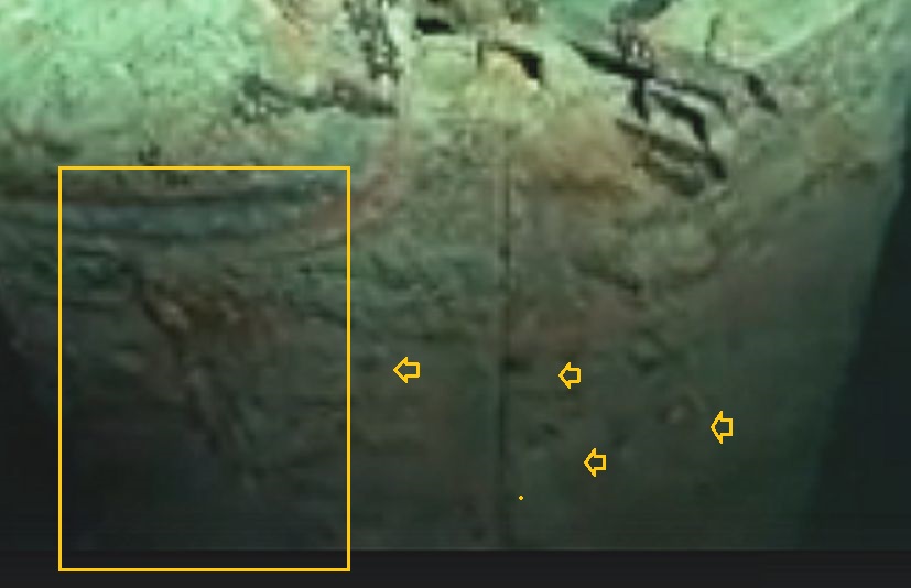

hi,

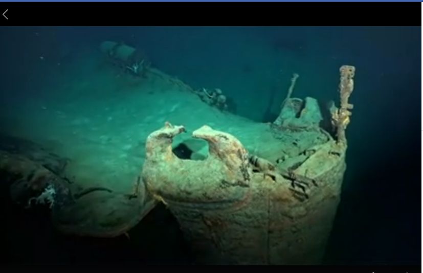

There is a bit more to checking of Chokai�s underwater image. I feel this seems to match the drawing of her. Again,the cable most probably got off when scuttling by Fujinami�s torpedoes.
Re.Maya it will be a boon to research efforts if one can find image(s) of her from R/V Petrel�s movie.When it was first introduced on the net last year, Dan got in touch with me,then I might have said to him that some visual proof of pesence of the degaussing cable is found in the movie. Have kept it since. In the image posted anew, there is something that looks like Edward�s scissors hand,I think this very much looks like disected 9 pcs of coild cable.
cheers,
mucho,
cheers,
mucho,
- Posts: 9121
I learn something new every day.Yea, about the cable, ships with DC-current system can be equipped with deg. cable. All Takao class cruisers had DC.
Whereas, Oyodo had AC-current system. The degaussing cable gets power from DC-current, but can�t do this from AC-current ships. This could be the reason why the cable was omitted from Oyodo. Re AA cruiser Isuzu if she was with Dc-current,it could receive the cable installation after the trial run was over.
Hmmm... there's definitely something there.,I think this very much looks like dissected 9 pcs of coiled cable.
Mutsuo Sasaki
- Posts: 296
The cable is approximately 4,5 meter beow the shield deck level at the midter-section was my renewed observation.
Will be sending this info with visual proof from Tawitawi to a certain shipbook co. in the homeland. A book is slated to come out probably next year if everything goes well,suppose no typhoon or a new corona info/pandemic stop them.
mucho,
mucho,
