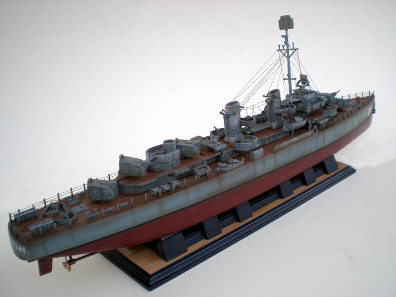

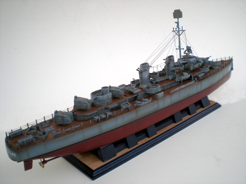

This one has 5 turrets on it. the main problem I am having is figuring out the main deck superstructure outlines. I got the turrets figured out last night.

proflooney wrote:This one has 5 turrets on it. the main problem I am having is figuring out the main deck superstructure outlines. I got the turrets figured out last night.
Looks like a Lindbergh Blue Devil Kit.

Please ... whatever you do ... DON'T USE THAT MODEL AS BEING REPRESENTATIVE of NICHOLAS ... or for that matter ANY FLETCHER ... at any point in her career. The Blue Devil is one of the worse kits ever made.

added a picture of a model i found last night. as you can see theres 2 turrets on the bow one in the middle and 2 aft.

yea wasnt using it as reference but got it as it showed the approx locations of the turrets which i figured would help me find the drawings. that model doesnt even have a skeg rofl i saw that right away and the hull looks too fat

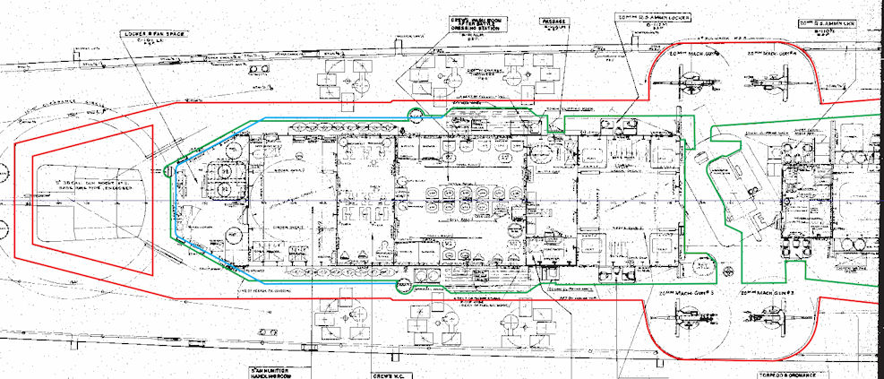

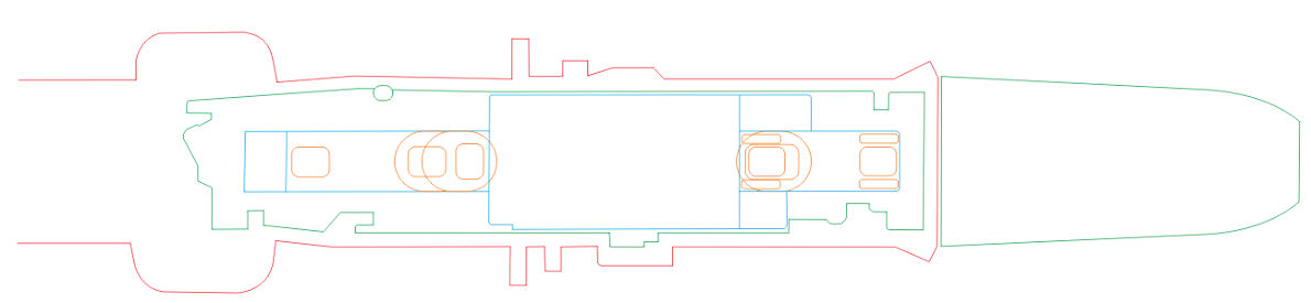

Here is the outlines I came up with for the aft portion. I am thinking that outer red area is the deck on top of the main deck superstructure, green is main deck superstructure, and blue is upper deck superstructure. though not for sure on the full shape of the blue stuff.

ok midships. it didnt show good over the plans so moved it off. the green is what I come up with for the main deck superstructure, red for the deck on top of it and the blue for next level superstructures.
if anyone sees something wrong with these pls point them out so I can adjust them properly

The 20-mm guns are on the main deck and there is a bulwark on main deck going out to the hull edge.
BIW Engineering Drawing TIFF images 365 and 366 show the superstructure deck at 01 level.
