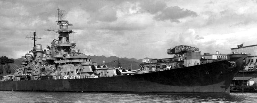

Here's pictures from the Floating Drydock Plan Book (a must have to really build an Iowa ship). The first is sitting in Tokyo Bay waiting for the Japanese to board. The next is in Pearl later in that September showing the "All Navy" hull scheme.

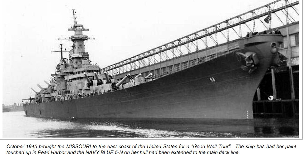

And here's another view during the Navy Day Visit in October.
I'm picking a time just before that additional Navy Blue was added.

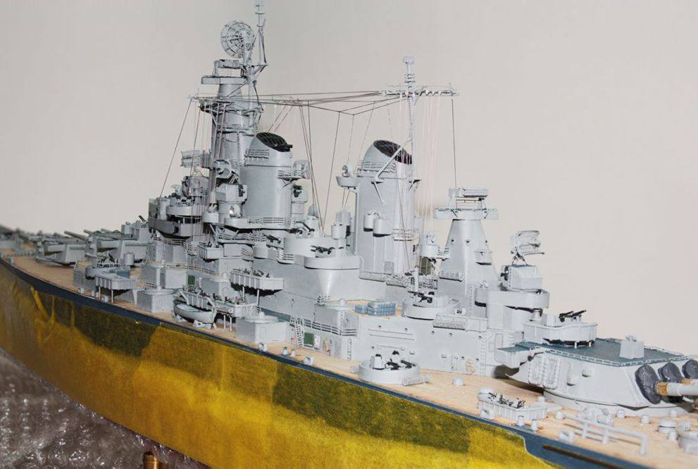

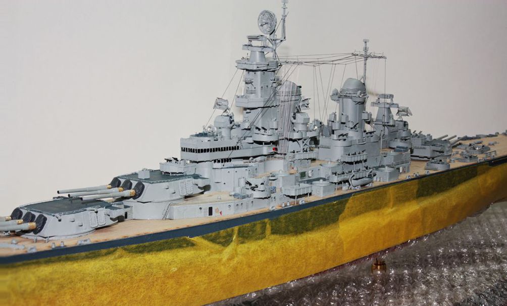

I just finished rigging my Missouri with E-Z Line. It's a very stretchy polymer thread that comes in a 0.003" diameter (also larger). I originally saw it at a booth at the National Train Collectors show in York, PA. Berkshire Junction makes and sells it. Originally, they were selling it to string model railroad telephone poles, but the small size is good rigging material.
Here's why: Instead of breaking when you bump it (liked stretched sprue) it stretches a lot. It has a huge affinity for CA and cures instantly when touching it. You can adhere a line, touch the contact with thin CA, and in a couple of seconds stretch it to the next point. Put a little tension on it and then touch some more CA. Done. Even better is how you can adhere one line to another as in joining the horizontal to vertical radio antennas. It glues solid with not bumps or lumps.
It doesn't like water-based glues. They repel. So you can't use it to make simulated insulators like with sprue. So I used some filled epoxy. Even that took a bit of coaxing to stay where I put it.
All in all, I think it some much easier to use than Sprue. I read Jim's work on Sprue a couple of times and then tried it on this ship. I was very dissatisfied with the results and finally ripped it all out, scraped all the glue off and started over with the E-Z Line. Give it a try...
In these pics I hadn't yet painted the insulators/blocks nor done touch up painting on the yards, but you can see that the rigging is intricate and complete.

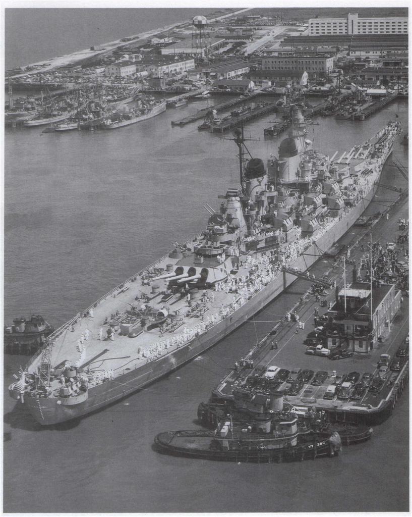

Hi Guys!Small question-where catapults in this foto?
Russ2146
- Posts: 2126
Re: Calling all USS Iowa class fans
That is a post WW2 photo. The catapults were removed after WW2.
The crane was kept for launching the ship's boats.

The planes and catapults were removed in May 1949 so this picture was taken some time after that....

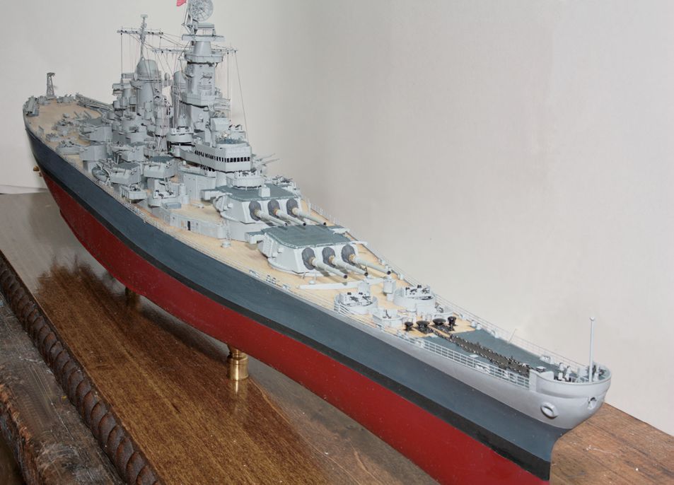

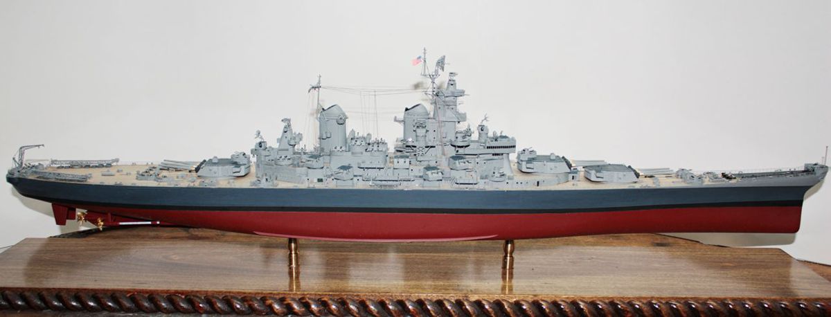

I like how you've removed the window area and built up the pilot house inside the bridge in prep for a PE window facade. I didn't take that route with my Missouri which is almost completed via today's session. Having not used a PE set that had the windows, I was left with the traditional choice of painting the windows with gloss black. From what I understand both Flyhawk and Lions Roar give the window facade. I used Eduard, while having lots of details, does not include that piece of superstructure.

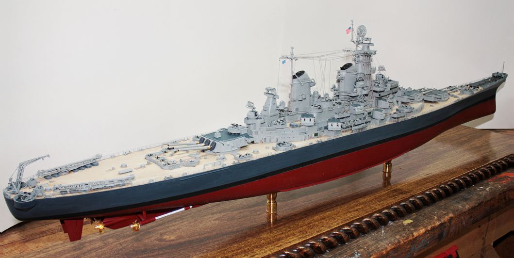

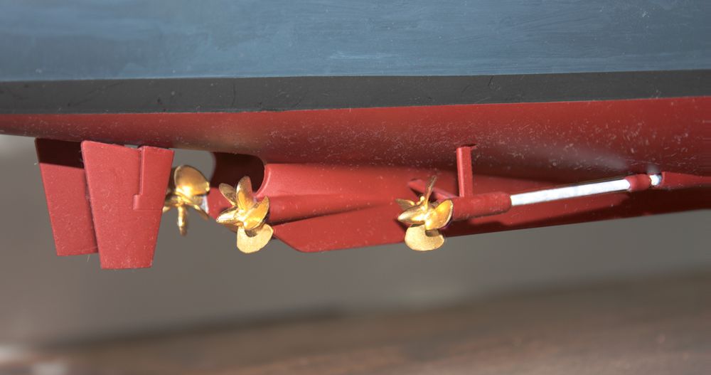

I installed the G-force props today and installed all the remaining guns. All that's left is ship's planes, anchors and decals. Prop shafts are steel, painted white and the streamlined coupling cover is a piece of drilled and shaped sprue. The G-force props are for the North Carolina and are a bit undersized for Iowas, but they're a lot sturdier than the kit's props which are a bit oversized.

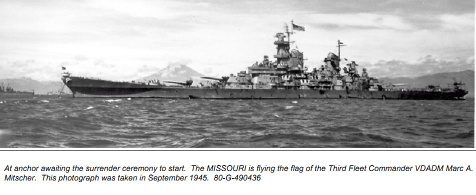

The ship is modeled as it appeared after the surrender signing on her decks, and after the teak was restored to natural wood color. During this time, the forward 20mm tubs were removed that flanked the #2 turret. This was just prior to painting the entire hull Navy Blue for the Navy Day celebration in New York City in October 1945. I picked this specific moment in time to show off the laser cut wood decks that I didn't want to paint deck blue. The effect is very good IMHO.
The picture I have of the Missouri in Drydock in the 80s shows the color of the shafts to be probably white lead.

Builder2010,
wow your Mighty MO looks amazing! Great job! I too have bought the g-force North Carolina class propellers but the smaller size that the kit provided ones led me to discouragingly put them to the side. They look really good however on your finished model! What did you have to do to compensate for their size?

Builder2010, So is she complete? everything done final touches,etc....I see you're gonna send her to Pearl heh?

First, thanks! It's been a long slog (11 months), and it is almost finished (98%, but who's counting). What's left is the Seahawks and fastening the cats in place. I'm going to rig the Seahawks with the outriggers that extend down from the wings to the sides of the launch cart. I'm making it out of the same 0.008" guitar string that I used for the guy wires holding up the foremast and fore topmast. It's thin enough to look good in this scale, but actually has some strength to support the plane. Once this is done, I'll then fasten the cats permanently. In the pics they're just sitting there looking cool.
Everything was airbrushed in the beginning, but all subsequent touch-ups (many times) were done using various sizes of brushes.
I didn't do anything to make the props look right. I used a piece of 0.072" steel rod for the prop shafts and drilled the hole out in the back of the 4-blade G-Force props to accept to the shafts. In the real ship the shafts appear white (white lead?) so I did the same.
It's going to Pearl if I can get it there in one piece, and that is still a big challenge for me. I have time to think about it.
Any suggestions would be appreciated about shipping a 30" mounted scale model 6,000 miles.

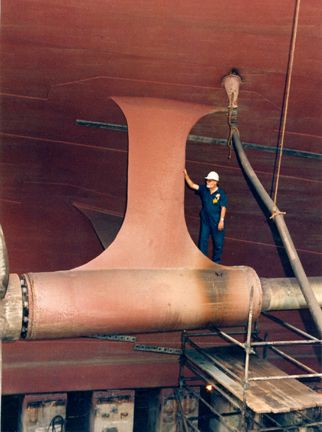

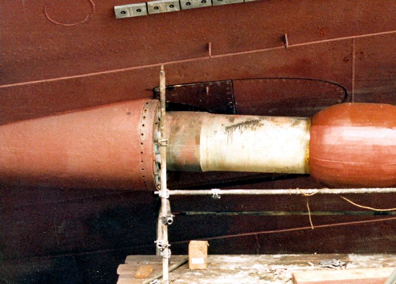

Here's the shaft pictures as posted by Rusty Battleship (pen name) who was the superintendent at the Long Beach Navy Yard when the Iowas were rebuilt in the 80s. That's him standing on the strut. Impressive!!!
I simulated the streamlined shaft coupling bulge using some shaped styrene. The shaft scales out very close. The real one is 23" in diameter except for the bearing portions, which is 0.065" and I used 0.072". It fits the Tamiya shaft strut's hole perfectly!
