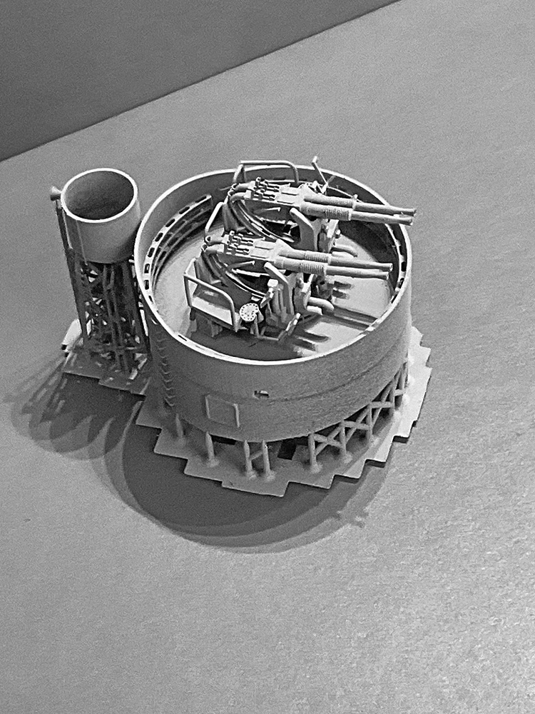

When I get a bit further on (ie. having a hull under construction) I'll start a new thread. As my next project , ARL 12 which my dad served on off Okinawa, I have already some components to work with as it will be the same scale as the APA. I already have the assigned LCVP's, and 20 mm Orlikons that I need. Here is a first printed effort of the bow tub which was placed on the inclined part of the main deck above the bow doors. As with many 3D items, some minor mods needed. The 40 Quad is one of the APA early rejects but added in for effect. The new item will include the shield as typically seen on Battleships, sights and a few other minor improvements.

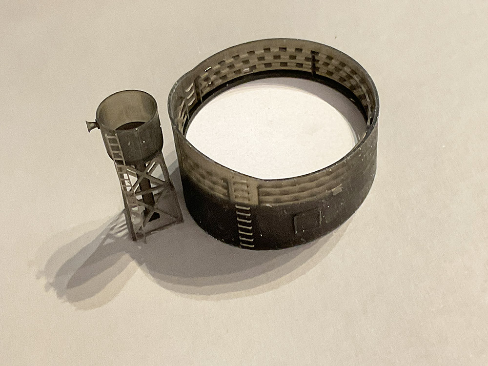

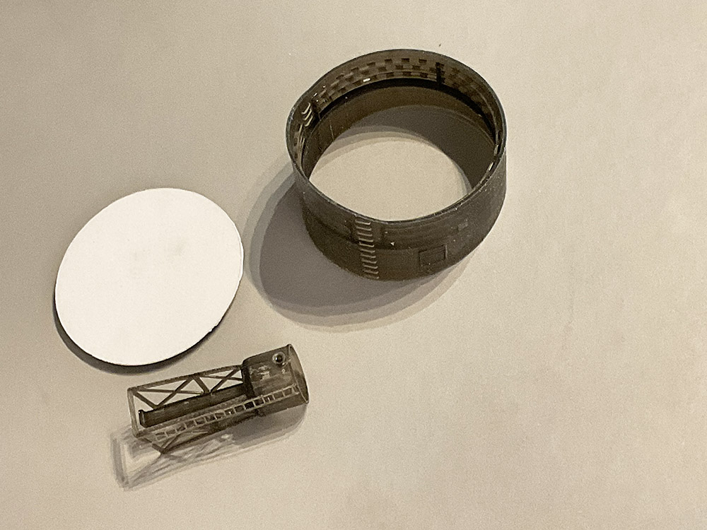

Again, to quote my antecedents "Wah Hail". As you can see there is an external expression where the tub deck is, due to the deck shrinking and pulling a waist in to the cylinder. Brilliant repeat idea is to print the deck as a separate carefully sized element to slip into from below. Except the insert is a bit small after it shrinks. I could re size and reprint the deck disc, but easier to measure and use the vinyl cutter to make an appropriate sized disc from Strathmore cardstock to glue to the slightly small disc top. Works quite brilliantly! Then of course the resized from 1:196 Quad Bofors turned up to be 8% too small. Resized and re printing now. Otherwise the Bofors was nice looking (eye of the beholder).
To reiterate, 3D printing isn't a press a button and get a part operation, lots of experience (bad parts) by iteration in some cases.

Here is the tub printed as an open cylinder, avoiding the waist distortion. As mentioned the base section I cut out and printed as a separate piece was a bit small due to shrinkage. I cut out the disc in a larger size using the Silhouette machine and laminated them for rigidity. It now fits nicely in the tub. Te Strathmore is finished with several coats of auto primer, which in my current experience holds up perfectly for at least 1/2 century. I also printed the ladder to the Mk51 separately so as an error in this fragile item won't ruin the whole assembly.

Those parts look really good. I think (as we've both discussed) that flat objects such as tub floors, deck pieces, etc. do not tend to print flat or will cause attached or surrounding parts to distort. As I mentioned, my raised 5" mount platform for the LSM/R needed a solid wood brace below to hold it's flat shape and then cracked and had to be repaired. I can still use it with some modifications.
My 40mm tub printed ok but it doesn't have an extended circular wall as yours does. While your Strathmore paper floor will work, I wonder if you printed a tub floor and then measured the finished diameter to see what percentage of shrinkage had occurred and then reprinted adding that percentage to the design to compensate. If this worked you could then add the additional mount location rings, etc. into your tub floor design. Just thinking out loud :thinking:

In general on my printer the part is printed 0,3 mm larger than the one drawn. It seems to be constant.
I take this into account on both parts when making an assembly.

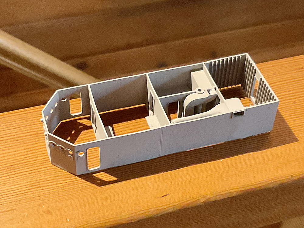

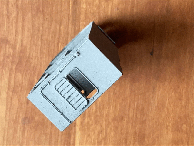

Printed a test bridge structure (the front of which is seen in the photo above). Showing the bridge, chart house, radio shack, vent room and First Luff's office. In addition i have printed 16 deck ventilators (not helpful for Covid) which I suspect when I start placing them on deck, there will be several times more.
The whole pilot house affair was too long for my printer platen so the 1st Luff's office was printed as a separate piece.
Tom

Post by BB62vet »
Tom,
That looks really great! Did it come out to scale as expected? I think you did a really good job on the bulkhead details - nice to be able to add those items into the initial design where possible.

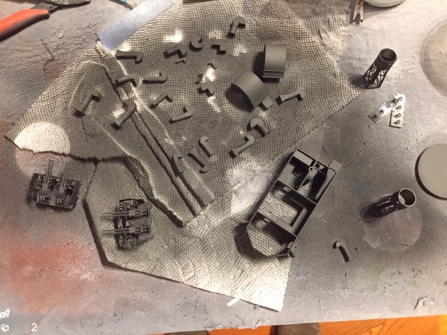

So far I am just making small bitts and pieces which could go on lots of different WWII ships. Here they are getting a coat of a very flat black primer. Somewhat of the disorganized chaos of a real shipyard (in my experience). I did pick up a 2'x4' sheet of 1/16" plywood from which much of the hull will be built. The starting move will be to rip it lengthwise on the table saw into a 5" wide strip from which the main deck will be built. A narrower piece for the flat bottom and tapered pieces for the main sides. The rest should be enough for the ribs.
Tom

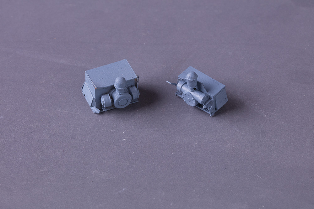

I did make replacement boat winches, using the ones from the ARL which as far as I can tell are the same models. Here you can see the old model on the left and the more correct one on the right, analogue vrs 3D. 3 of the 4 replaced, have to move the somewhat large and heavy model to access it.

Nice improvement on the winch! Its amazing how much detail we are able to get using the 3D designed parts - like a whole new ball game.

The new winch has the blessed characteristics of taking up less precious deck space. I have replaced a lot of original analogue bits and pieces, every weapon, Orkilons on their third iteration, Bofors and 5" second, boats second, and on and on. Alaska had every weapon except the main battery, including directors, replaced as did Missouri all the 5" and associated directors.
