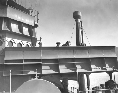

The pic you posted with Admiral Daniel V Gallery for ARL 12, the bridge venturis are huge.
With the horizontal bar running mid height across them, makes me wonder if the upper part was for the
bridge & and the lower half helped ventilate the deckhouse.?.

They are huge and seem to be a bit unique to these ships. I haven't seen any evidence that these were used for ventilation, but anything is possible. The mid section in front of the pilot hose seems a little blocked, which might be to keep the potholes more clear of spray? These were not fast ships, so perhaps the large size is to make up for reduced velocity. The ones for the flying bridge are also quite large. The flying bridge was probably a very pleasant place to con the ship from in typical Pacific conditions. I have a photo of the Captain and bridge crew in the uniform of the day (bare chested). In later days (post war) such ships as were retained as for support of the Brown Water Navy or electronic warfare (Sphinx) had the flying bridge glassed in. It's what the Royal navy dismissed as "Iron Ships and Wooden Men"...
Regards: Tom

Venturis were not used for ventilation. They collected air blowing against the front of the superstructure and forced it to blow upward along the front of the open bridge. This created a "wall of air" that deflected the wind blowing directly over them upward.
They work by capturing the moving air in the wider opening between the venturi and bulkhead at the bottom and compressing it in a narrower gap at the top. Reduced volume generates higher pressure (Boyle's Law), and higher pressure accelerates the air. So the air coming out of the top of the gap between the venturi and bulkhead is blowing fast and hard straight up. When this hits the wind coming horizontally toward the bridge it deflects the air stream upward.
This really works. My first ship, a small inshore minesweeper USS Cape MSI-2 had venturis on the open bridge. I have stood behind them in gales with 30-40 knot winds and rain, and the wind on the front of the open bridge was just a breeze. Most of the rain was deflected over the bridge. But we were also taking green water over the bridge and standing in 6-8 inches of water sloshing around the decks, so the venturis didn't help much to keep us dry!
The ARL venturis don't look overly large to me.

Paul and Phil:
Here is another view of the bridge wing venturis taken during Rear Admiral (newly promoted) Gallery's visit. There is a bar stock used possibly for reinforcement but more likely to rig an awning. In front of the pilot house there is a "reducer" that restricts the volume, possibly to reduce spray on the bridge windows or flying bridge. I expect perhaps an "add-on".
