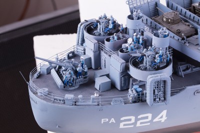

Stern of Randall. I replaced all the Sky Lookout chairs. This is the third iteration of these items. Randall had 12 of them, in six twin tubs two fore, two aft and two abeam the stack. A lot of lookouts! The ARL had only two. In this case you can see the sets between the 40 mm's on the fantail deckhouse.
A total mix of constructions of wood, paper and styrene along with resin cast components and 3D printed items. The LCM's are from basswood, styrene and paper, the rafts and ammo boxes cast, Bofors, 3D etc. Deckhouse is wood and paper.
Tom

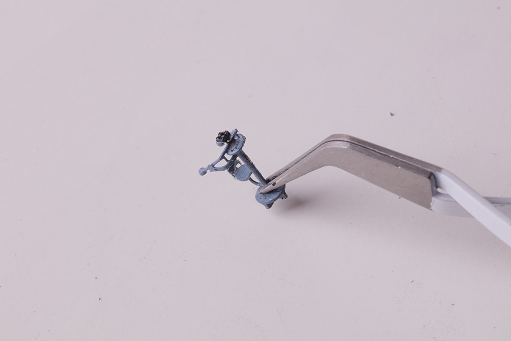

- Posts: 5068
Re: APA project
The sky lookout, all the substance of a dried mosquito! I just replaced all the chairs on both the APA and ARL with this item/
Tom

- Posts: 5068
Re: APA project
Stern mount 5" 38 with crew added. Note hot case man wearing the long white asbestos gloves.
Ship is about 70% crewed so far with light AA people, sky lookouts and some bridge personnel.
Tom

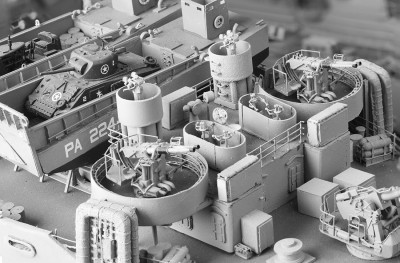

- Posts: 5068
Re: APA project
Randall stern, light AA crews manned.

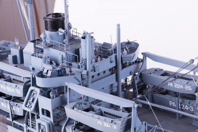

- Posts: 5068
Re: APA project
Randall bridge area. Some crew remains to be added.

- Posts: 5068
Re: APA project
The Fore-Deck is the portion of the ship when in Airforce service is allocated to the golf tee.
Another view of the bridge crew.
The magic of photography allows me to re visit every error and omission! A note on photography, taken with a 50MB Canon 5DsR and a Canon L 100 mm macro at F20 using dual studio strobes and soft boxes. 8 raw images were merged in Photoshop using photo stacking to get most everything in focus. Then everything thrown away to get an image I can post here!
Tom
Tom

Re: APA project
Nice shot.
I see that some decals are peeling off. I usually apply a coat of matte varnish to seal them in the paint and protect them.
Pascal
- Posts: 5068
Re: APA project
Pascal:
Those are press applies that I made on my stencil machine. Many of the boats were glued down when I went through and changed numbering to masked painted on ones, so about half the boats don't have painted numbers. The humidity indoors here in the sub arctic often good below 3%, even kiln dried lumber shrinks! Yes I did overspray with a matt varnish, looks like a "booster" is needed.
For small paint jobs the new IWATA air brush seems much superior to the gravity fed brushes, in a long project using new (to me) techniques a big learning/experience happens.
