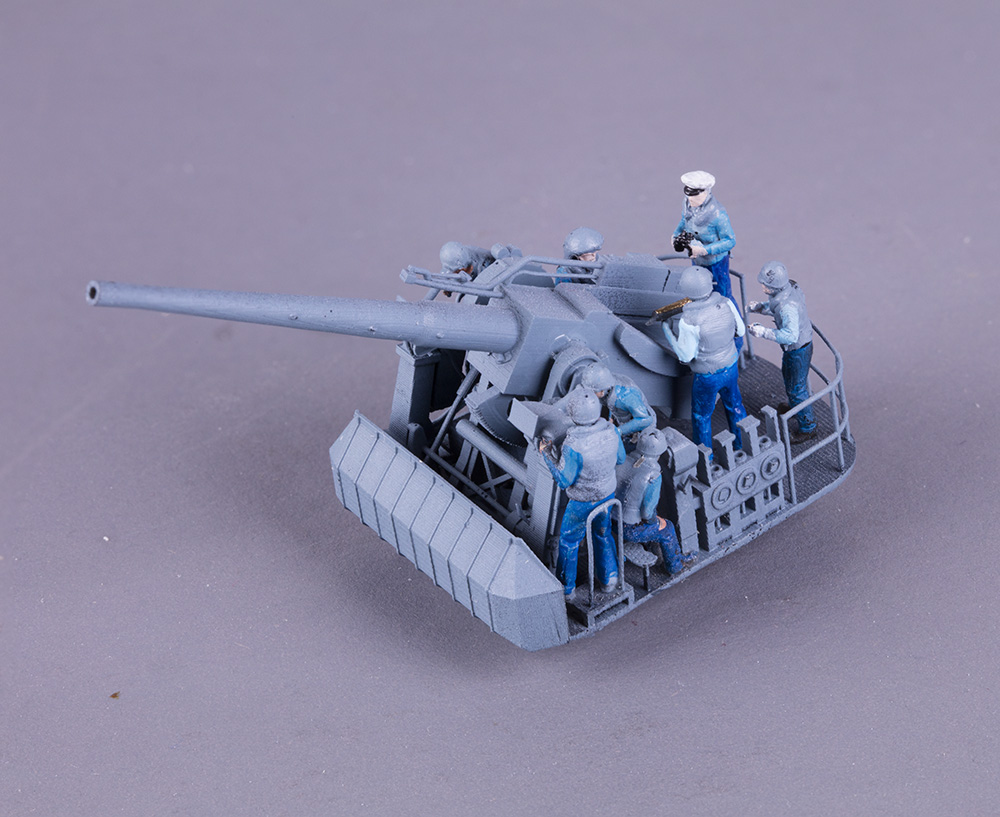

Posted: Tue Feb 08, 2022 2:33 pm
by Fliger747
Stern mount 5" 38 with crew added. Note hot case man wearing the long white asbestos gloves.
Ship is about 70% crewed so far with light AA people, sky lookouts and some bridge personnel.
Tom

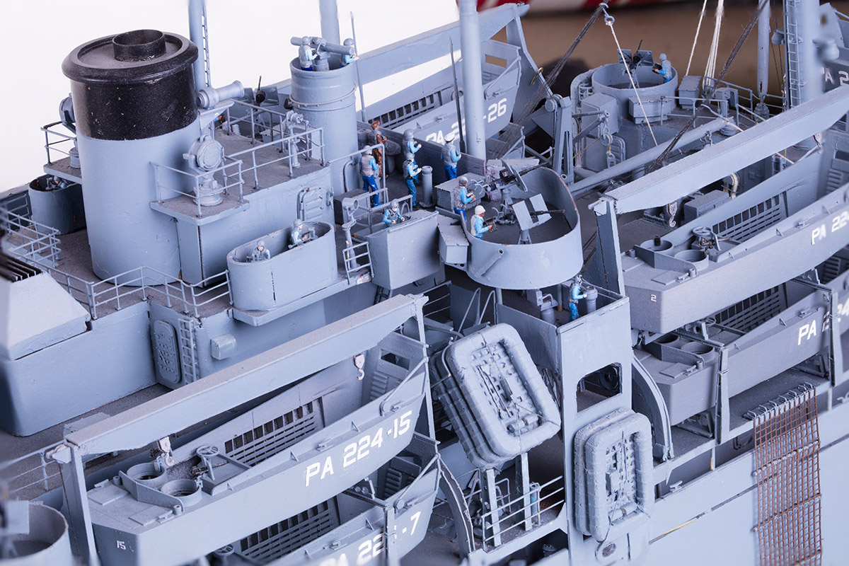

Re: APA project
Posted: Tue Feb 08, 2022 2:41 pm
by Fliger747
Randall stern, light AA crews manned.

Re: APA project
Posted: Tue Feb 08, 2022 5:48 pm
by Fliger747
Pascal:
What I found out was there was almost no tolerance for errors in layout as even a mistake of a scale foot would mean something else would not fit!
