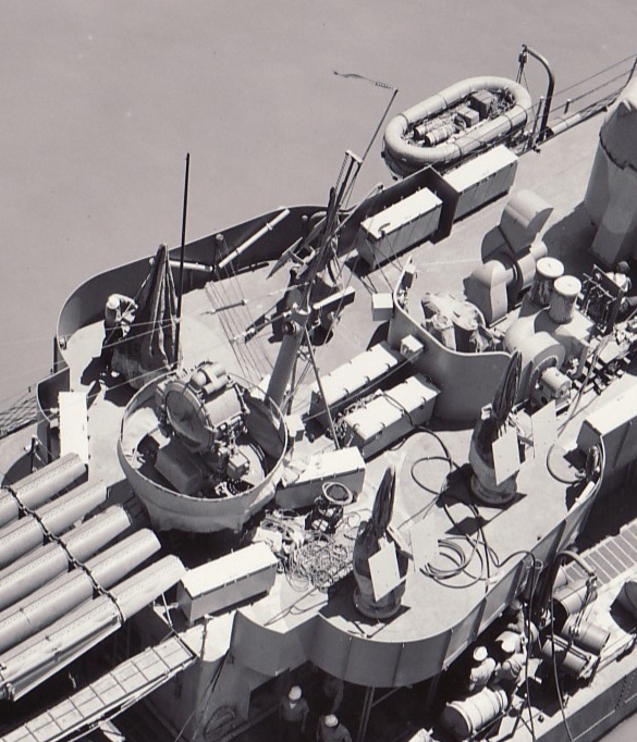

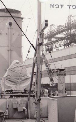

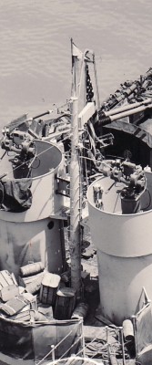

- Posts: 3871
The mainmast on the BENSON-GLEAVES units in the Pacific during 1942-43 were mostly needed to support the radio leads. Also, it was used as a flag pole and to mount the trailing light. I have read some discussion in BuShip files about these mainmasts had problems blocking AA fire and interference with the searchlight locations, relocated fire control directors, etc. They seemed to get simplified as the war went on.
Construction of these masts varied. LAFFEY had a pretty substantial mast as did other "Bethlehem-built units". Other units used a lighter weight mast with stays and/or one or two braces to support it. Some units adapted a lighter weight mast during overhauls. It does seem that as built units had mainmasts according to what their builder had designed. I had to downsize these images ... Photobucket and Modelwarships were NOT working together for some reason.
The Bethlehem early "style" mainmast was a single heavy pole;
On USS LAFFEY ... 16 September 1942
And on USS FARENHOLT retained hers even after being upgraded with twin 40-mm mounts ... 22 May 1944
The Federal early "style" mainmast used a single centerline brace pointed forward and two stays
on USS BUCHANAN ... 26 May 1942
and on USS LANSDOWNE ... 27 June 1942
USS MONSSEN (and other units in DesDiv 22) had a different type of mast installed after they had the original searchlight tower cutdown. I couldn't find a good image of the mainmast of MONSSEN, but here is an excellent image of the mast on USS GRAYSON with a lighter weight mast with two braces to the aft.
