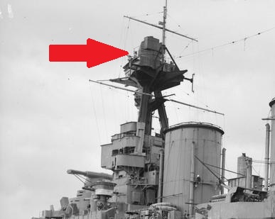

Hi folks.. probably one of my last questions:
I am somewhat confused as to whether the railings atop the rear spotting top roof (shown in attached c1940 photograph which was obviously taken prior to the Type 284 gunnery radar being fitted) would still have been carried after the 284 arrays were fitted? My concern is that the lower planar array (the emitter?) might have interfered with the railings in rotation - although it is obviously narrower than the upper (receiver?) planar array. I am wondering if this was deliberate or just coincidence. I suppose the forward upper rails might have been cut down - similar to how they seem to have been around the forward Vickers .50 positions i.e.: 'Pip' & 'Squeak' by 1940.. there obviously was still a requirement for crew egress up there - noting the ladder fitted on the port side of the control hood..
John Roberts' AOTS outboard profile indicates they were still carried in 1941; however Maurice Northcott's Man O'War publication doesn't show them (I do realise they may have been omitted for clarity - it is otherwise fairly cluttered up there).
If only those April 1941 photos of HOOD actually showed the foretop more clearly.. there is also what looks like a closer version on the HMSHA website but unfortunately has some text over what I am trying to look at.. perhaps what would have been under the text wouldn't have been clear enough anyway.
Could anybody possibly comment ? has any other information come to light? Are there any further plan sets or profiles which agree or disagree?
Thanks in advance for any insight.
Best,
Joseph
Best,
Joseph
- 40spottingtoppre284.jpg (28.17 KiB) Viewed 3363 times

EJFoeth
- Posts: 2944
Re: Calling all HMS "Mighty" Hood fans
The 1941 spotting top is not well photographed; for instance, we do not know exactly what the new yardarm looked like and how it was fixed to the spotting top. However, the railing was originally only placed around the base of the rangefinder and not extending much further 'upstream' towards the anomemeter.
This image taken before the radar was fitted shows the railing outline faintly.
Here the railing outline is not visible. The lower aerial of the type 284 would certainly interfere with the railing. There was a small path added to the port side of the spotting top and a ladder to reach the fwd spotting top roof after the type 284 was fitted (Image Hood association) suggestion that getting there via the roof of the spotting top was no longer an option.
EJF,
Are you sure that the "path" shown in the top image of spottopa jpg.[32.69] (coloured on the lower) and on the Starboard side, is not a workman's temporary wooden staging with an access ladder? I'm not.

Hi EJ,
Thank you again I really appreciate your reply. I was familiar with that coloured shot from the HMSHA website but hadn't myself thought to try and find an older photo of a similar angle to compare stanchion heights and locations. I agree that if anything was still there then it probably would have been visible from this perspective - even if still there but cut down in height.
By the way I will assume you meant Starboard and not "Port".. some days I really worry myself what I might have said 'pre-coffee'
Thank you kindly again for all of your very helpful replies.
Hi Guest,
Concerning the small accessway I have always wondered the same thing; having seen similar platforms lifted aloft when painting ship etc. Something about it just seems a little hotchpotch to me. Short of another visit to the wreck - or new photographic reference coming to light - I doubt we will ever know the answer to this. At any rate I am painting the ship from ahead of her Port beam so.. problem solved.
Best regards,
Joseph
Hi Guest,
Best regards,
Joseph

EJFoeth
- Posts: 2944
Might be a temporary scaffold, though it's also visible later when the King visits Hood
Here it seems railing is still present...?
