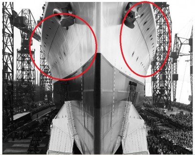

pgollin wrote:.That is not "oil caning" as such."Oil canning" is where lighter weight plates are distorted between supports, especially by the seas' action. What you can see on the POW is the ridges formed by overlapping plates..
I was about to ask a / that question, as I thought 'oil canning' referred to as you described Phil, and couldn't / wouldn't expect to see that in the photo (given she had never been to sea). I wonder then if Mr Church is referring to / describing something else?
Yes, Pgollin perhaps misunderstood Church's comments. One careful look at the pic and you can clearly see canning effect on the freeboard that is references. And it cannot be mistaken for plates overlapping. I would refer you to the pic he posted and ask to zoom in on the white hull portions that would be above water. I dont know why actually they appear there, however. Those usually developed after sailing in rough seas over time (or just after sailing for long time). So it remains to be understood why it is there, but it is on the non-armorered part of the hull, it would seem...
pgollin wrote:.
Yes what Mr. Church refers to at least appears very much as oil-canning. You are not wrong when you talk about overlapping plates, but this is NOT what Church talks above. Look again - the hull freeboard above the antifouling paint (which is red black or grey, have fun with that one separately). You can see, clearly, a lot of vertical ridges running close to each other, with that distinct oil canning effect.

It might not be classic "oil canning". There is another possibility to consider. It could be temperature related. In this view of the USS Barton (DD-722) (https://destroyerhistory.org/assets/sum ... als_01.jpg), you can see the framing because the temp outboard of steel beams was different from that outboard of the interior air spaces. What was the air temp when PoW launched? Could it be condensation in the photo rather than oil canning?
Posts: 12463
Re: Calling all HMS King George V class (WWII) fans
The dished-in plating appearance is very common on today's warships, even those that have yet to touch water. I agree with Dick that it may have to do with temperature, whether from the welding process as the metal heats and cools, or from the general atmosphere.

As far as I'm aware, it's the welding process that's primarily responsible for this effect. It's more prevalant today due to the universal use of thin plate instead of armour. All of the KGVs were rivetted hulls, but if the ships were hot-rivetted you might expect a more subtle effect as a result on the thinner plates, such as the top of the hull there.

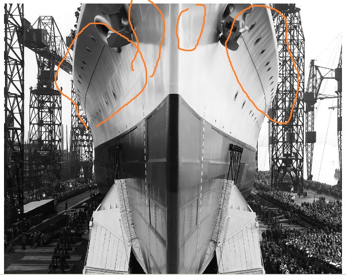

Yes indeed it is these areas I was referring to:
And not the lower hull plating below the waterline. As I outlined in my initial post it is obviously not 'oil canning', as the hull has not been to sea yet and not been subject to wave action that would be necessary to cause 'oil canning'. But what else does one call it? It looks like oil canning even if it is obviously not really.
It's the hull framing showing through the exterior hull plating. She was launched in May 1939 which would be late springtime in Liverpool when you might still have warm days but cold nights. That might account for the effect?
In any event, it is very subtle and not at all apparent in any other photos I have seen of King George V Class battleships.

Mr. Church wrote:Yes indeed it is these areas I was referring to:
And I couldnt see the forest for the trees. :bash_2:
Given previous discussion I was looking below the waterline. But when pointed out in photo, it stands out like the proverbial dogs.............Interesting 'effect' whatever may have caused it.

I have followed the matter of the apparent distortion (oil-canning if you wish) of the plating in the sheer strake of HMS PRINCE OF WALES with interest. To really get to the root of the subject would require the opinion of a ship builder; which I am not, versed in both riveting and welding techniques, however, I have spoken to a retired naval architect on this thread who did an apprentice-ship in a well-known British ship-yard and some of his information is included here.
First, let's deal with welding. The distortion of shell plating using this technique is caused by contraction of the weld as it cools. This is shown in diagrams on Page 37 of the first edition of RN Newton's "Practical Construction of Warships" printed by Longmans in 1941.
This will clearly occur whilst the ship is under construction. In PRINCE OF WALE's case, this now begs the question, was any part of her constructed using welding techniques? Cag might be able to answer this from his References. If not then the only Reference still open that might, will be the Ship's Cover in the National Maritime Museum. Whatever the case, "Newton" does mention that Messrs Cammel Laird did construct approximately 75% of the aircraft carrier HMS ARK ROYAL by welding. If this technique was applied to PRINCE OF WALES's sheer strake, then it might well explain the apparent distortion in it. Let's "assume" for the purposes of the rest of this post, however, that it was riveted.
"Newton" mentions nothing about distortion in riveted plates while a ship was under construction that I can find in a quick perusal of his content on the subject. Theoretically, it should not therefore have occurred therefore unless the scantling of the plate specified was too light and the distortion was caused by the heat of rivets contracting or the distortion was caused by something else. In which case, what?
Cag has pointed out that PRINCE OF WALES was the only member of the class to be built with a "knuckle" in the sheer strake close to the Upper Deck. The question is "Why?" It must have been approved by the Director of Naval Construction (DNC), so there may well be information about this matter in the Ship's Cover. The next question is "Why did the three members of the class laid down later not have a "knuckle?" For what my opinion is worth, it may have been that Messrs Cammel Laird experienced some trouble in fitting the plates that had this feature; which may have caused the observed distortion and having reported it to DNC, orders were given to the builders of the follow-on ships not to include it in their ships.
It may beg the question in some minds, "Why would such a "knuckle" cause such a problem in a plate?" Well, plates with two and more bends had to be appropriately "smithed" (hammered under heat) to shape and in the case of the bow sheer strake plates in PRINCE OF WALES I can see three if the "knuckle" is included. Fitting such a plate in place may have necessitated some local heat being applied to get it in place before the rivets were closed up. However, some will say "All right, you have a point but what about the "smithing" of the plates having "knuckles" in British cruisers of the period?" Good point, so we would need to look at the bow plates in these ships.
With that I will end there, except to say that the plate distortion in the sheer strake of PRINCE OF WALES, does not appear to have resulted in any adverse comment in the "big name" References so in her case it is only discussion-worthy on this site. However, I do consider it extremely unlikely that changes in the shades of the paint will have caused this effect seen: it is more likely to have been high-lighted by the angle of the sun at the time the photograph was taken.
I look forward to seeing a clear answer to the matter: if it can be found.
