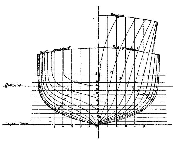

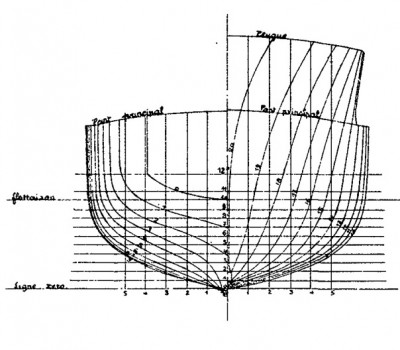

"Mogador" & "Volta" hull lines? wonderful looking ships they were...

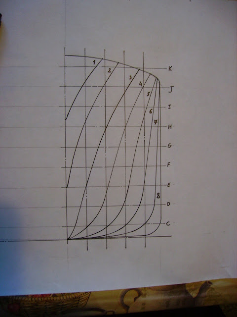

4- from there on, draw the main frame, which is the largest one on the hull, most of the times on the middle of the hull.
5- begin to draw the frames, from the deck to the waterline and a little under, like this, being the forward hull lines:
go further on, the C to K lines are the horizontals, like slicing the hull from the bottom up, you'll need them to check your hull is smooth:
on the view from above, draw the lines on each frame at the horizontal levels (C to K)

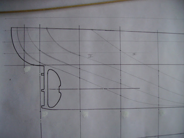

There is a second way to check the hull lines smoothness, those are the longitudinals, like slicing the hull vertically from the prow to the poop, like here under:
here under the longitudinals drawn on the profile view:

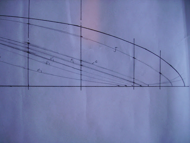

There is a third way to check the lines, this is called the diagonals, like the chekerd line on the drawing under, the two pencils show it, this diagonal also has to be as smooth as possible, still follow the pencils on the picture, this diagonal will "go out" of the drawing, this is normal:

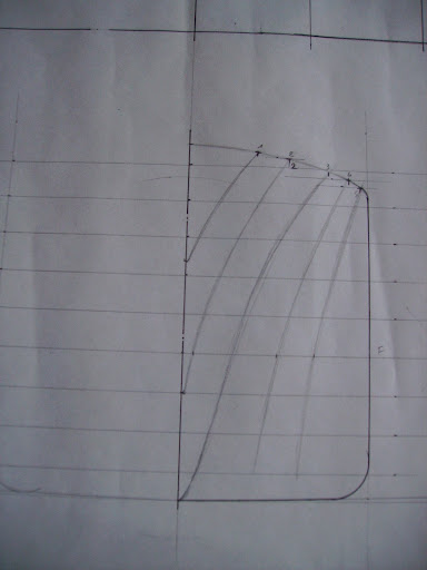

and here you come, a smooth framing plan, the after part of the ship first:
and the front part of it:

The hull in my post looks like Volta's, but it's from a miniature sister: 610t La Pomone class (I'm trying to scratch one...)
