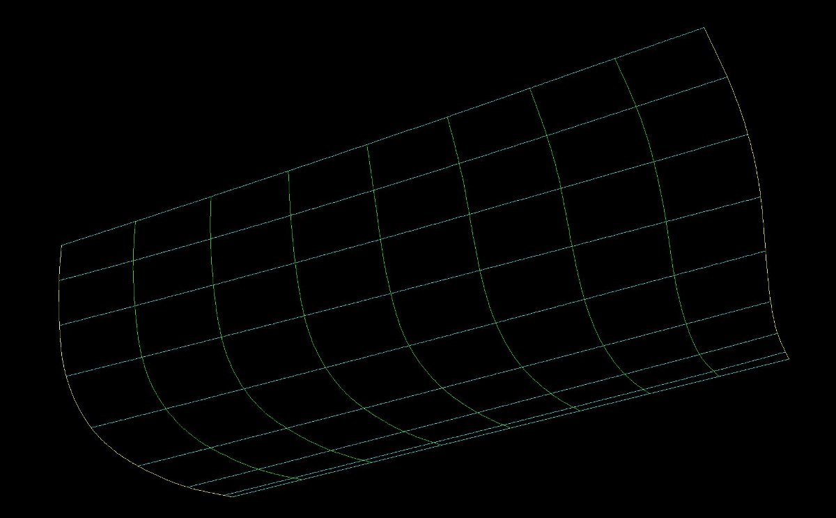

Doing an entire hull with one surface is near impossible with modern hulls, due to the amount of twist, and artificial features such as hollowed runs, skegs and bulbous bows. So, it is best to break the hull into sections. For the first section, I�m choosing to do from Station (Sta) 2 to Station 10 (midships). Note, I�m not starting at the extreme bow or stern itself. The reason being, that it allows me to have a couple of stations past each end, despite not being faired themselves, to help initiate the proper end conditions for the diagonal splines. To achieve this I have included Sta � to Sta12.
This shows a view of my Stations from below the bow. While my screenshots don�t show color very well, the ends of the surface I intend to generate are bordered by the yellow stations. As I continue, I�ll be using the �cubic spline� functions to generate my splines. The issue with cubic splines, is that unless you have a way to define the end conditions, such as using a tangency, angle, or vector with magnitude, the splines tend to flatten out at the ends. Having the extra stations ahead and behind as I generate them, assures that the splines have fully developed curvature in the work area. The flattened ends will then be trimmed off before creating the surface.

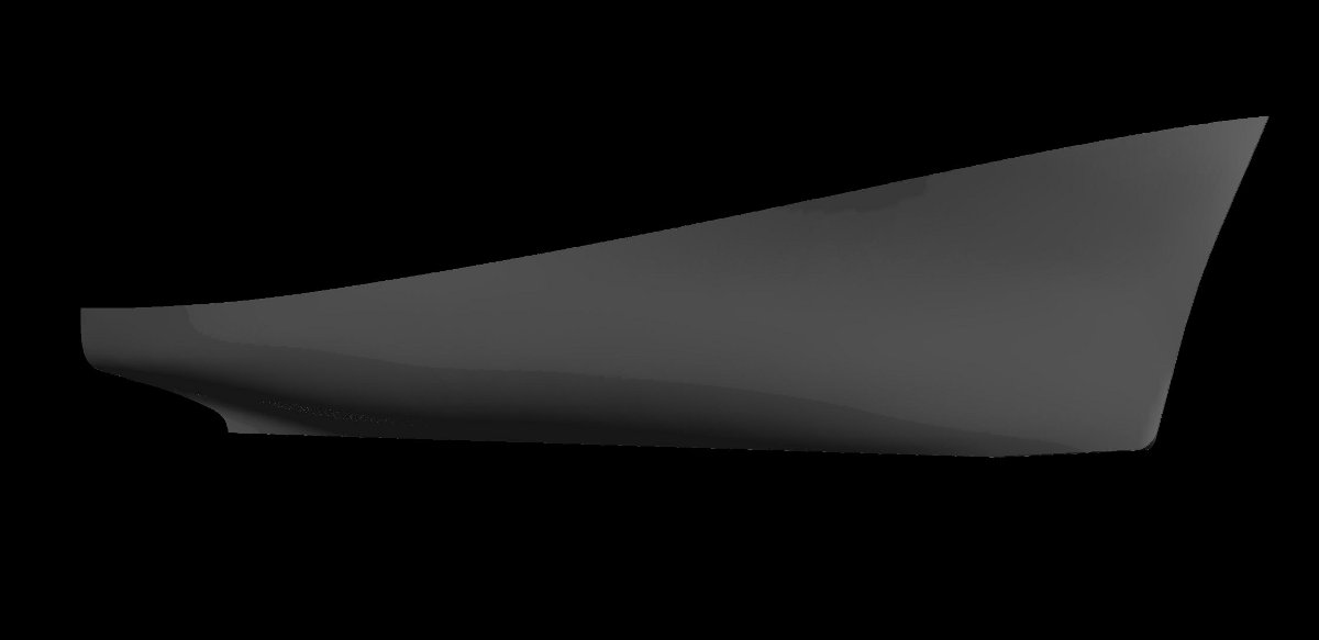

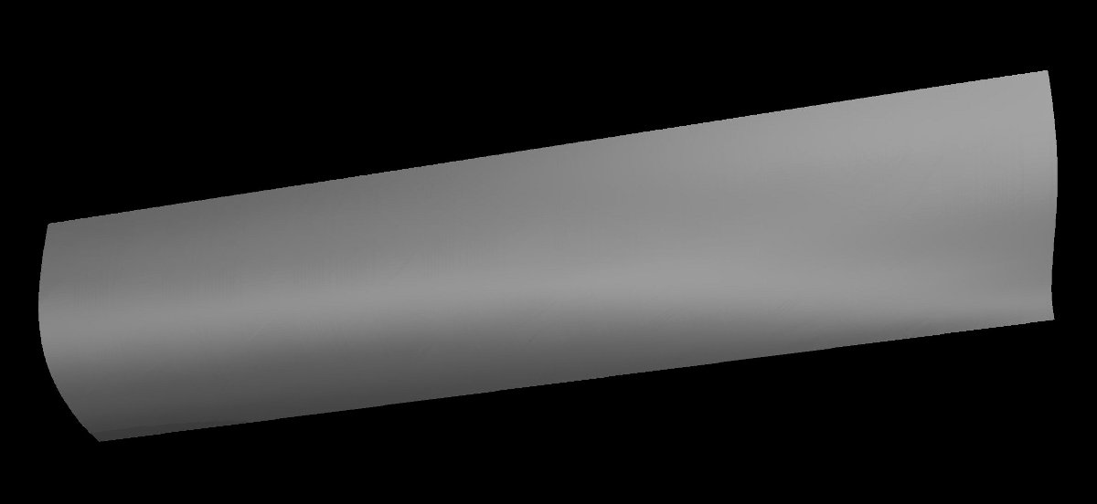

First, just as an example however, I�m going to use the existing stations to create a surface to make a point. This is a surface generated, using the �Curve Mesh Surface� function in KeyCreator (your function may be called something different depending on program) I selected the stations in sequence as my primary curves, and used waterlines as my secondary curves.
We can see from the splotchy highlights on the turn of the bilge, that things are pretty lumpy. The causes are two-fold. The first is that the stations themselves have errors, either by the offsets not being transcribed properly, or by not having been properly faired to begin with. Being off by an inch won�t show on a �� to the foot hand drawing, but will get magnified by a computer. Another cause, is by the waterlines themselves. They force panels on the aft bottom, and forward sheer to be overly large , this causes crushing, and ultimately warping, of the surface flow lines at the opposing ends.

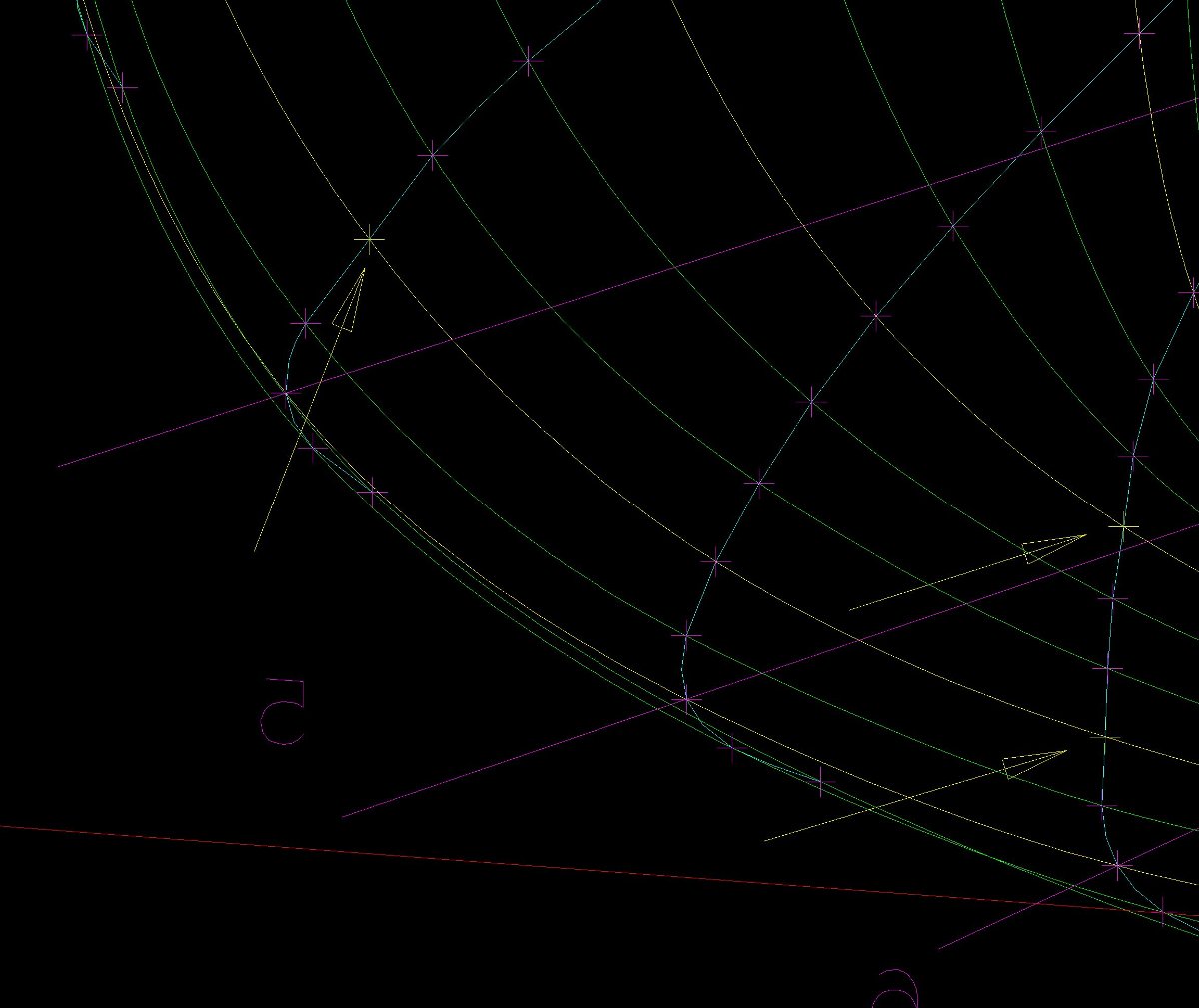

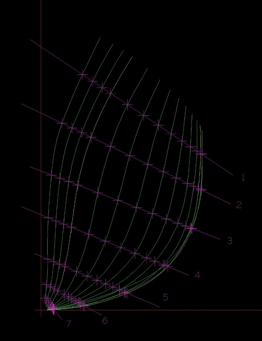

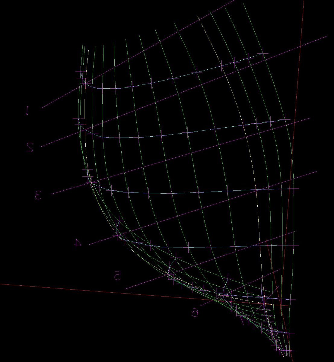

Going back to the fore-and-aft view, I�ve laid in where I intend to create my diagonals. I�ve drawn these lines on the fore-aft view, at the midships plane.
Some notes on choosing how to place your diagonals: Looking at the screenshot, you will notice that they are not evenly spaced. As a general rule of thumb, you want your diagonals more closely spaced where the hull curvature is tighter. In this case, the turn of the bilge at midships is relatively even. Thus, I want my diagonals to intersect them at relatively even intervals along their length. At the forward stations, the upper flare is relatively slack, so the spacing increases. Down low where the curve is tighter, the spacing gets a little closer.
The second thing to consider, when choosing their placement and angle, is their normalcy to the shell plating. I.E. they want to be relatively perpendicular to the stations that they pass through. Notice that diagonals 2 and 3 in the above screen shot are almost perpendicular to all the stations they pass through. This is not always possible in all cases, however, so then the trick is to choose a diagonal that sort-of averages out, such as 1 and 5. In hind sight, I should have made the inboard ends of 6 and 7 a little higher to get a better average in this area, where there is a lot of twist. Luckily, there is a little room for error in this regard, and this surface should still work out OK as we will see.
The next step is to create points on the stations, at their respective depths, where they intersect these diagonals. In my case it�s done with �create point� -�intersection�-�at depth� and then selecting second if I selected the station second, or visa-versa. And I get something like this.

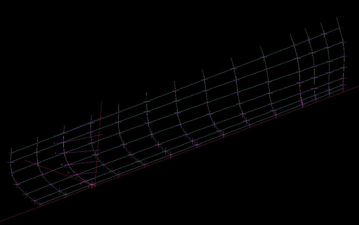

This next view shows how it all looks from the lower bow.

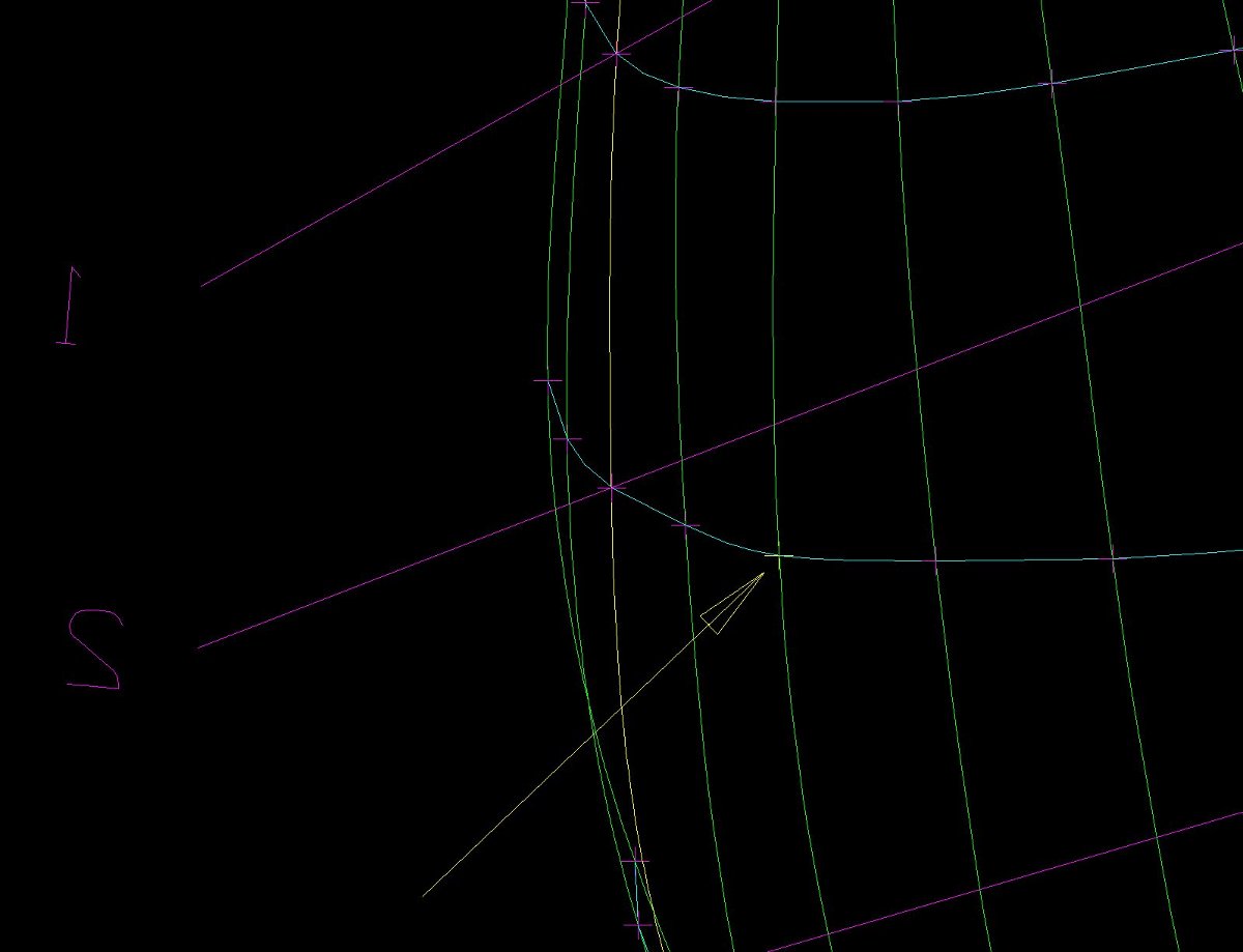

These are the points I�ll be using to generate my preliminary diagonal splines. And so now, the easy part. Using the �cubic spline� function, I connect each row of points in succession. Like so�.
Now, for the next ancient process called forshortened viewing. In times of yore (AKA my childhood) when these things were done on paper, there were no programs or algorithms to tell you if you curve was fair or not, or if it had any abnormal sudden changes in local curvature. The only way to determine this was to lay your drawing out on the board and then put your head down, temple to table, with the eye furthest away closed, and the eye closest to the table sighting down the length of the curve, This is called foreshortening. By this vantage point, any waviness sticks out like a sore thumb! In the olden days, you would do this, and then.. with your head still pressed to the droughting board, adjust your ducks, and spline, to redraw the curve.. pretty simple really.
However in the modern era: Yeah we could do this, and press our heads to the screen. But then, we look silly, and even sillier still as our hair stands on end from the static generated by our screens. (not so much with LCD screens, but you get the point). With the miracle of modern technology, We just rotate the view of our model a hair down and to the right, like thus�.

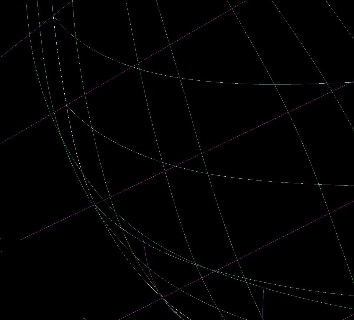

Now every thing looks OK.. But let�s take a CLOSER look.
So, I zoom in at the aft end of diagonal splines 1 and 2 and see this! Di. #1 looks OK, but there is a bump with Dia #2 at about Sta. 8. Which means Sta, 8 is off in this area. I�ve drawn an arrow to point it out. If you can see the colors, you will notice that I�ve already changed the color of this point from purple to yellow, just to remind me where the station needs to be corrected.
Now rotating the bow up a bit I can get a look at the aft end of the lower diagonals. Again here there are a few wobbles a shown by the arrows.
After marking these points in yellow, I repeat the process with all the splines: Rotating the view as needed to get a good sightline down each section, and then marking the points in yellow, so I can pick them out in the next step.
Once done, I create news splines, but this time skipping all the yellow points. The next screen shot shows a close-up of the Sta.8 Dia 2 intersection that was shown earlier. The original diagonal is shown in purple, the new one shown in blue. The difference in a forshortened view looks huge, but the truth is the difference is just less than an inch, at full scale! But that�s the difference that will give a fair surface.
Next I delete the old diagonal splines. In this particular example, it turns out that almost all of the offending points were on stations 8 and 5. so I�ve deleted them as
as well. Now we get a better view of the new splines and we can see that they look a lot smoother.

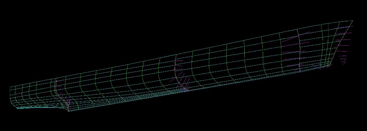

After connecting the new station points with cubic splines, I�ve cleaned up the remaining background clutter to show the final mesh we will use to generate the surface with.
Now, once again, using �Curve Mesh Surface� we make the final fair surface, selecting the stations front to aft as primary curves, and the diagonals from top to bottom as the secondarys.
Looking at the highlights, The bumps have been removed, everything transitions smoothly, and uniformly.
Using these methods I�ve gone ahead and done the other hull surfaces. For each one, I�ve left the diagonal lines in purple, so you can see the development. For example the diagonal for the last surface towards the transom, the side diagonals start out almost horizontal, and as the bottom goes through the turn of the bilge, they almost go vertical.
Back at the beginning I mentioned starting with a middle surface. The reason for this is that by doing this, I can use the ends of that surface to control the end conditions for the splines in the adjoining surface as I work forward or aft. For example: after making the mid forward surface, I then determine the diagonal positions for the adjoining aft surface. I create a plane at that aft surface diagonal, use it to create �spline� �planar slice� �surface� . As I create my diagonal splines for the aft middle surface, I can use these sliced splines of the forward surface to set the end condition for the new aft splines, by setting the end condition at �tangent� with a vector magnitude of 1.0.. This will ensure that the ends of the surfaces are tangent to each other, and prevent any bumps occurring where the surfaces join.
And so finally just to show where this all goes, I made my separate surfaces with these meshes, trimmed them up, mirrored them, and used the �stitch function to join them all into one solid hull
