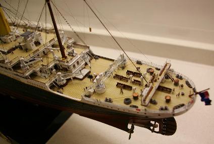

Hello friends,
I'm new in this.
I recently posted ictures of my finished Titanic model (1:350 Minicraft deluxe). It seems it will take some 5 weeks to appear in the gallery.
In any case, plse find some of my pictures and a link to where all my pictures are gathered.
http://s1274.beta.photobucket.com/user/ ... o/library/
Hope you enjoy.
Le me have all of your comments.

:welcome: to modelwarships.com !!
I am no expert on Titanic-so cannot comment on accuracy- but your model looks very nice.
....certainly you have expended vast amounts of work on the model-
-and it shows in the 'feel' of the model, sharp edges and its 'busy' !
I look forward to seeing images of her in the MW.com gallery soon!
You asked for comments...?
If I may... ? ! :cool_2:
NEVER again be tempted by the convenience of a plastic mast-- all plastic masts distort-even under relatively light loads of model rigging;...... alas your foremast certainly has.....
as a cure may I suggest.....
If the long fore and aft WT ariel was removed-- with some determination and care you may well be able to straighten the top mast-
==> -in which case if you re-make the long WT ariels--use stretched sprue ( ** ) with a smaller size spreader bar( don't us the plastic kit item--it is far too large! substitute it with a piece of scrap PE or even use thin nickel silver wire for the spreaders
(**) have a look here how I make stretched sprue and rig with it ---the loadings for your WT ariel are infinitesimal....
viewtopic.php?f=4&t=37536
enclosed some images and a link to my Mauretania
build and history
http://www.modelwarships.com/reviews/sh ... eview.html
note the WT ariel--its all sprue

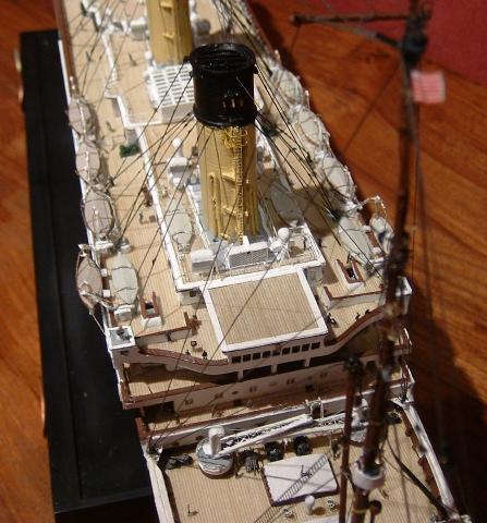

Hello Jim
Many thanks for your comments and suggestions. I have seen your models. Have no words to say. They are just splendid! I'm not that advanced.
Regarding the mast, you are absolutely right. I noted this detail too after making the pictures. Too late to touch that zone as during the rigging I broke 1 cm of the mast!!!
I have rectified the biggest part of the problem right now. I changed the original thread with a new one, more stretched, from about 5 mm from the top of the mast till the conection (at the base) of the fore stay at the bow. (cannot explain it very well in english. I hope you understand what I mean. The curve it had is hard to see now so it is slightly better. Foremast has a lot of rigging as per official plans so no way to touch that zone anymore. I have made a new picture so you can see this detail has been rectified in a certain sense.

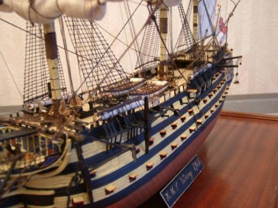

What I'm building now? Nothing for the moment. I just want to rest a bit as it has been 9 months modelling each day. My wife was not that happy but now she is as I made the model for her.
My previous model took 7 months but this was far away in 2001!!!!!!. Then I was not married! HMS Victory from Airfix.
Plse see some pictures.
What about my foremast of the Titanis? Is it a bit better?
