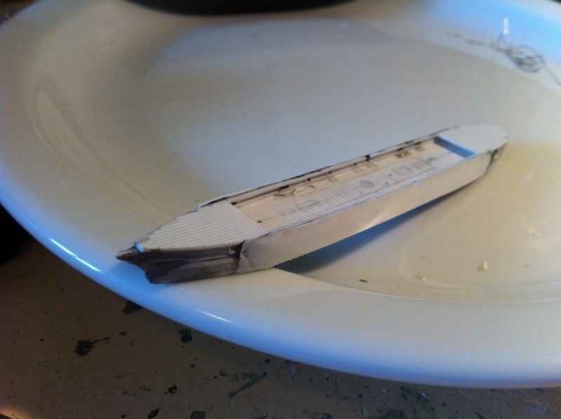

Here's some progress. I noticed that the Union did have a slight tumblehome, as did many frigates of the day, and this was completely absent. I proceeded to glue a 0,5mm layer of evergreen against the sides, after have blackened the original side with a sharpie. After drying and bonding for a night, I started carefully sanding down this added layer to create the slight tumblehome effect, using the sharpie markings beneath the evergreen to gauge depth. I have also bought silver nickel wire to use to create the carriage tracks on the deck.

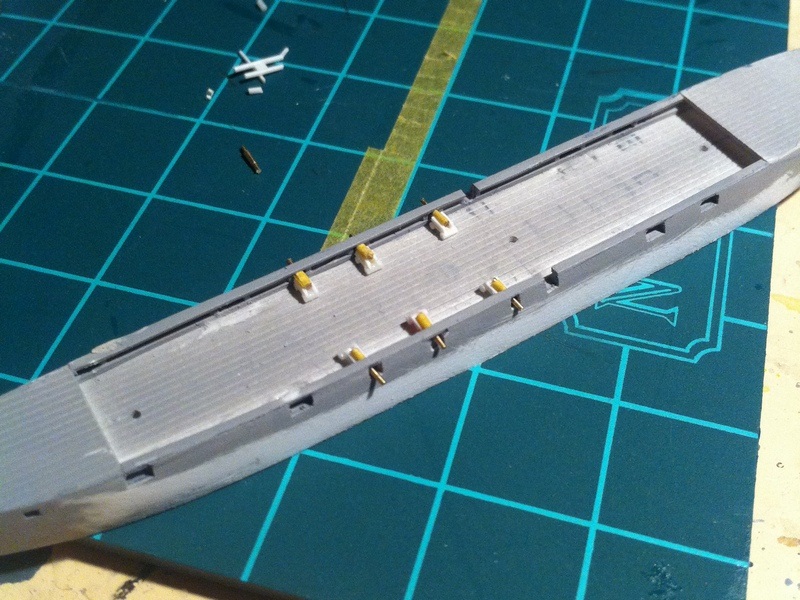

The past two weeks I've refound some of my old building mojo, so there is progress once more. I've started on the armament of this beauty, working on the 12 40pdr guns on the classical gun carriage. The thing is 5mm long, with a barrel at 4mm. They are made from 1:700 152mm british AA guns (KGV), cut off at 4mm and then giving a step with Tamiya masking tape (the yellow bits). They do the job admirably in this scale. Still somewhat experimental, I will have to make several and keep the best ones.

Do you consider it to be easier to cut the parts for the carriage to the correct size after glueing them together? I have not yet tried that, but I have always cut the parts to size before assembling them.

As for the carriages: I cut the things after glueing. Things like the protruding wheels are thin that I can't measure them to a ruler i can just place the knife at the correct distance using the Mk I Eyeball when the carriage is already together.

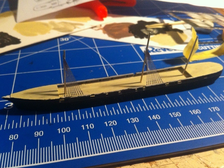

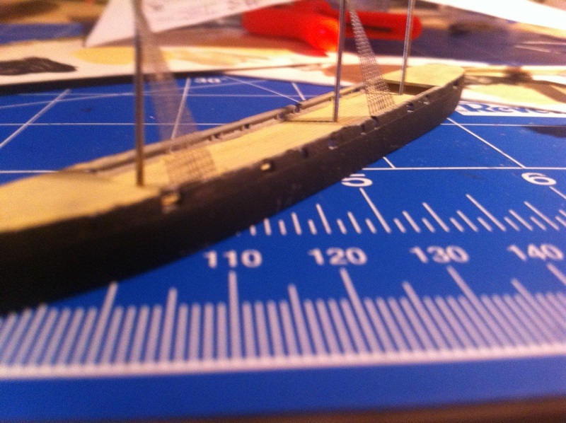

Here's some progress. I've given the deck and the hull the first layer of paint. I added the 'line' just below the gunports by masking.
The masts and the ratlines are for show, just to give an impression. I think the ratlines mounted inboard, except the mizzen's, they are mounted on the poop. On the model, that means that the pulleys (?) will end up lower and hidden behind the bullwarks. Maybe this would be a good time to make a mold?
