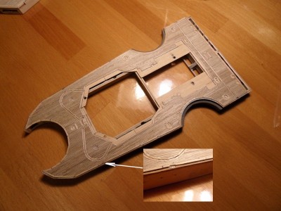

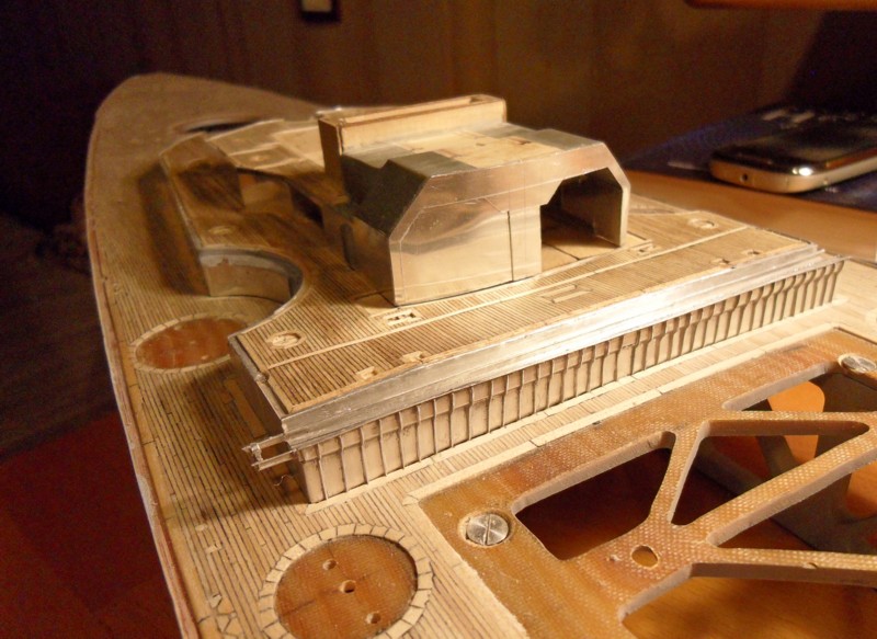

Pic.1 - It was time and time ago - when I followed the Hachette's recomendations.

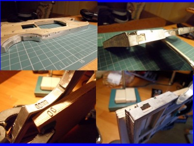

Pic.2 - Then the superstructure was modifired a little bit.

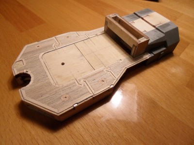

Pic.3 - The modern view of the superstructure.

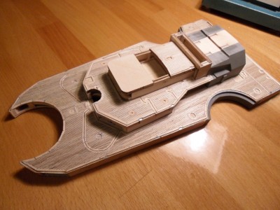

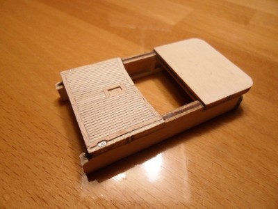

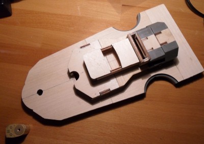

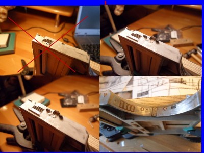

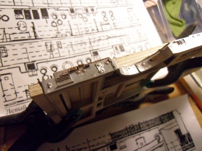

Pic.4...6 - The close views of the "floors" of the superstructure.

Anatoly:

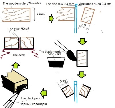

Thank you for sharing the construction technique. Looks to be a very stout build which should hold up,well over time. Could you share the method of laying the deck, are these individual pieces or scribed into the surface somehow?
Regards. Tom
Mickosh3
Posts: 95
Joined: Tue Oct 12, 2010 6:17 am
Location: The Peter, Russia
Re: 1/200 Bismarck. Part 2. The aft superstructure.
Post by Mickosh3 »
Hi, Tom!
I used separated planks for the deck and a epoxy glue. There is a picture where you can see the process. The deck's thikness is 0,75 mm after gluing and 0,5 mm after sanding.
With best regards-
Anatoly

Anatoly,
The decks look great! I especially appreciate that you are putting in the margin boards - nice detail and a lot of work.
How did you create the "tar" between the boards?
Posts: 5068
Post by Fliger747 »
Some have run a black marker along the side of the board before gluing it down. Anatoly has certainly achieved a nice effect in this scale!
T

I made a scheme how I work with wood desk (1)
Also the photo of my saw (2)
With best regards-
Anatoly
Posts: 5068
Post by Fliger747 »
Thanks Anatoly!
The use of a table type saw would be a good way to do this with precision! Not too easy to work with such small pieces!
Regards: Tom

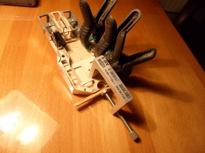

pic.1 - the side parts of the aft superstructure were covered by aluminium 0,2 mm
pic.2 - the catapult's base was formed
pic.3 shows the "aluminization" process
pic.4 - the close view of the main hangar
pic.5 - the result of my probes with lacquers- the deck is matt and sandygrey.
With best regards-
Anatoly

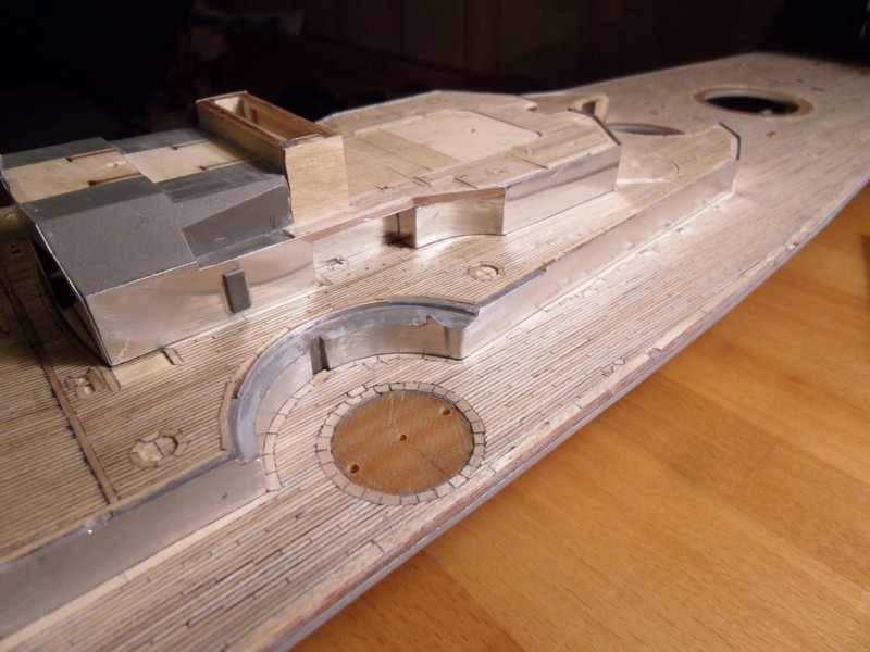

Hi, friends!
It was a long term for experiments.
I did.
I redid.
I overdid.
Now let me introduce for you some results.
Pay attention that storm lids are closed (the reference time for my model is 24.05.1941, 5:50)
With best regards,
Anatoly.
