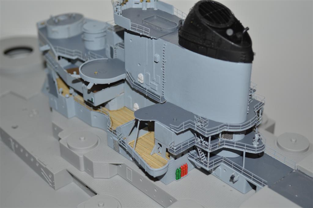

OK, here we go:
USS NEW JERSEY (BB-62) 1969 - I started this in 2012 with purchase of the Trumpeter 1945 MISSOURI (1:200). Due to the problems with the hull, I've been building this "top down" to this point, working on the superstructure which involves quite a bit of scratchbuilding for this time period of her career.
As of last weeK:
Here is a link to my build: viewtopic.php?f=59&t=154697&start=340
I'm doing a bit of detailing with ladders, railing clean-up, painting, etc. Also, adding items missing that should be in place (hatches, port holes, signal lamps). I hope to get the conning tower assembly in place this week w/all whip antennae.

I've updated my build (viewtopic.php?f=59&t=154697&p=652030#p652030) with a couple photos of the superstructure as of last night, here's one of them:
02 Level assembly comes next. My Bender props are in the mail AND positive news from RandyM regarding the hull mod he's been developing. A couple other items in the works, so things are shaping up!
