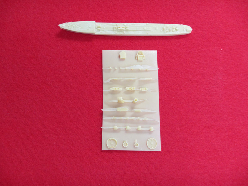

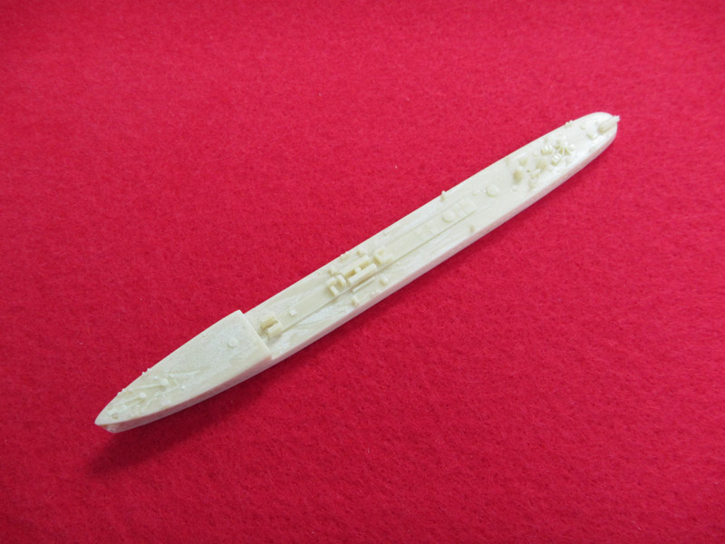

The model comes boxed with bubble wrap around each plastic bag. The hull is in one and a second bag contains all of the parts. There is a paper sheet of flags and a 3 page set of instruction drawings.
When comparing to AD Bakers� HMS Scimitar drawing both the hull shape and the deck houses are correct.
Kit Contents

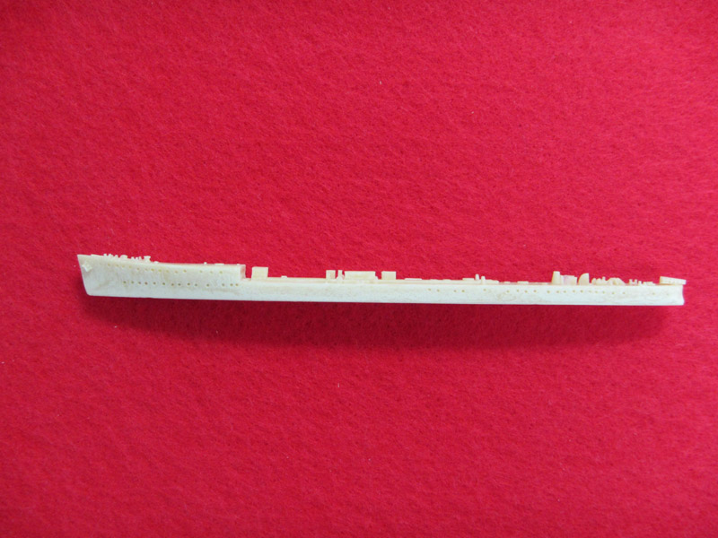

Hull View
Hull Profile View

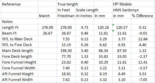

The Measurements
These are taken from the kit and from the drawing using a 0.150 mm Digital Caliper.
So from the references and the drawing of HMS Scimitar the hull is 0.3% long and the beam is spot on, call it perfect for a 1/700 kit. The W/L to deck measurements indicates the hull is too thick but placing in �water� will correct this. The funnel height should also be reduced, the profile drawing provided will allow for this.

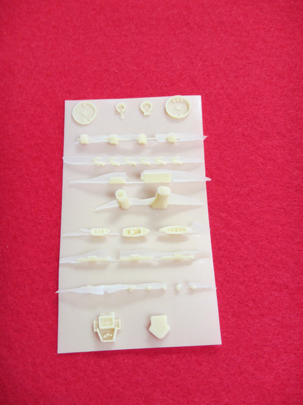

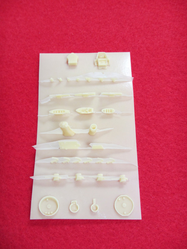

The parts come on a single wafer and it should be straight forward to clean them up. There are extra parts, just in case... and there is an instruction drawing that shows how many you will need of each part type.
Parts View From Platforms End
Parts View From Deck Houses End
The wafer has deck houses, platforms, life rafts, life boats, funnels and small parts. There are extra torpedo tubes and a 4� gun to allow for errors. There are instructions on the diameters and lengths required to make up the masts with brass wire (not provided).
