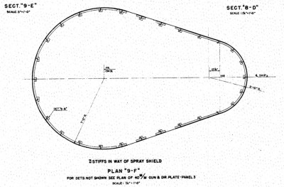

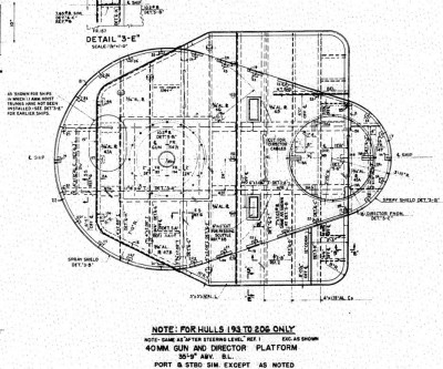

It looks like something really ugly happened in the "Take a Screen Shot" from the Bath Iron Works FLETCHER Class Engineering Drawings DVD to uploading on Photobucket to then uploading to Modelwarships ... all the dimensions went "BLUR".
I'm trying loading a small image direct. But here are the dimensions; the big radius is 7-ft (standard working circle for twin 40-mm guns was 14-ft) centered at Frame 154.5, the minor radius is 3-ft, 10-in, centered 10.5-in aft of Frame 148. Height of Bulwark is shown as 3-ft, 3-in. On FLETCHERS, the Frame spacing is 21-in.
If it helps any in "thickness", notice the stiffeners and there would be clips for ready-use ammo.

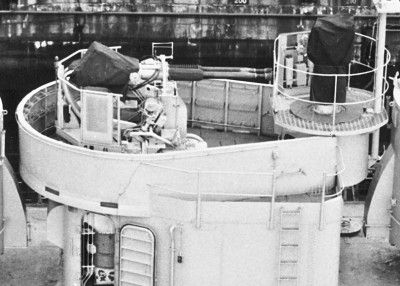

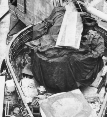

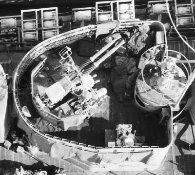

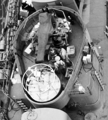

Attached are some "typical" views of the aft twin 40-mm gun mount "tub". Almost all FLETCHERS after the first dozen or so units delivered had this lowered tub with this "tear-drop" shape. The "D-shape" tub was a MINY refinement. Many of the FLETCHERS that they worked on had their tubs altered to this style. It wasn't made as a "standard", but because many of the really good yard views of FLETCHERS were taken at MINY, I think many "assume" that the D-shape was typical. However, most FLETCHERS retained the Tear-Drop shape and as I said were completed with it.
Typical views of FLETCHERS with the Tear-Drop "Tub"
As a reference, a close-up view of a D-Shaped MINY "Tub"
Below is a better drawing with dimensions visible and a close-up view of a Post-WWII FLETCHER with a Tear-Drop "Tub" showing the typical Ready-Use ammo clip stowage along the inside of the bulwark wall. Also, all these views give you an idea that the Director Platform and Pedestal varied a lot during the war. The Mk 49 director was the intended director for the 40-mm guns, but Mk-51 directors ended up being the standard.

There is a short "bulwark" around the edge of the deckhouse, where the tub doesn't overhang the small deckhouse, of about a foot in height. I don't know what the intent was for the space enclosed that way, but on quite a few FLETCHERS it was used for floater nets or stowage for other things like canvas covers. You will note that the ladder providing access to the "40-mm gun mount and "tub" goes up to that space and then rails are mounted on the bulwark around the gun to get over the "wall". I have seen some destroyers where the crew cut an opening in the bulwark where the ladder is located. Not authorized, but handy.
If you make a tub, I wouldn't worry about trying to make that short bulwark wall, unless you decide to do the complete aft deckhouse and "gun tub" together.

Bob,
There are two considerations about sizing a Tear-Drop Shaped "tub" for FLETCHER kits. What the actual dimensions were on REAL ships and how true to scale are the kit manufacture's, in this case to the mating parts. Photo Etch makers have had to deal with the kits as they are, not as they SHOULD BE.
With that in mind I have attached a cropped view of the Aft 40-mm Tub on the small deckhouse on the 01 level aft deckhouse to illustrate how it mates.
The deckhouse was built to be roughly 16-ft wide, 8-ft off-centerline. The "standard" tub didn't reach the full width of the sides. The Mare Island "D-Shape" tub followed the outside shape (walls) of the small deckhouse.
How then I'm "old-fashion" and use to dealing in "Feet and Inches" which works well with the original plans, than Metric. When I convert your widest diameter of the tub of 13.6-mm, to inches/feet from 1/350 scale I come up with 0.535-in which equals 15.62-ft. (assuming 25.4-mm to 1-inch). The
official" dimension to the "Outside" of the bulwark was a 7-ft radius which means that the actual max width should be 14-ft, which if I have done my calculations right should be 12.2-mm. My calculations could be off, but check yours also. Even if the 7-ft radius is a to the "inside" of the bulwark dimension, the wall thickness shouldn't be that thick.
The stiffeners for the bulwark are spaced according to the original drawings at "about 2-ft, 1.5-in" apart and are 3-in deep from the bulwark wall The ready-use clip holders, two of them in two rows, fit between these stiffeners. See the below images.
How then to the "what size" did the 1/350 scale FLETCHER Class Kit Makers, Tamiya and Trumpeter, make the deckhouse question. I got out my calipers and measured the deckhouses that these "Tear-Drop" tubs would fit on and they are both pretty close to true scale, being about 16.5-ft wide.
The Images I added at the bottom show; (a) a typical Tear-Drop shaped tub with the canvas covers over the ready-use clip holders, (b) a typical Tear-Drop tub without the canvas cover, (c) just for reference a D-Shaped Tub showing the clip holder arrangement was about the same. A 40-mm round clip would fit into each of these clip holders. I tried to locate a drawing of the clip holders, but can't find one. However the last image shows a couple of these holders with four 40-mm rounds in them.
