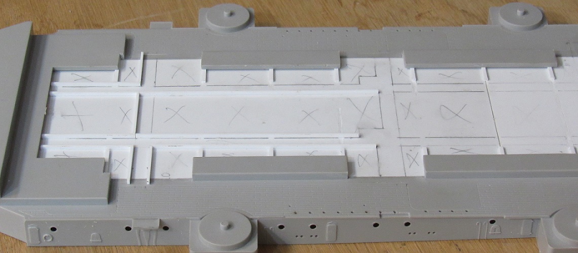

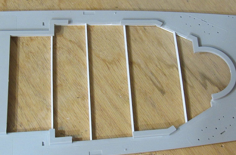

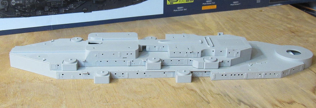

To date here is what I have gotten done.
The hull is almost complete except for attaching the rudder assemblies and
doing some filling and sanding for the hull skegs.

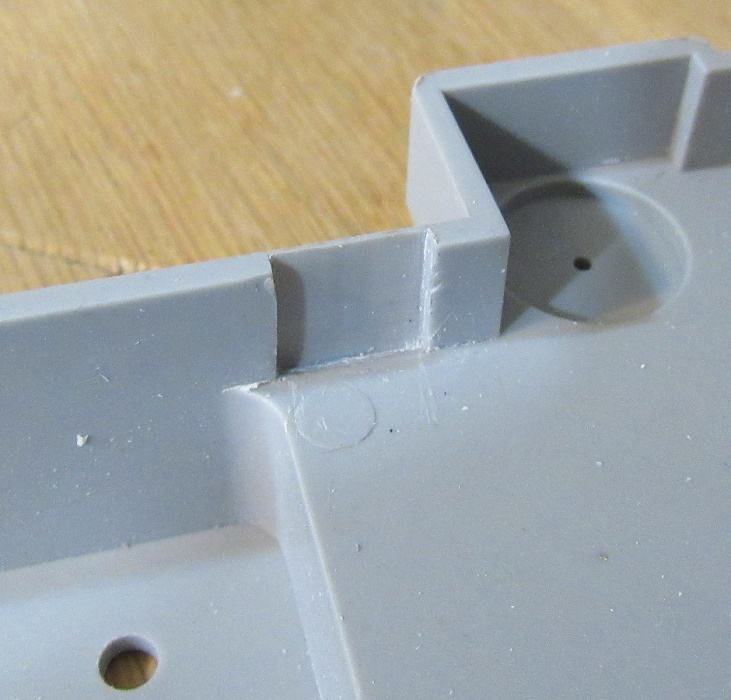

Drilled out the portholes on the pieces that have them.

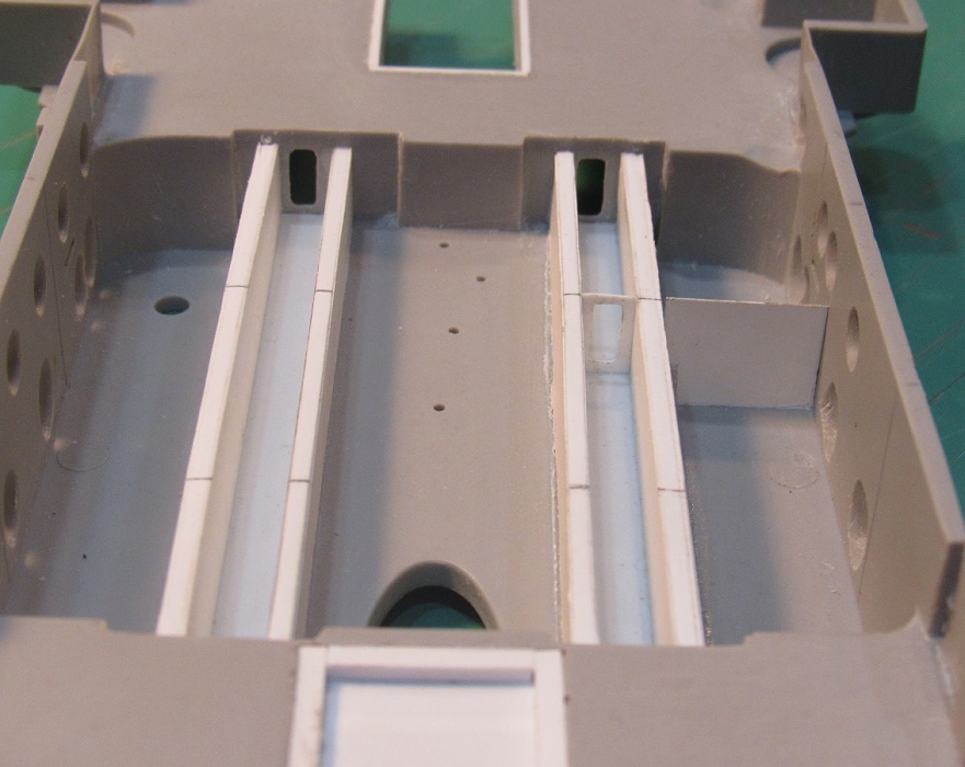

Started adding floor bracing and interior decking for where hatches will be open.
Thinned the walls for where hatches will be open. Began some passage layout with Evergreen,
sheet styrene will be glued on to form the bulkheads.
I have also started working on some of the PE
PH
PH

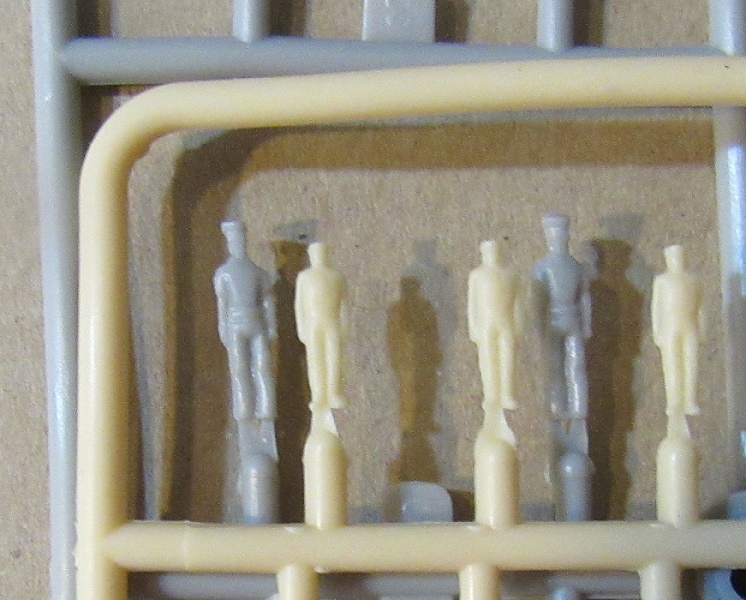

An ambitious project, good luck! Just an FYI, unless trumpeter changed their crew figures from the ones they included with the Arizona kit, then they are grossly overscale, and will look silly next to the AAA guns or any hatches. Northstar make beautiful and accurately sized crew figures that might be a better option.

Sgtryan13,
Thanks for the heads up about the figures. I dug the ones from the USS Arizona out and the Trumpeter package
ones are indeed smaller. I have attached a pic of both side by side.

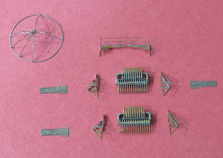

While I'm on, I did a test run of soldering together one of the 20mm. It seems there will be no way around them
being a pain in the ash-can. I am considering removing the platform on the wiring piece as it seems a little big
for the electronic site housing.
I am hoping to keep it between 2- 2 1/2 year project without many mods. Not going to go to overboard.
Mainly opening hatches with some internals, fixing some of the door locations, small additions like the braces,
those kind of small things. So thank you for the help over on the Calling all Iowa Class forum section.
Sgtryan13,

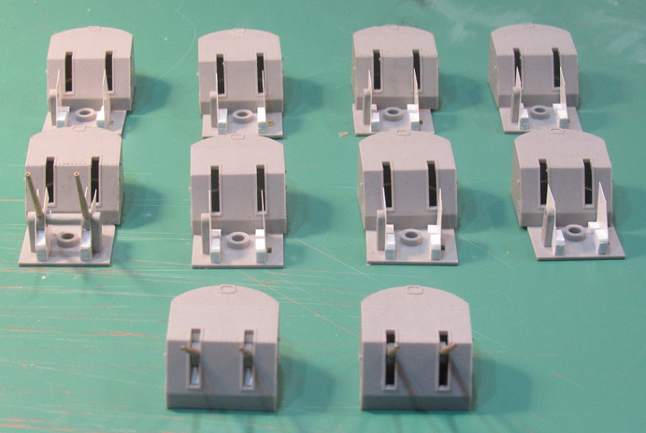

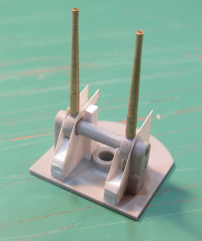

I've gotten most of the 20mm PE off the fret and removed any remnants of the attachment
points. Have soldered up half of the pedestals with their pieces. Folded half of the receivers
and started the bends for the shields.
Finished thinning all the portholes. Thinned all the walls on the 01 superstructure piece where
I am opening the hatches and started removing details on the bulkheads. Finished the Evergreen
strips that the passage way bulkheads will be attached to. Almost finished on the support braces
on the front deck piece for the floor of the main deck.
It's only a little progress, but I am happy because it is progress.
Happy Holidays!!
PH

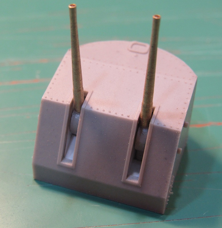

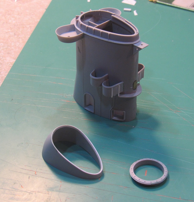

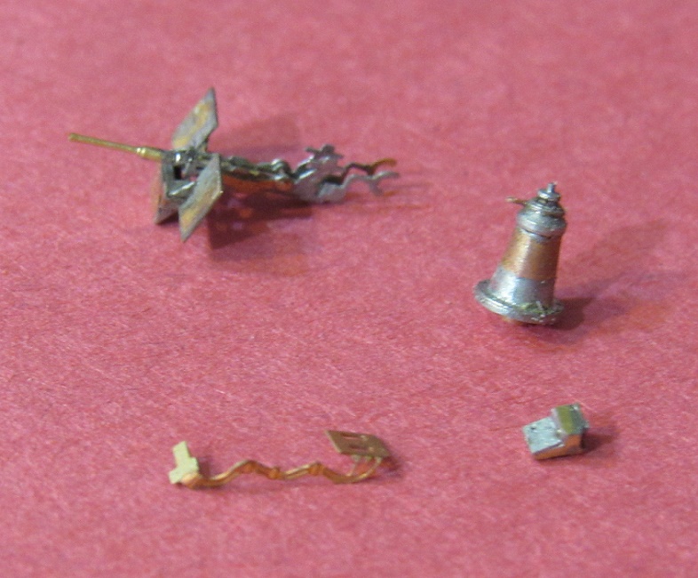

So, in the pics I have the aft funnel which I have added some boxes for the grill work, pieces at the director tubs, and
what I'm calling a rain skirt at the top.
In the foreground left the funnel dome to which I added a piece of .02 rod around the top. Sow it in a picture on Navsourse.
In the foreground right is the funnel cap. I added a disk to widen the diameter and started puttying and sanding in the slop.
Navsoures shows that the cap had a slight overhang to the funnel dome.
[img][/img]
Here I'm scratch building some items into the 5" gun mounts so they don't look so 'look inish' from the front. The right side
doesn't have the bottom angled piece as of yet. Here, just some passage openings I've made.

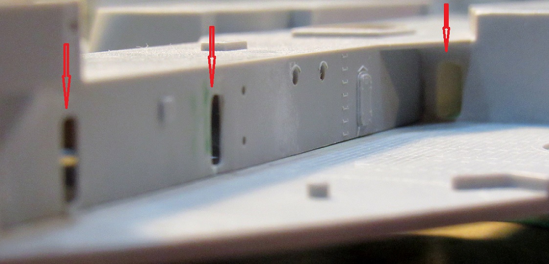

With the small amount of time I have had to model I have been working on the 5 inch gun turrets and will hopefully have
them finished with PE and painted by the end of the weekend.
In the pic below I show what I've done and how it looks next to one had I done nothing to the turret as far as the barrel openings.
The other 8 turrets are in various stages of build up.
