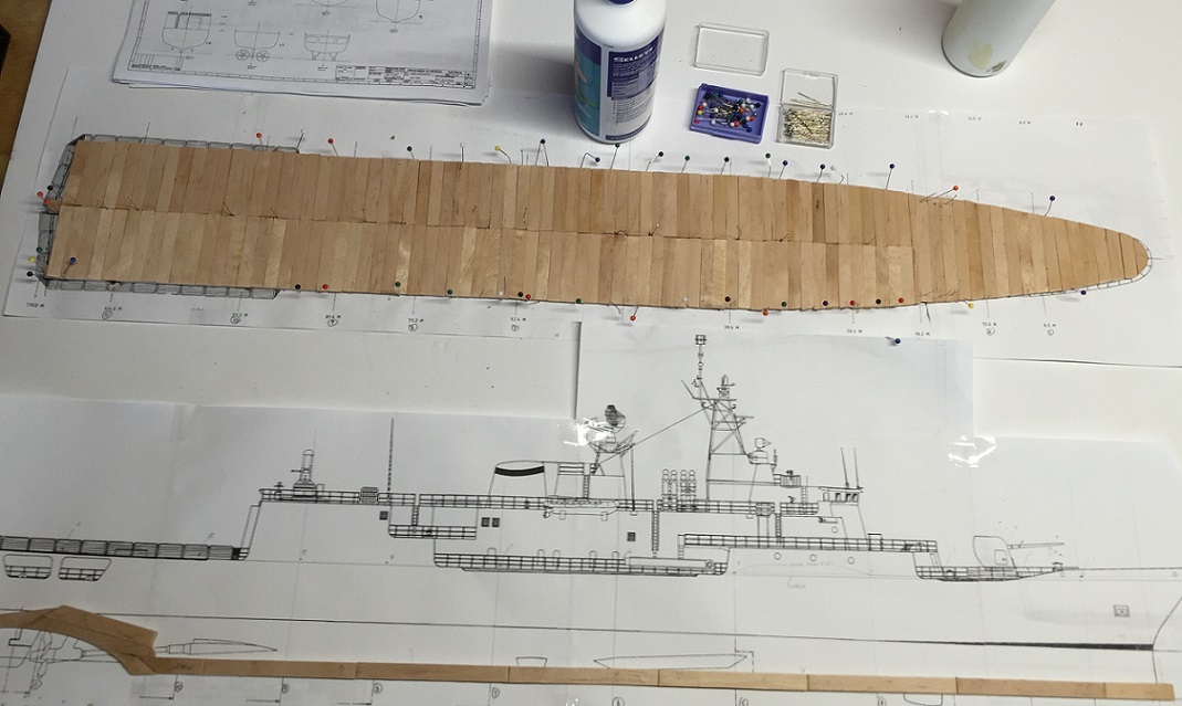

I enlarged them enough to what I thought would be easy for working with popsicle sticks. So the ship will be 86.7cm (34�) long and if my maths is right it will be a 1/136 scale model. I discovered the plans are not very symmetrical, probably due to scaling. I�ve had to redraw some hull cross-sections to ensure the ribs will be symmetrical.
I started with the keel and main deck first, as I thought they would be easier than the rib sections.
The plans show the main deck has a slight pitch, so I�ve tried to replicate this, but I have since thought that it was probably unnecessary... There is no pitch in the forecastle deck, however it does slope up towards the bow.
The keel and main deck complete:
Next are the rib sections. The plans have 11 hull cross section views. I�ve had to correct the unsymmetrical ones and make two more. I needed an extra one in the middle where the gap was much larger than the length of a popsicle stick and the stern needed its own rib section because the cross section view and the angle of the stern meant it had a greater height then the view showed. (Hope that makes sense)

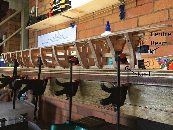

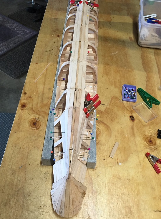

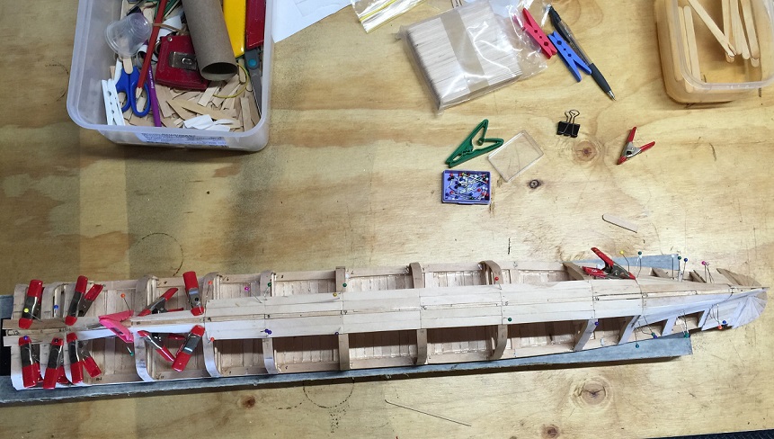

Rib Sections: Next I needed to �wrap� the sticks along the edges of the ribs so that I have the surface area to glue the cladding on later. This was going to be a new challenge for me as I would have to curve the popsicle stick onto the ribs. After some google searching I discovered that people were wetting the sticks in hot water and bending them to make bracelets, so I thought I had a good chance of bending mine. But sometimes the sticks broke and I�d have to start again. I found using nails on a board a great way to hold the pieces together until both the PVA and sticks dried. I left it there for two days.
I�ve joined the ribs, keel and main deck together. I wanted to make sure the keel did not bend or warp during the job as it is only 4mm (0.16�) thick, so I clamped it to the bench and added the ribs to it. I also included a centre radial beam for support.
I haven�t attached the bow yet, I had to give up on a couple of ideas to include it with the keel and tried adding the bow later.
Stern:

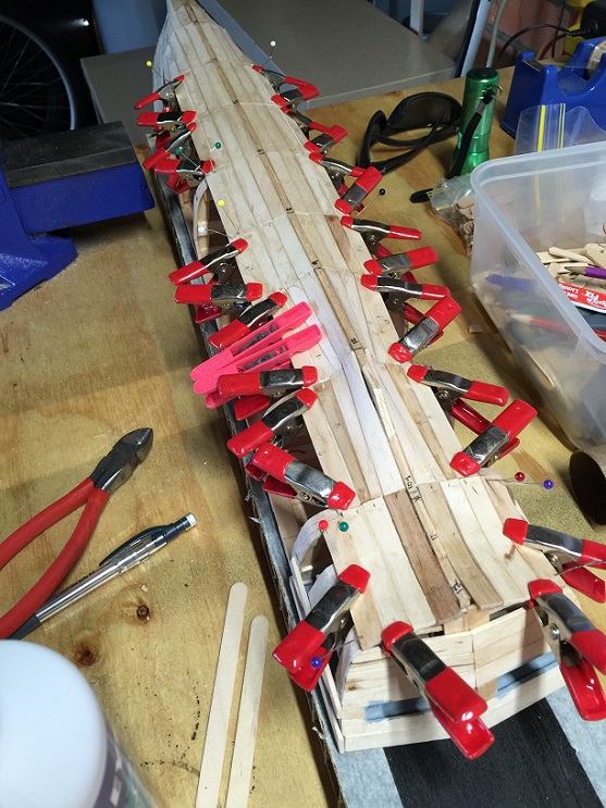

I started cladding the hull. Some sections had pronounced curves which meant I needed to soak the sticks in hot water. I discovered later that the wet popsicle sticks can swell up so much that when they have dried, I had gaps between the sticks. You can notice this particularly near the bow where I often used pins to hold each stick in place. Using pins meant I could place many sticks at a time. Near the stern, the pressure of bending the sticks was too strong to hold with pins, so I used clamps. This meant I could only do one stick per section, although this took longer they dried and shrunk back to normal size before I added the next stick and so no big gaps! :woo_hoo:
The original plans had �windows� at the stern below the main deck. I even included a deck for it. Because of the way I made the rib pieces I wasn�t able to make the proper windows. The fact that this wasn�t accurate bothered me and so I thought I�d fix it later and cut out the proper sized openings. However, now that I�m planning to use the upgraded ASMD configuration, these windows will be closed up.
The bow was quite tricky and was my second attempt. I�m surprised how it turned out.
The cladding is finished, time for putty and sanding...

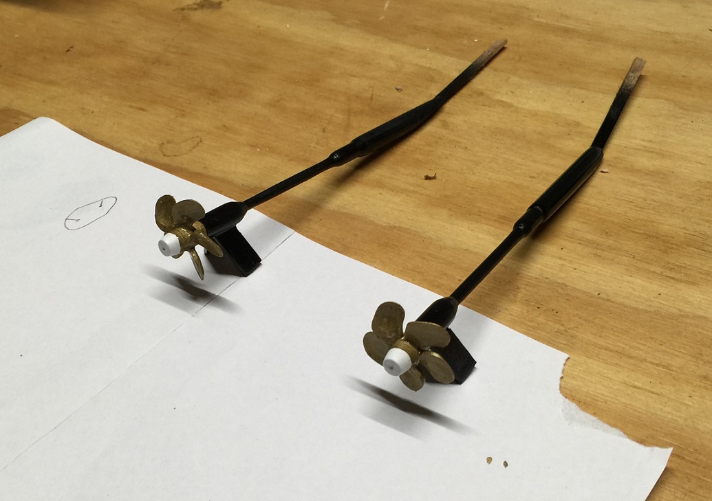

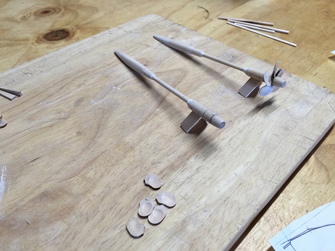

I glued the sticks together for the propeller shaft:
Then I sanded off the square edges and used a hand drill with sandpaper to round out the sticks (Thanks Song)
Oops I broke one! but the technique is working...
I also made the stabilizers, anti-submarine sonar, rudder and propeller blades:
That was quite enjoyable, I'm surprised, I didn't think I could do that... It's a great learning experience.
Next I'll add them all to the hull...

I've finished the propeller shafts and attached them to the hull. I've also added the anchors, ASW sonar, rudder and stabilizers:
HMAS Anzac's anchor bays are different to the other 7 Anzac class frigates for some reason...
I painted the propeller shafts because I wasn't sure how easy it would be to paint them once attached.

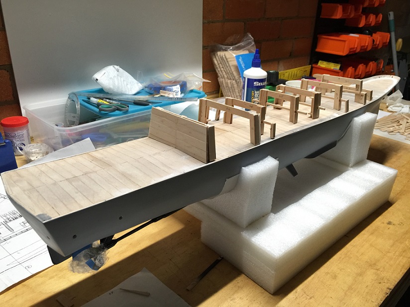

I've started on the frames for the superstructure.
Just checking how they look... I haven't glued them on yet because I want to make sure everything is nice and square
That's my next job... once I can work out how to do the bridge and the ASMD mast. I don't have plans for the mast yet as I can't find them on the internet.
