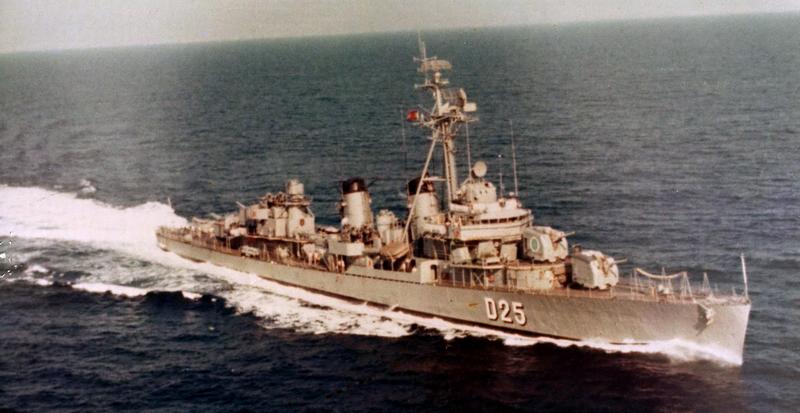

Upon her arrival to Spain she was named D25 Jorge Juan, after Captain Jorge Juan y Santacilia, eminet navigator, mathematician, astronomer and naval constructor. A fully illustrated 18th. century gentleman.
The ship was already a veteran when she arrived in our Navy, and was one of the members of the spearhead unit of our Navy, the Desron 21, that had an extremely intense service until its units were replaced by the Descubierta-class corvettes in the mid.80�s. This was her atractive outline in the mid.60�s, at the peak of her service in the Desron 21:

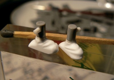

Before closing the hull it was necessary to solve the problems with water intakes, exhaust, sea chests and so on. About this there is noting at all about Jorge Juan, so i had to use the docking plans that Mr. Rick E. Davis offers in:
viewtopic.php?f=49&t=8105&start=1540
It is a plan of USS Hazelwood, but as this is again a sister ship of Jorge Juan, they can be used with some guarantees. I thought at first that these plans were somehow incomplete, but after some mail exchange with Mr. Davis to solve some doubts, I have to correct and say that just the opposite, they are the most complete set that I know. There a missing piece, the one corresponding to frames 146-166, but Mr. Davis says there is nothing at all in this area.
It is basic to notice that the plans see the ship from above, looking through the hull, so to say, what is of importance to not reverse the details in 180�. the solution is easy: to reverse the pics using a photograph program to be able to see the ship from underneath, as if we were lying on the bottom of the drydock, looking upwards. This :
Once this was done with every pic I cut and glued all the pics together in order to make a general plan:
From then on it was a kid game with very easy calculations to find and mark the exact position of every drill. Long, but very easy:
Then I made the condensers intakes, which are placed in a very specific position, problem that I solved building a kind of box inside, and completing in from outside:
As for the rest, they are all pieces of Evergreen tube in four different diameters to aproximate the scale to the different sizes of the Fletcher-class scoops. It is only to cut the pieces and refine them with sandpaper until you get a thickness that goes along with the scale, say 0.3 mm.
Everything else is very easy. Of course I made a mistake with the outside parts of the condenser intakes, and I had to repeat all the process. Double fun... :crazy: They are now like this:
With (almost) everything in place the effect is quite convincing. The contrast between grey and white is very sharp, and the pieces look like thicker than they actually are. When painted I think it will be much more realistic.
The "almost" is that I don�t know how to build the sonar dome and the depth finder. I think I will be using McDonald�s spoons, but I am not very sure yet. Anyhow, with everything I have done I can already close the hull and start the structures.

The beams can be done without further trouble using Evergreen stripes of several thickness, although I had to modify some of the profiles. It is very, very, very boring, as the pieces have to be cut with absolute precision, but the process is extremely easy.
The wind breakers were a good headache, because they are curved in shape, and in very visible position:
I was looking for a suitable profile for some time, kind of yoghourt container or alike, but without success, so I had to look for elsewhere. I realized at last that as the outboard part will be almost invisible due to the vertical part, I could make the windbreaker with an oblong section, not necessarily curved, and file and sand the inboard section until the suitable curve is achieved, what will have the side effect of very easy supports for the outdoor plates. This is what has to be done:
As it can be seen in the pics, the split between the board and the windbreaker will be covered by the kind of tubing that links both elements. It is now like this :
The supports for the bulwarks are made according to the pattern that Alan Raven offers in his superb book Fletcher-class destroyers, pag. 87. :
The vertical plates of the windbreakers are placed a bit lower than necessary. It would be very easy to have placed them higher by making the supports wider, but I made a couple of tests, and they were not very satisfactory, as it ruined the general profile of the bridge; so I had to lower it roughly 0.75 mm. so that the split could be seen without disfiguring the general outline. Once the pilot house is set in place, the general effect is very realistic as well:
And I think that with this, the bridge is ready for more intrincate detailing.
I hope you like it, and warmest regards from this side of the North Atlantic,
Willie.[/size]
