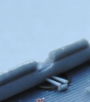

New year, new online build. Doggy Industries Triomphante was one of last years' more interesting new kits and as I have wanted to do a battleship of one of the colonial powers for a long time I have put this one to the top of the to-build pile. The kit looks really nice out of the box and as I found some very good pictures of Victorieuse in a white and buff scheme I decided to build her as her older sister.
After looking at a lot of 19th century pictures and drawings I have decided to respectfully disagree with Abdur about the shape of the poop deck and made my own version in evergreen 2020.
I also did a quick build of the bridge and funnel combination. All resin and PE parts fit very well.
I did lower the funnel as I want to put her under sail with the funnel retracted.
And the upper deck main guns were assembled. Everything is still loose in these pictures, I want to add some more detail later.
The hull was given some extra detail around the masts. All pictures I have seen of french battleships of the period show lots of heavy rope around the masts and this was made out of speaker wire.
And to round off a weekends' work I added the bases for the main deck secondary guns and sent Victorieuse away for a coat of primer.

A few things have happened over the past week. I have started to build up the masts. Even tough I am trying to use as much parts as possible from the original kit making masts out of the plastic rod included in the kit is a very bad idea as the masts will have to take rigging. So I have built them up in different thicknesses of stainless steel rod and built out and strengthened the platforms in brass rod.
And as I will be mounting her on a base shortly I have put the first layers of white paint to the hull. The masts in the picture are still not glued on and will remain so until the hull is screwed down.
