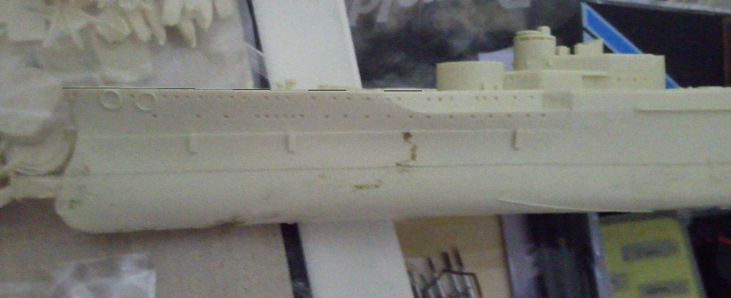

ISW has a process of molding hulls in one piece of solid resin. This, in my experience of their kits, minimizes warping and avoids the typical problems in fit between an upper and a lower hull. The hull was a magnificent casting, with excellent detail and remarkably few air holes in its base. There were no voids or casting defects in the hull.

The hull is fantastic as You said ,but seems to have a little issue which is very easy to correct (corrected mine)
The bow is slightly downwards ,all the Gin's hulls I've seen included mine has this problem,maybe 1 mm downwards on the bow
But IMHO just missed something.
