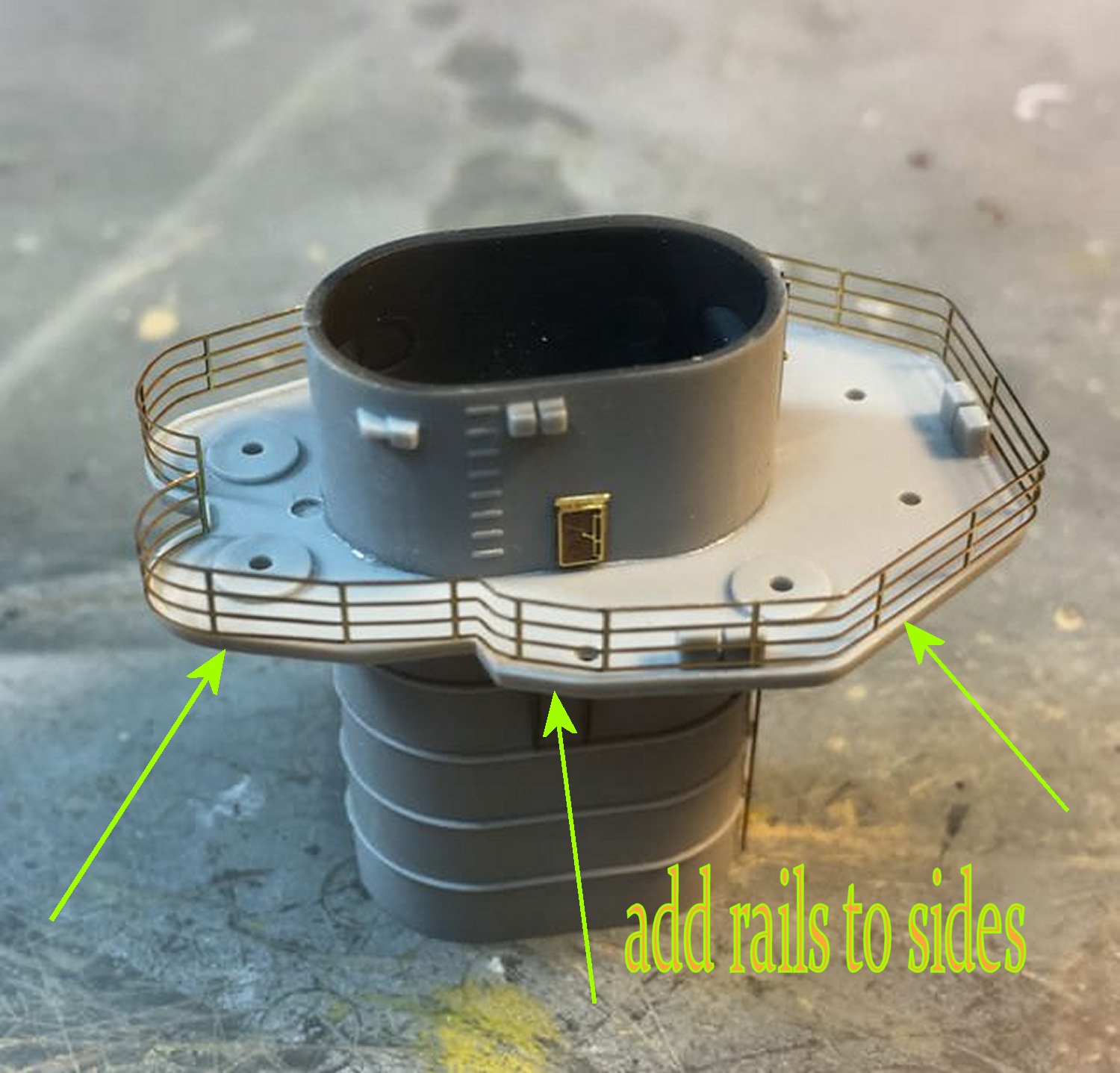

If I may add my thoughts/ advice one one aspect in particular?
here goes :cool_2:
Plastic ( and resin ) kit platform are usually far too thick to be in scale
I usually scrape and pare them thinner with a broad blade from the UNDERside-- that way any detail above is conserved ( or vice/versa )
I then always add the railing to the OUTSIDE perimeter of the platform-- that way the lower rail ( which is not present usually on a platform)
see images below
does not contribute to making the platform appear even thicker even than the kit part already is
This is particularly important for the platforms higher up the masts-- as these are very thin in real life also
in extremis - in1/700 -- I have often formed the railing to the desired shape and painted it ,
and then spanned the underside with a film of white glue ( which dries transparent :thumbs_up_1: )
and then painted the platform from UNDERNEATH--that way getting PERFECT paint demarcation between rail and platform .
To make it stronger and rigid--after painting I then apply thin CA to the underside of the dried and painted white glue film
Hope it helps
Best wishes
Jim Baumann :wave_1:
