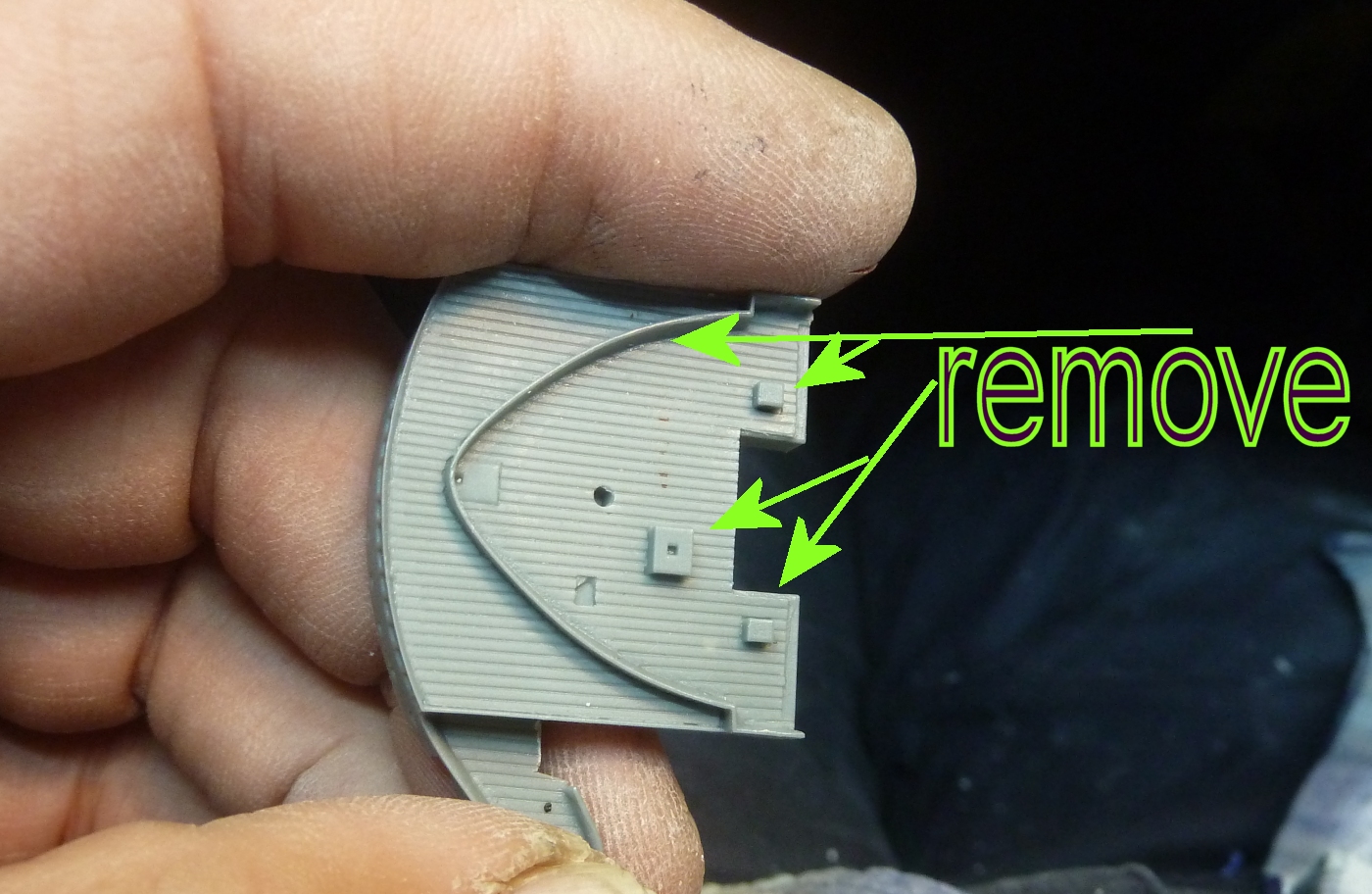

The main hull casting has had various parts removed, decks filled filled and flattened
more of that later
The typical zig-zag seating aft I removed for two-fold reasons;
1) the cast demarcation of seat-to-deck was a bit blurred in the undercut
2) and it is much easier to make a flat deck and then add the seating !

The bridge roof had its wind deflector removed to aid a clean application of my decking as per above
( after making a rubbing of the wind deflector with graphite dust on a post-it note as as a template for replicating in brass )
The aft funnel base had various vent lids which are rendered quite well on the casting
but are depicted as being on a wood deck base
I also removed the vertical bulwark wall, to be replaced in brass strip after paper-decking
but... the main elephant in the room is still ...(!)..
how to create the satisfactory application of the window overlays without rippling, buckling or damage
The quest thereto continues!
