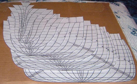

Getting rib shapes, scanned from drawings.
25 copied and cut out of paper
The wavey section as some one asked this the half breadth plan, it shows where the ribs fit along the hull.

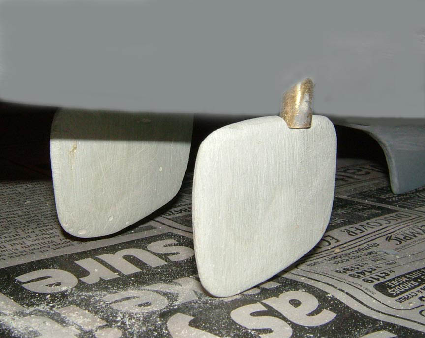

RUDDERS,

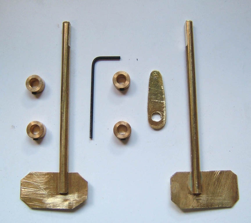

HMS IRON DUKE has 2 rudders, located behind the two inboard props, the first thing to do is put two hollow shafts in the hull in the correct position, behind the two inboard props, sticking out from the hull about 1/2 inch, but inside the hull you have to make sure they are at least 1 inch above the water line, this stops water from getting into the hull when the model is ballasted on the water, if not the water pressure is forced up the shaft and into the model, hence SINKING.
Then we cut two shafts and solder on a piece of brass plate
then make two arms and solder on two lock nuts, also cast a resin filla piece over the brass plates large enough for the rudders,
Mark and sand to shape,
With some wire bent to shape you can make the linkage arms
Then everything is put together in the boat, and you have your rudder control, which is connected to a servo when the radio is fitted, all this work has to be done at this early stage of the build,
Posted: Sat Aug 27, 2005 7:22 pm
by kennylibben
looking good.
2 quick questions. what is the gray covering your hull? just paint or a type of resin or fiberglass to thicken and stabalize it?
and
are these your radio arms to link the servo to the rudder, to turn them?
They look rather heavy and expensive. For much cheaper you can use this plastic tubing that is very flexible, its amazing what you can do with it. I have my servo behind the motors and just put a piece of this tubing connected to the servo arm and then to the rudder shaft, through a piece of wood to stabilize and it works great. But i guess you dont have to worry about your weight and how much room you have. if you want to know what it is i can find out.

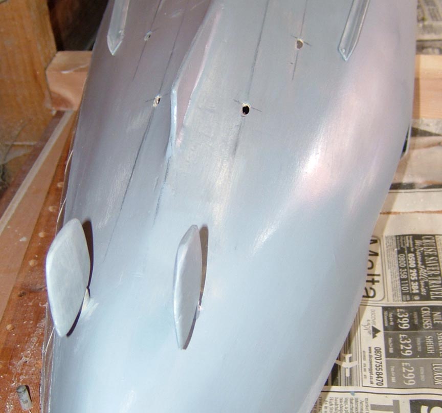

Hi Guys, We will continue with the hull, after fitting the rudders we now have to fit the 4 prop shafts, lining them up and marking out on the hull, we drill our first 4 holes in the hull, the 2 inboard shafts are lined up with the rudders,
The holes are then elongated so the shaft passes though the angle of the hull.
We have three fitted, you can see the tools I use, a round file and an exactor saw, you can also see the 14 inch long shaft you need for this type of model,
now the fourth
We now fit the bracing sections to the prop, and attach it to the hull, this prevents any vibration in the ends of the shafts when the screws are turning.
2 shots of the hull with its red primer and hull colour, as of 1916, Battle of Jutland.
enjoy, ARH :woo_hoo: :woo_hoo:

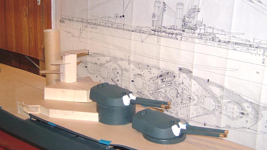

Start of Superstructure. First off I purchased 2 sheets of 1/64. ply 4ft x 1ft, this was cut to shape and fitted to both decks, this is the starting place for planking the decks, but it has to be cut and shaped around the access openings.
I also purchased 2 sheets of balsa wood 1mtr x 100mm x 2mm this will form part of the superstructure, I measured the height of the boat deck and cut my timbers and glued them in position around the opening, not forgetting to leave a packing piece in place so there will be room left to be able to remove this deck for access.
I then cut more balsa for struts to strengthen the deck.
Deck in position, taped down till glue has set, the balsa will have a covering over it later, either in thin ply or plastic card.
Bow view
Stern view, with three turrets placed in position for effect.
enjoy, ARH :wave_1: :wave_1:

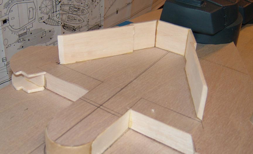

Posted: Sat Sep 17, 2005 5:35 pm
by ARH
Continuation of the superstructure.
The first piece I cut today was a strengthening piece for under the deck, to lock everything together.
Section fitted, note the pins to give it strength.
The right way up, moved from opening.
Top , bottom and back of gun housing.
Second gun housing fitted to superstructure.
Deck cut and fitted.
The next level marked out and first sections glued in place.
The section complete.
Completed surround section with funnel in place for effect. All this balsa wood will have a covering over it for the finished paint work, also water tight doors and port holes.
enjoy ARH

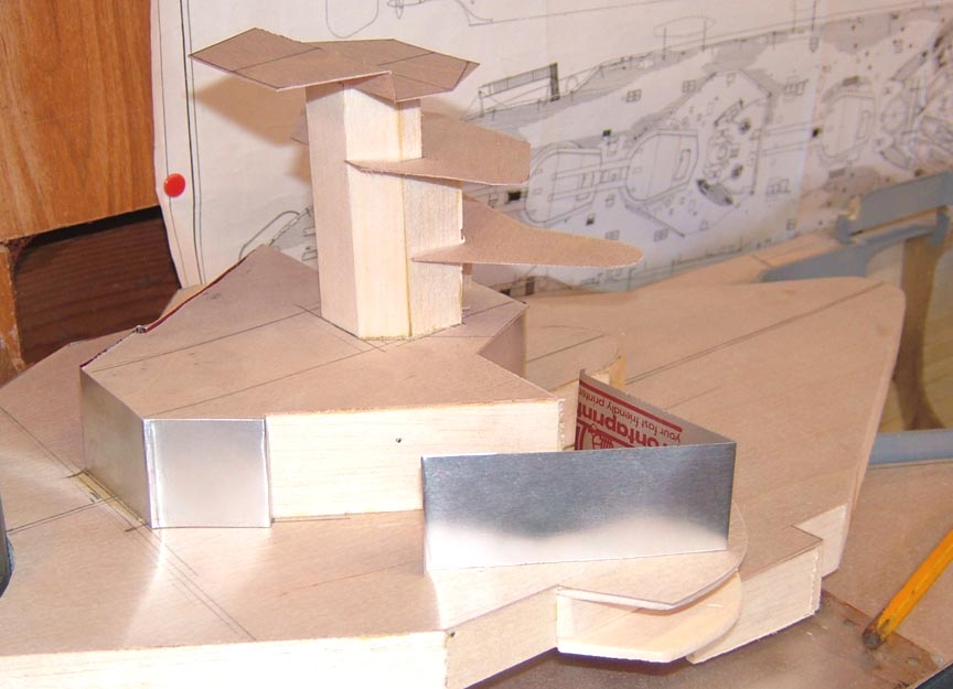

Posted: Mon Sep 19, 2005 5:20 pm
by ARH
Well Guys, just a little bit more today, we continue on the superstructure, I have put in the floor for the main tower, strengthened it underneath because of the weight when everything is assembled,
Main tower
This is the first platform, just placed in position.
The second platform.
Third platform this one has a stepped section.
All the platforms will have angled strengthening sections built underneath.
Long shot of whole superstructure, this is only the starting point, there is a lot of covering up to do, portholes, door, ladders, handrails, dodgers, lights, and paintwork. :woo_hoo:
enjoy, ARH

I had an hour and a half of building to day, I have now started to cover the superstructure with LITHO PLATE, I spoke about this material before, it is a soft aluminium plate that is waste product in the printing industry, it very easy to cut and bend, I glue it on with Evostic contact adhesive.
As you can see, you can get sharp edges and sweeping curves very easily, the piece from the sanding block to the gun implacement is all in one piece.
