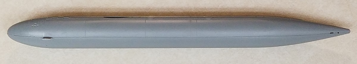

In the meantime, I've sanded the hull seams and painted them over with Light Ghost Gray to reveal defects. I'll repeat the process of sanding and painting until I get the appearance I'm looking for. Here's some photos:
The seams aren't too apparent right now, but with light at a certain angle, they show up.
I'll also have to re-do some of the hull section lines, once the seams are cleaned up.

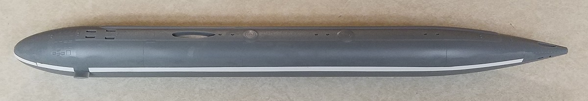

I�ve been sidetracked with several other projects, but decided to try to make some progress on this one so I can finish it up. Since I am more or less building it out of the box, it shouldn�t be as difficult to complete as the other builds I�ve posted threads on here. Here�s some photos of the latest progress.
I've painted the upper half of the model with a  mix of acrylic flat black and flat blue.  I'm hoping to capture the slight bluish tint actual submarines exhibit in daylight.
Next, I'll paint a homemade mixture of flat black and flat red from the waterline to approximately the mid-hull.  If you look at photos of the ships in new construction, you'll see this area has a reddish tint because of anti-marine fouling paint.
