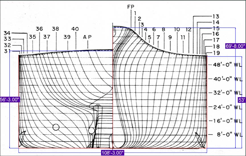

Hull
Step 1
I'm using the Body Plan (Station Lines) found in Paul Stillwell's book, 'Battleship New Jersey', pg. 295.
I scanned the drawing into Photoshop, which allowed me to size independently horizontally and vertically to account for paper stretching during printing. Also, I corrected for angle of rotation so that the baseline is zero degrees. With adjustments made, the Fore, Aft and Midship deck heights were on the mark, as was the Hull width.
The deck heights, as well as other key dimensions, are found on the General Dimensions chart included in the Booklet of Plans for the several Iowa Class ships retrievable online.
Step2
Once the Deck heights and Hull width were established in Step 1, I added the horizontal Waterlines (red) every four feet from bottom to top by using the software's Offset Tool for accuracy - the printed drawing's Waterline 48-inch separations vary, noticeable in the drawing below.
The Body Plan's dotted line indicates the height of the main deck, and the dotted line is what I used to create the deck heights above. The bottom Green line (below), using the software's Spline tool, is the Main Deck tracing, the top Green line is the height of the Side Plates that extend above the Main Deck. I settled on a 7-inch height for the Side Plate extension above the Main Deck - this doesn't include the 2-1/2 inch round that sits atop (or partly buried into) the 7-inch extension.
Step 3
Again, using the software's Spline Tool, I traced the drawings Station Lines (Green), sparingly using Control Points by snapping to the center of Station Lines where they crossed the accurate Red Waterlines. On a few of the sharper curves, I did click on intermediary spots between the Red Waterlines to create the correct curves.
At the far edges of the Beam Width, the drawing's (mostly) vertical lines amidship blurred together, so I did have to estimate distance ratios in that area. I'll see how that works when I join Station Lines with a skin in 3D using the Loft Tool. I think it'll work well.
Question 1: Station Lines 20 through 30 are not shown on the drawing below. Might this be because the Hull in these locations is full width and 90 degrees vertical?

I'll add though, that the 'gold lines' that you're asking about, are for the "Docking keel". That seems to be left out of most 'reproduction's' as well as discussions.

The short keg at the forward end of the aft tunnel is to support the weight of turret three as the hull girder begins to thin here, despite the huge appearance of the after deck. Particularly helpful, structurally, when dry docked. Consulting one of the available centerline profiles shows this relationship.
Some people on the forum have rather extensively researched the Iowa's hull shape, "Big Jim Blade" comes to mind. For those of us doing traditional hull construction methods, our transpositions are perhaps not precise enough to realize the possible increase in significant figures. Using almost any of the available drawings one will be much more accurate than the plastic kits on the market.
