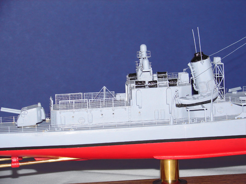

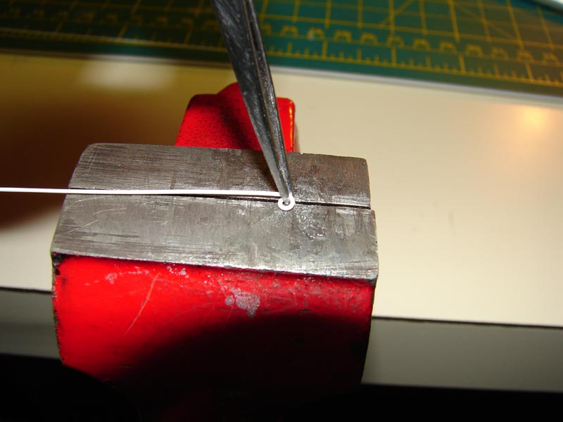

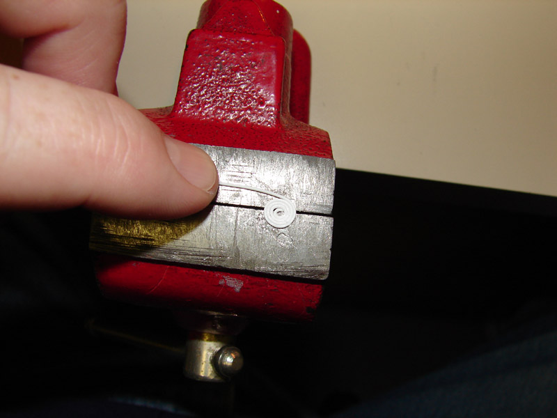

When I was building my USS Zellars, I made my fire hoses from .04 -.06 round styrene. I have some photos showing my development. My hoses were coiled up not placed over a rack. As I coilded them I used super glue to keep them together. I placed them on the superstructure. Hopefully this may give you some ideas.

Hoses on superstructure
start coiling
start coiling
coiled hose
coiled hose
