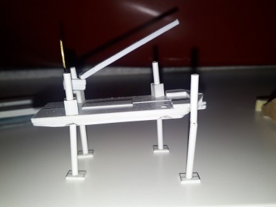

I haven't done much actual work on it, but I did some testing. I built a small prototype/mock up of the vessel, testing some engineering solutions to get it in the bottle. I also did cut the bottom off a wine bottle for testing. The latter wasn't such a smart idea, since the actual bottle was a coffee liquor bottle, with a shorter neck and steeper curve. The wine bottle gave some head-aches, while a short trial in the actual bottle made life a lot easier.
Basic concept is to make a sea floor of acrylic-sand mixture which I've been using for the dredging vessels in the past.
Then mount the vessel in jacked-up condition on top (and glue it to the sand to avoid it shifting and/or floating later on)
Pour a transparent blue epoxy layer for the water, so you should be able to see the feet standing on the bottom.
Technical solutions for getting it in the bottle, are hinged legs, with the hull sliding over the hinges as a sleeve to straighten them out inside the bottle.
The hull will also be split in 2 parts longitudinally to fit through the bottleneck. So I'll need assemble the parts inside the bottle (hence the testing inside the wine bottle). Additionally I wanted to have the crane in a higher position, not parked on top of the bridge, so I'll be adding the crane (around the portside aft leg, when the hull is inside the bottle). And last but not least, the accomodation, with a helo platform that sticks out even more, will have to go in separately and be turned 90� inside the bottle to be mounted on the hull.
Some of the seams I will (try to) hide under deck equipment, others will probably remain as they are, pre-assembly out of the bottle will need to minimize the visibility of those seams.
For the split I've decided to split it with angled parts forward and aft, so it's self centering, additionally I'll be mounting 2 pins to make it fit.

So, drying mud in a bottle is not a brilliant idea (but necessary nonetheless). If you leave it, it might take 1 year I guess. However, putting it on the heater and then purging it with compressed air, does speed up things a lot. The secret appeared to be a longer purging time, untill all droplets have gone from the top of the bottle. Then leave it again for a while, then purge again. Bottom layer is now nearly dry, I will add more when it's dry, since the complete bottom isn't covered yet.
During this time I've started on the actual model.
The original design of the legs that I had in mind was simply a hinged one. I would then drill a hole and add a small pin above the deck level, which would prevent the leg from falling down during bottling and it would also act as a mechanical stop when the ship was pulled down over the hinges inside the bottle.
The pin would have a very minimal clearance since it would be inside the leg casings standing on deck. You can see the leg casings dry fitted on deck for a dimensional check here. I will eventually use those casings on the final hull.
Old leg design with the prototype
I now made a new leg design by turning part of the leg to a smaller diameter and drilling the same diameter hole in the hull. This automatically prevents the legs from falling out and also creates a mechanical safety for dropping down inside the bottle, as the smaller hole would sit on the larger diameter part of the leg just below the hinge. When slid up, the smaller diameter will not be visible, since it would sit inside those leg casings on deck.
New leg design with reduced diameter near the hinge.
Furthermore the hull shape created some difficulty, as the bow has a rather sharp angle in it, much like a sponson. I decided to create a continuous bow and then add the top part of the bow like a sponson (but a tiny one at that).
I also changed the split of the hull from the original. It now contains the bow and stern section on one side. Slanted sides along with the centering pins create a good centering effect for mounting. Also on deck the slanted sides are not continued and the split is made straight. This creates a vertical edge to align the hull halves inside the bottle. The slant also allows for an easier bow and stern construction.
The vessel has a rather odd Voight-Schneider propulsion consisting of 3 propulsion units. The center one is mounted on the slanted part.

I only see the above as extra features and I won't try to apply them to the model if bottling was succesful and tests weren't.
