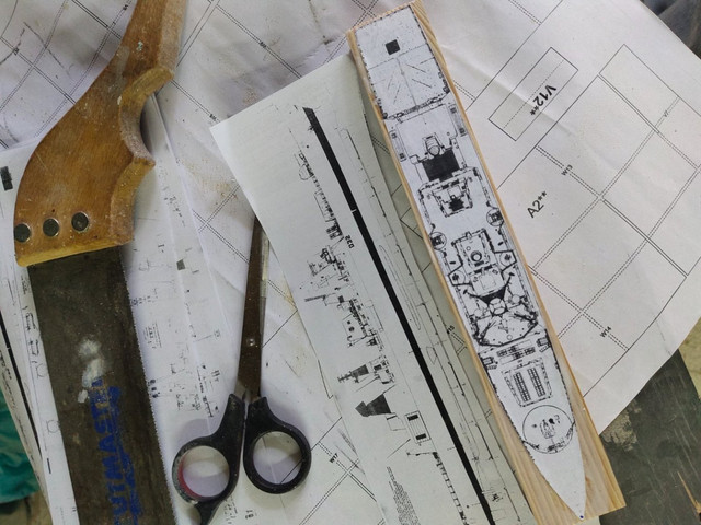

I made the hull. It looked clumsy and wide. I had to remeasure to get the proper dimensions.
Excess "fat" was trimmed down and it was shortened by 3 cm. After more careful work I shaped the sides and upon finish wood was polished.

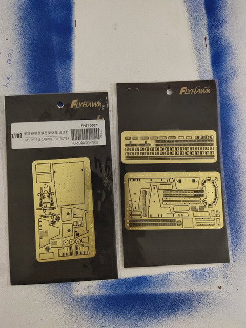

Then, I add the PE heli deck on rear and a 2.5 mm piece of resin on bow to shape the forecastle.Finally priming and sanding the bow, stern and the sides, several times.

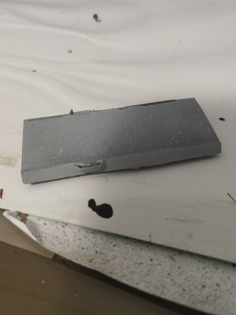

Next was to print the central area between the hangar and the bridge where funnels and towers will placed upon.However because of warping problems that I couldn't solve after many attempts, I removed it and replaced it with plywood wrapped with plastic fillets for a smoother finish. This handwork took me 2 hours instead of 2 wasted evenings, what a bitter lesson.

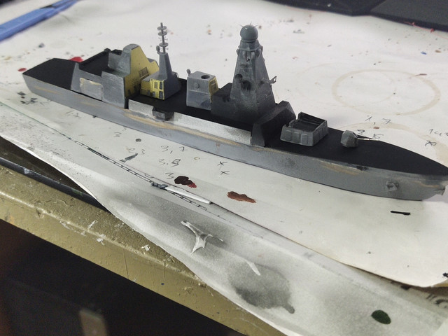

Next was the hangar. I printed the right half and made some adjustment to fit the PE externally. I made them in separate pieces so I can scratch built the interior more easily them glue them together. Like in Horizon class because of the side compartments for inflatable storage, the heli hangar is somewhat narrow.
mikegr
Posts: 250
Re: 1/700 Daring Class Destroyer
Post by mikegr »
More pieces were printed. Some PE parts added while working with test fitting
mikegr
Posts: 250
Post by mikegr »
Progress continued. The final display with Horizon Class. And a resin base
